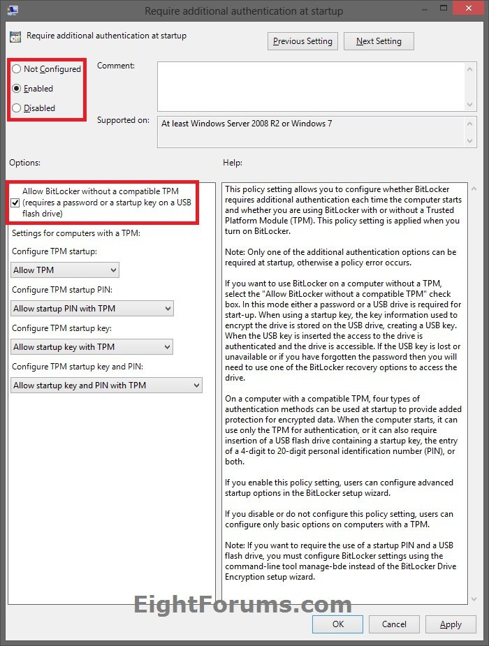

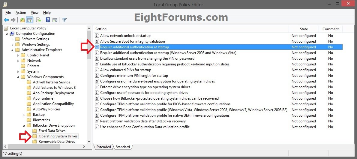

4. Use Group Policy to Allow BitLocker to Encrypt OS Drive without a TPM
NOTE: This does the same thing as step 2 above.
A) Press the :winkey: + R keys to open the Run dialog, type gpedit.msc, and press Enter.
B) If prompted by UAC, click/tap on Yes.
C) In the left pane of Group Policy, click/tap on to expand Computer Configuration, Administrative Templates, Windows Components, BitLocker Drive Encryption, and Operating System Drives. (see screenshot below)
D) In the right pane of Operating System Drives, double click/tap on Require additional authentification at startup to edit it. (see screenshot above)
E) Select (dot) Enabled, check the Allow Bitlocker without a compatible TPM box, and click/tap on OK. (see screenshot below)
F) Close Group Policy, and go to step 6 below to continue.

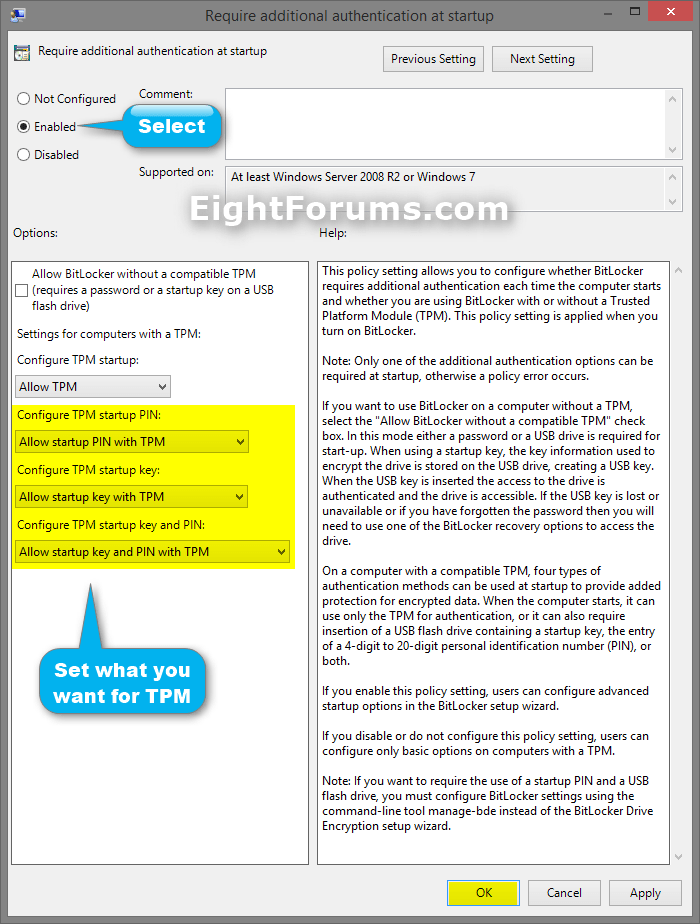

5. Use Group Policy to Require Additional Authentication at Startup with a TPM
NOTE: This does the same thing as step 3 above, but allows you to have more options.
C) In the left pane of Group Policy, click/tap on to expand Computer Configuration, Administrative Templates, Windows Components, BitLocker Drive Encryption, and Operating System Drives. (see screenshot below step 4C)
E) Select (dot) Enabled, uncheck the Allow Bitlocker without a compatible TPM box, and click/tap on OK. (see screenshot below)

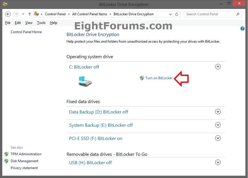

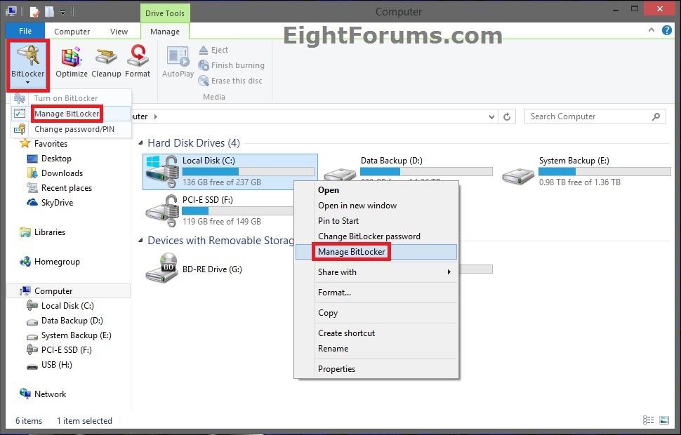

8. Open the Control Panel (icons view), click/tap on BitLocker Drive Encryption icon. Under Operating system drive, click/tap on an arrow to expand the Windows 8 drive you want to encrypt, click/tap on the Turn on BitLocker link, and go to step 11 below. (see screenshot below)

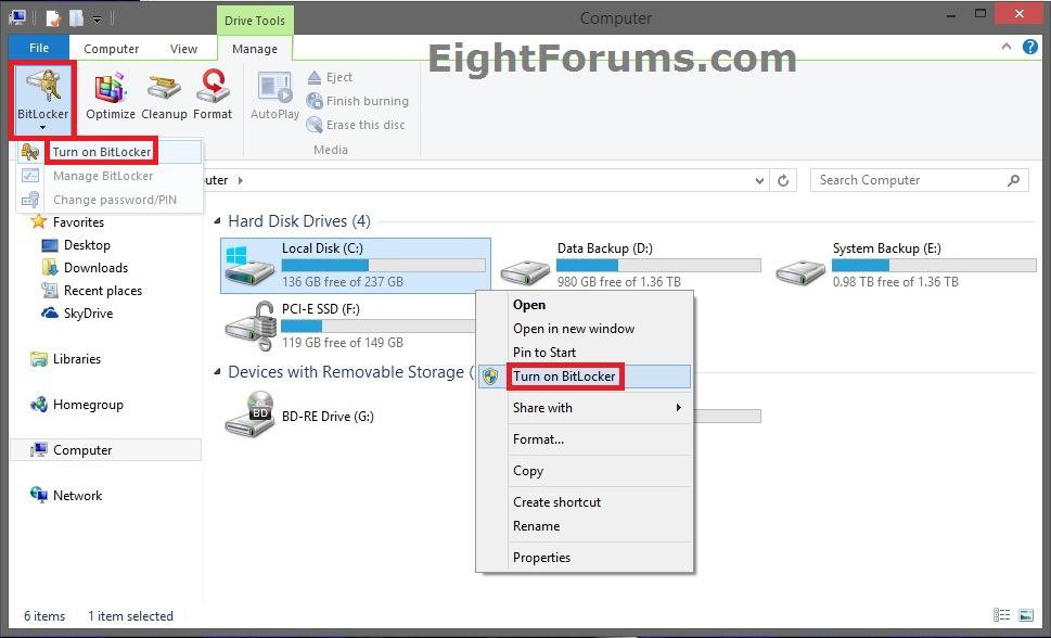

9. In File Explorer, open Computer/This PC, right click or press and hold on the encrypted Windows 8 drive you want to encrypt, click/tap on Turn on BitLocker, and go to step 11 below. (see screenshot below step 10)
10. In File Explorer, open Computer/This PC, select (highlight) the encrypted Windows 8 drive you want to encrypt, click/tap on Manage (Drive Tools) tab, click/tap on BitLocker icon in the ribbon, click/tap Turn on BitLocker, and go to step 11 below. (see screenshot below)

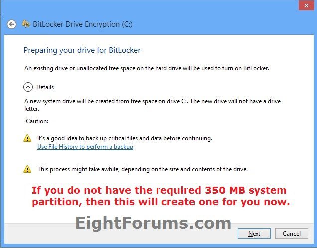

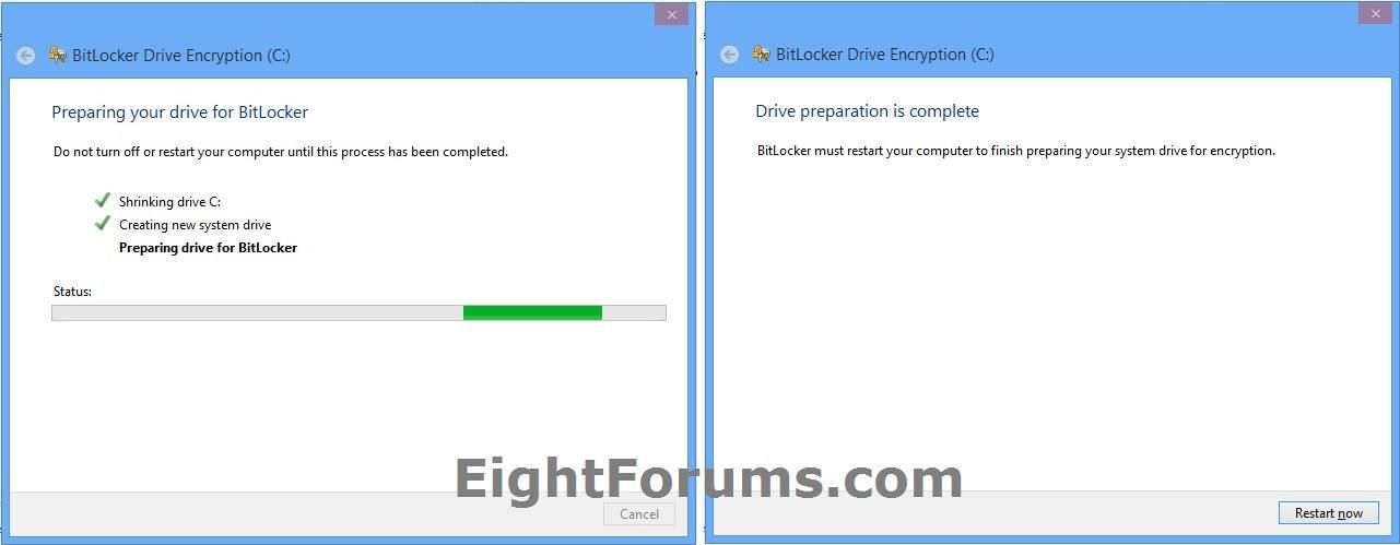

11. If you did not have the required 350 MB system drive partition, then BitLocker will now create one if able. Click/tap on Next, and Restart now when prompted. (see screenshots below)
NOTE: You will not get this step if you do already ave at least a 350 MB system drive partition.

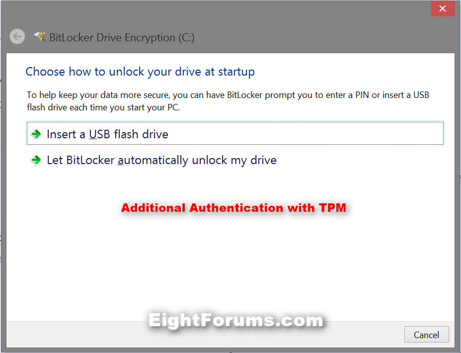

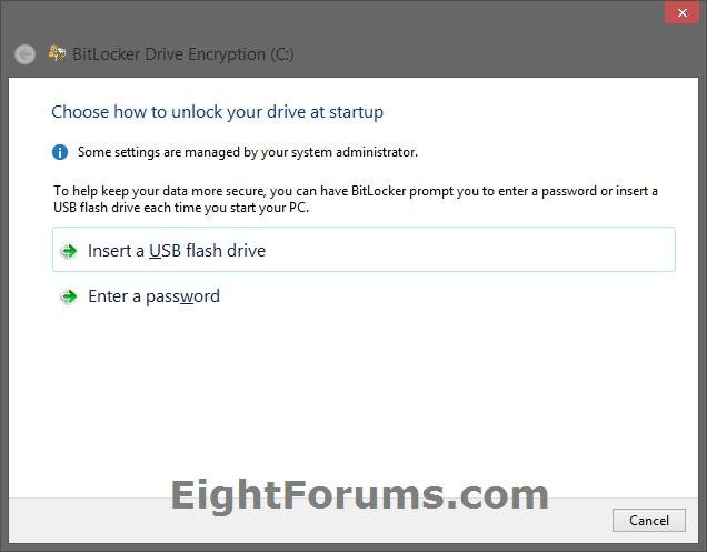

12. Do step 13, 14, or 15 below for what you would like to use to unlock the Windows 8 drive with at startup. (see screenshots below)
NOTE: This will not be available with a TPM unless you did step 3 or 5 above.

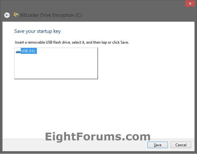

13. To "Insert a USB flash drive" at Boot to Unlock the OS Drive
A) Connect a USB flash drive, and click/tap on the Insert a USB flash drive option. (see screenshot below step 12)
B) Select the USB flash drive you want to save the startup key on, click/tap on Save, and go to step 16 below. (see screenshot below)

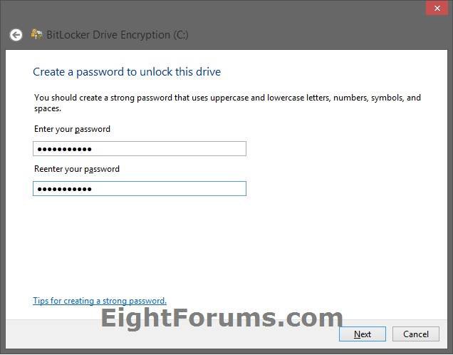

14. To "Enter a password" at Boot to Unlock the OS Drive
NOTE: This will not be available with a TPM.
A) Click/tap on the Enter a password option. (see screenshot below step 12)
B) Enter and reenter a password at least 8 characters long, click/tap on Next, and go to step 16 below. (see screenshot below)
15. To Let BitLocker Automatically Unlock OS Drive
NOTE: This will only be available with a TPM.
A) Click/tap on the Let BitLocker automaticalyl unlock my drive option, and go to step 16 below. (see screenshot below step 12)

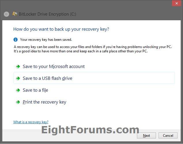

16. Select how you want to back up your BitLocker recovery key, and click/tap on Next when finished. (see screenshot below)
The Save to USB flash drive option will not be available if you are encrypting with a TPM. If you like, you could use the Save to a file option, and select a USB flash drive to save the file to though.
If you forget the password (step 14) or lost the USB flash drive (step 13), then you can still use this recovery key (a string of 48 random numbers) to get back into the OS drive at boot.
It's essential that you store a copy of your recovery in a safe place. If you lose it, you might permanently lose access to your files on the encrypted OS drive.
Tip   Tip
The Save to your Microsoft account option is only available on non-domain-joined PCs.
If you saved the BitLocker recovery key to your Microsoft account, you will be able to log in to your Microsoft account online at the Microsoft's site below from any PC to view all of your saved recovery keys at anytime.

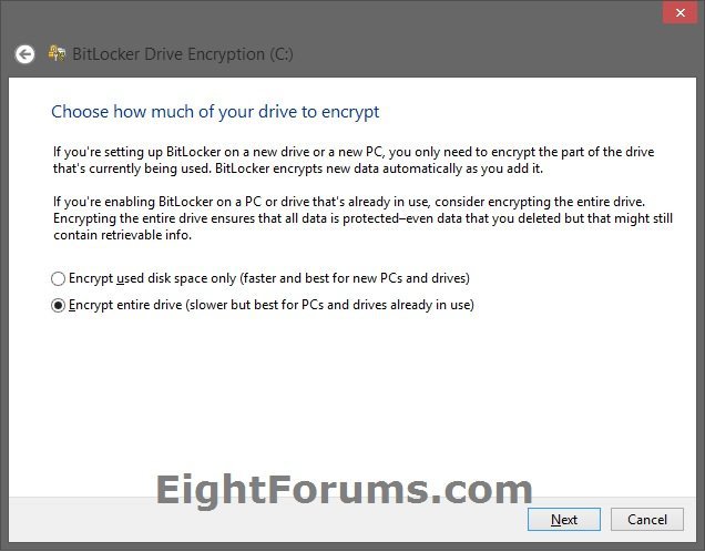

17. Select (dot) to encrypt entire drive, and click/tap on Next. (see screenshot below)

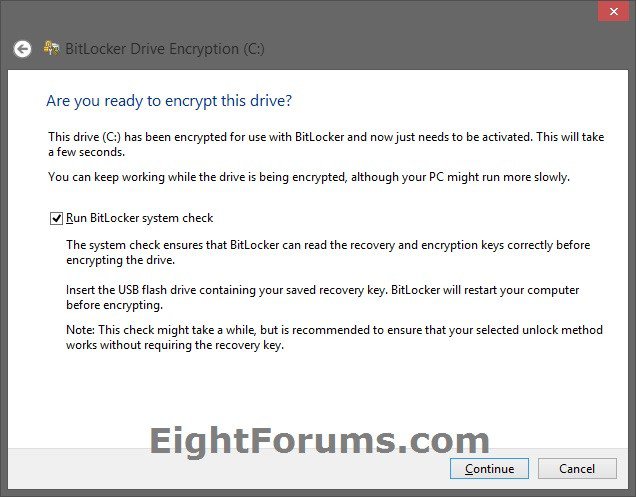

18. Check the Run BitLocker system check box, and click/tap on Continue. (see screenshot below)
NOTE: Running the system check is one more recommended way to make sure that BitLocker works smoothly for you, but it can take longer, and it requires your PC to restart. If you decide to run the system check, make sure you've saved your work before restarting. When your PC restarts, it will prompt you to unlock your operating system drive with the method you just chose in step 12 above.

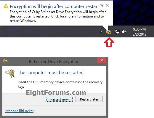

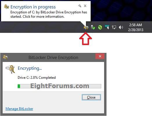

19. You will now notice the BitLocker icon in the taskbar notification area. Click/tap on it, and on Restart now. (see screenshots below)
If you selected to enter password in step 14 above, then you will be prompted to enter the password at boot when the computer restarts.

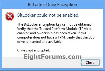

20. If the BitLocker system check failed from step 10 above, then you will see this below. Click/tap on Close. You are now finished since BitLocker was unable to encrypt the Windows 8 OS drive.

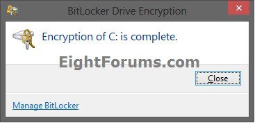

21. If the BitLocker system check was successful from step 18 above, then after a short moment you will notice the BitLocker icon in the taskbar notification area. You can click/tap on it to see the encryption progress. (see screenshot below)
NOTE: This may take a long time to finish, but you will still be able to use your PC during the encryption process. Just do not turn off the PC until it has finished encrypting.
22. When encryption of the Windows 8 OS drive has finally finished, click/tap on Close. (see screenshot below)

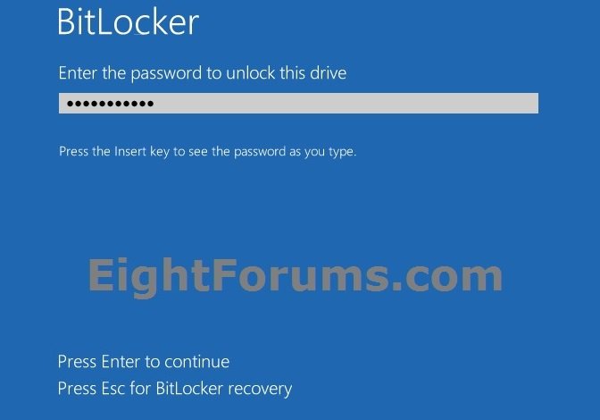

23. Whenever you start the Windows 8 PC, you may be required to either enter a password or connect the USB flash drive depending on what you selected in step 12 above.

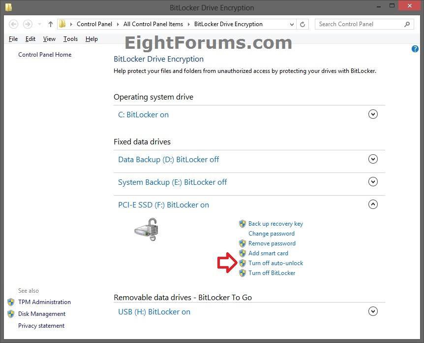

1. If you have not already, you will first need to turn off auto-unlock for any encrypted fixed data drives. If you do not, then all fixed data drives that have auto-unlock turned on will also be decrypted at step 8 below.
NOTE: This does not apply to removable data drives.

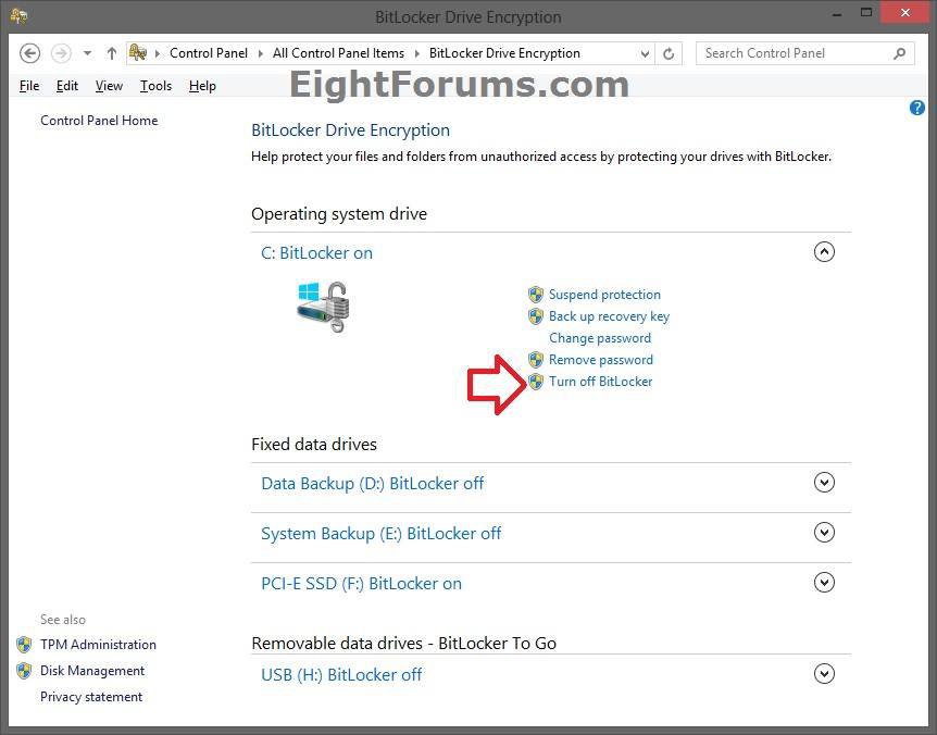

3. Open the Control Panel (icons view), click/tap on BitLocker Drive Encryption icon, and go to step 6 below.
4. In File Explorer, open Computer/This PC, right click or press and hold on the encrypted Windows 8 drive you want to decrypt, click/tap on Manage BitLocker, and go to step 6 below. (see screenshot below step 5)
5. In File Explorer, open Computer/This PC, select (highlight) the encrypted Windows 8 drive you want to decrypt, click/tap on Manage (Drive Tools) tab, click/tap on BitLocker icon in the ribbon, click/tap Manage BitLocker, and go to step 6 below. (see screenshot below)

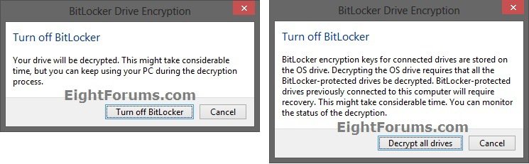

6. Under Operating system drive, click/tap on the arrow to expand the Windows 8 OS drive you want to decrypt, and click/tap on the Turn off BitLocker link. (see screenshot below)
7. If prompted by UAC, click/tap on Yes.
8. Click/tap on Turn off BitLocker or Decrypt all drives depending in if you turned off auto-unlock for all fixed data drives in step 1 above. (see screenshots below)

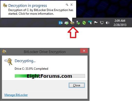

NOTE: This may take a long time to finish, but you will still be able to use your PC during the decryption process. Just do not turn off the PC until it has finished decrypting.

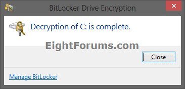

9. You will now notice the BitLocker icon in the taskbar notification area. You can click/tap on it to see the decryption progress. (see screenshot below)
10. When decryption of the drive has finally finished, click/tap on Close. (see screenshot below)

So I successfully encrypted my HDD with BitLocker, and it does asks for password before loading OS.
BUT before BitLocker loads I can still go to my Setup Menu using F2, and to my Boot Menu using F12.
Seems like I can boot the computer from external boot device (CD/DVD) and get access to my data on HDD.
And if you have access to such things than some can probably format my HDD without even knowing my BitLocker password.
I haven't tried breaking into it so far.
BUT THIS IS NOT SUPPOSE TO HAPPEN, BitLocker is suppose to protect my data.
    Windows 8 Pro 64 Bit
    Detailed Specification of my laptop -
    http://goo.gl/KWf5Y
You will still be able to format the hard drive even if BitLocker protected. Formatting is the last restore to be able to use your hard drive again if you somehow lost your recovery keys and are unable to unlock BitLocker anymore, but you do lose all data on the hard drive when you format it.
If the drive is locked by BitLocker, you will not be able access anything on it even outside of Windows at boot.
Hello Brink,
regarding to the "gpedit.msc" steps:
Can you also support us with a reg file for:
"Turn On or Off BitLocker for Windows 8 OS Drive without a TPM"
Because most times it is faster to use a reg file instead of using gpedit.msc.
Hello Brink,
Hello NiFu,
Done. Tutorial has been updated to include .reg files now. :)

I thought I heard all versions of Windows 8.1 will have BitLocker. I updated Windows 8 OEM to 8.1 through the Store and I don't see the BitLocker feature.
Hello power1
The BitLocker Drive Encryption feature is only available in the Windows 8/8.1 Pro and Windows 8/8.1 Enterprise editions.
You may be thinking about Pervasive Device Encryption instead though.
Windows 8.1 - What's New, IT Pro Features, Devices, UI | TechNet
Device encryption previously found on Windows RT and Windows Phone 8 is now available in all editions of Windows. It is enabled out of the box and can be configured with additional BitLocker protection and management capability on the Pro and Enterprise SKUs. Consumer devices are automatically encrypted and protected when using a Microsoft account. Data on any Windows connected standby device is automatically protected (encrypted) with device encryption. Organizations that need to manage encryption can easily take add additional BitLocker protection options and manageability to these devices.
Hope this helps, :)
Sorry, but only in the 8.1 Pro and 8.1 Enterprise editions, and not the plain 8.1. :(
