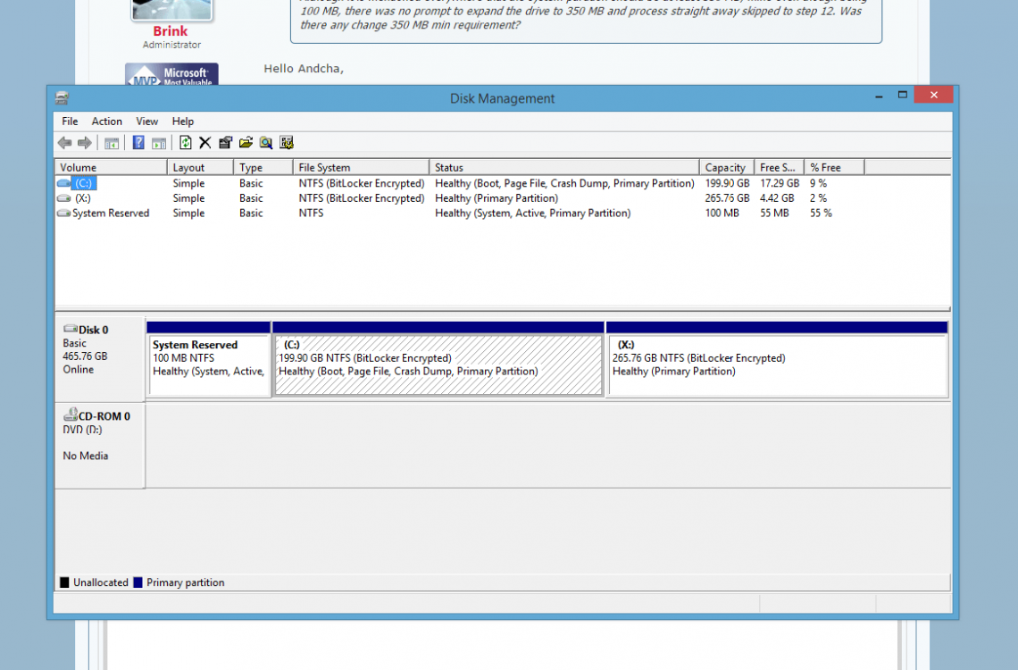

Although it is mentioned everywhere that the system partition should be at least 350 MB, mine even though being 100 MB, there was no prompt to expand the drive to 350 MB and process straight away skipped to step 12. Was there any change 350 MB min requirement?
Hello Andcha,
Not that I'm aware of. Please post a screenshot showing all of your Disk Management to see if it may explain what happened. :)
Here is the screenshot
    Windows 7
    Intel i5 2500K
    Asus P8-Z68-VPRO
    Gskill
    Sapphire 6870
    Dell 2440L
Interesting, Microsoft either changed it, or this was a fluke. It'll be interesting to see if others see this as well with only a 100 MB System Reserved partition instead of 350 MB.
That too 55 MB is free out of 100.
Microsoft FAQ was last updated in October 2013, so maybe latest update has changed this requirement.
My only concern is that nothing goes wrong with my system in future because of this.

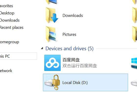

hello everybody
I have a problem. I need your help
I have unlock the BITLOCKER to unlock the usb flash drive on the original system
I changed the system to appear not to recognize U disk valid file
Hello doyoc, and welcome to Eight Forums. :)
I'm not sure what you mean. Just to verify, are you saying that the USB will no longer unlock the OS drive at startup?
Please provide more details.
