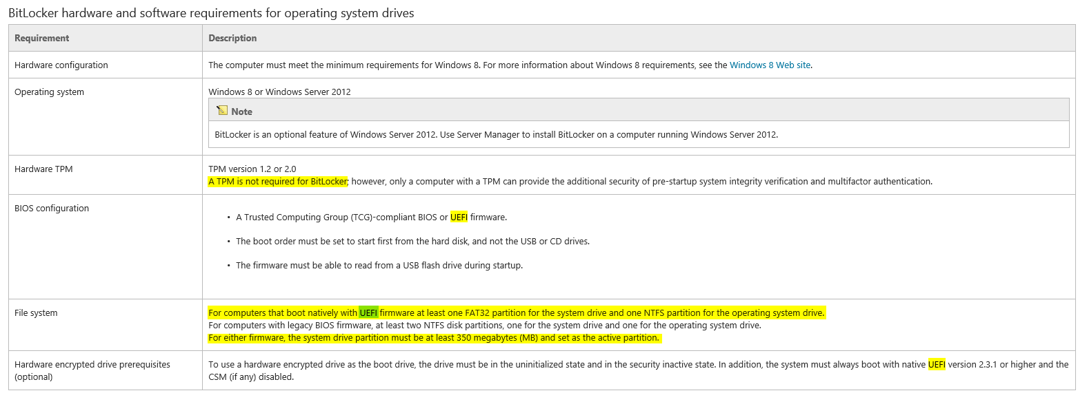

  • For computers that boot natively with UEFI firmware, BitLocker requires at least one FAT32 partition for the system drive and one NTFS partition for the operating system drive.
  • For computers with legacy BIOS firmware, BitLocker requires at least two NTFS disk partitions, one for the system drive and one for the operating system drive.
  • The system drive partition must be at least 350 MB and set as the active partition. If you do not have a system partition, then BitLocker will check for and create one automatically if able step 7 in OPTION ONE below.
  • To be able to automatically unlock fixed data drives, the drive that Windows 8 is installed on must also be encrypted by BitLocker.

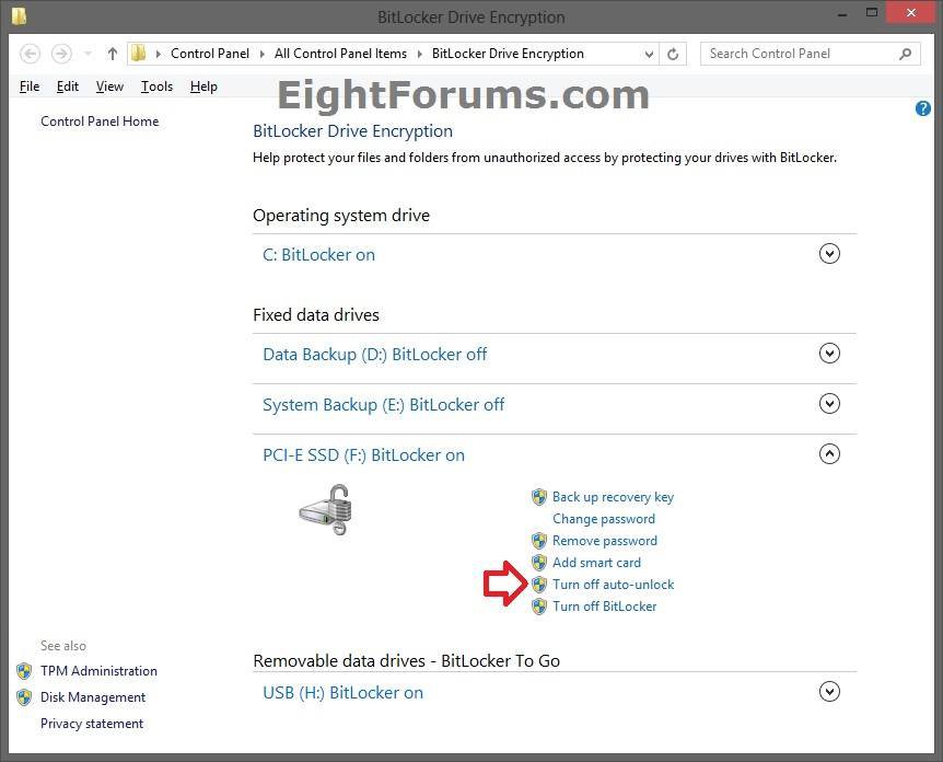

1. If you have not already, you will first need to turn off auto-unlock for any encrypted fixed data drives. If you do not, then all fixed data drives that have auto-unlock turned on will also be decrypted at step 8 below.
NOTE: This does not apply to removable data drives.
2. Do step 3, 4, or 5 for how you would like to start.

bitlocker on yoga 2 pro
i want to encrypt my yoga 2 pro [y2p] system running 8.1.
i tried to boot a kali linux thumbdrive on it to see if the y2p could boot from it. i discovered it would not boot from the thumbdrive by default; I had to make an /EFI/Boot folder on the thumbdrive and add some files to it (https://forums.kali.org/showthread.php?271-How-to-EFI-install-Kali-Linux) for the Y2P system to be able to see and try to boot from the USB thumbdrive.
this has me worried about trying to use bitlocker on the Y2P; worried it wont be able to use the thumbdrive to unlock the encrypted drive because bitlocker doesn't support EFI systems? (Windows BitLocker Drive Encryption Frequently Asked Questions).
i'm terrified of trying to enable bitlocker on this thing.
btw - im not insistent on using a usb key for bitlocker; i'd actually prefer to use a passphrase.
doesn't seem like Y2P has a TPM chip (https://forums.lenovo.com/t5/Idea-Windows-based-Tablets-and/Yoga-2-TPM-chip/td-p/1298457).
another related link: ***Yoga 2 Pro Owners Thread*** - Page 75
and another: bitlocker - Lenovo Community
i feel like this is way too difficult or i am missing something simple here.
what should i do? any advice?
thanks in advance all!
    windows and linux
Hello Devios, and welcome to Eight Forums.
The Microsoft article you referenced for BitLocker was for Vista instead. The BitLocker in Windows 8 and 8.1 will work just fine with UEFI, so no worries there.
You should have no issue using either a passphrase or USB, but I would recommend to keep a backup copy of the BitLocker startup and recovery key in a safe location should something happen to the USB or you forget the passphrase, and easier if you should ever need to recover the drive.
It does seem difficult, but it's really not once you give it a try and get used to it. Once you do, it almost no different then signing in to Windows, but just more securely.
Encrypting with BitLocker will either be successful or fail, but you shouldn't have any issues while doing the steps exactly in the tutorial. If it fails, then no harm no foul since nothing would have changed.
Please feel free to ask any questions you may have. :)
thanks brink - i couldn't seem to find any link where microsoft (or anyone else) states bitlocker works fine/easily/completely on 8.1 UEFI systems without a TPM chip. do you have any such link(s)?
either way, i'll give it a shot when my new usb thumbdrives arrive and let forum know how it goes.
    windows and linux
That documentation example isn't super clear. Where do they find the monkeys that write and edit the MS documentation?!
For the record, happy to report that after making the policy change to allow bitlocker on a machine without a TPM chip, I was able to encrypt my C:\ (system) drive using BitLocker, and was allowed to chose to use a passphrase or USB key to unlock on boot. I chose password, and it's working great on my Y2P.
Thank you again for the help and information!
