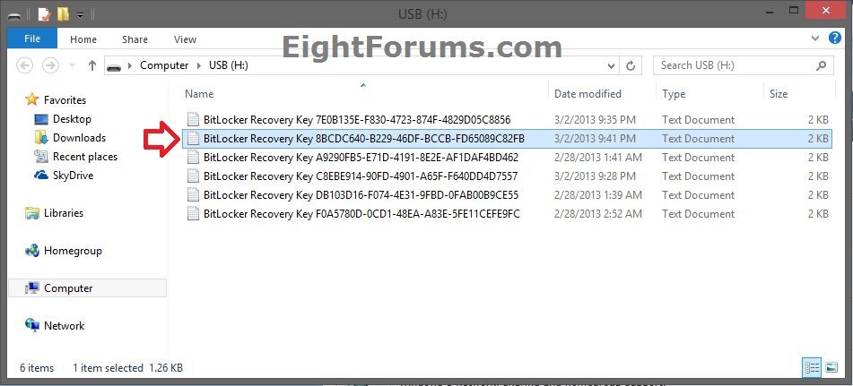

16. Select how you want to back up your BitLocker recovery key, and click/tap on Next when finished. (see screenshot below)
The Save to USB flash drive option will not be available if you are encrypting with a TPM. If you like, you could use the Save to a file option, and select a USB flash drive to save the file to though.
If you forget the password (step 14) or lost the USB flash drive (step 13), then you can still use this recovery key (a string of 48 random numbers) to get back into the OS drive at boot.
It's essential that you store a copy of your recovery in a safe place. If you lose it, you might permanently lose access to your files on the encrypted OS drive.
Tip   Tip
The Save to your Microsoft account option is only available on non-domain-joined PCs.
If you saved the BitLocker recovery key to your Microsoft account, you will be able to log in to your Microsoft account online at the Microsoft's site below from any PC to view all of your saved recovery keys at anytime.
http://windows.microsoft.com/recoverykey

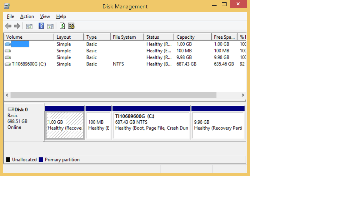

Bitlocker install apparently stalls on reboot
I have read this article which is very detailed and specific. I followed it to a "T". My machine has no TPM. The OS is WIN8.1pro without all the recent updates. I used the registry download. I have prior to this attempt used one supplied by our IT department very similar and manually made the entries. Everything follows exactly as described up until the point of reboot to finish the install. I have repeated the process about 8X now.
Once the laptop comes back up and the password or USB thumb drive key is satisfied, the screen goes rather blank and displays "Preparing automatic Repair". The first time I got this I left it in that state for about 13 hours without change, drive light notification, or visual progress of any type. The only way to get out of it is to power off.
Is this something that is working and needs to continue for a couple of days, or is something else going wrong?
    WIN8.1PRO
    ASUS
    Intel i5-3210M 2.5Ghz
    8GB
    IE11
Hello TheTechGuy, and welcome to Eight Forums. :)
I'd say something else it wrong. Do you dual boot with another OS?
If you get past the "Preparing automatic Repair" screen, what happens when you click on the "Restart to Windows" type option?
Thanks for the quick reply. There is only the original WIN8 that was updated to 8.1 then Pro just a week ago. So no dual boot.
Once the laptop starts to boot, I do get a blue box on the screen asking for my password for what seems to primarily be looking to fix the Bitlocker install.
I have never gotten past that black screen "preparing automatic repair". After waiting over 13 hrs. and never noticing a drive light come on or any other progress screen I just gave up and powered off so I could continue using the laptop. When I do power off and finish the reboot I, of course, get the window telling me the C: drive was never encrypted.

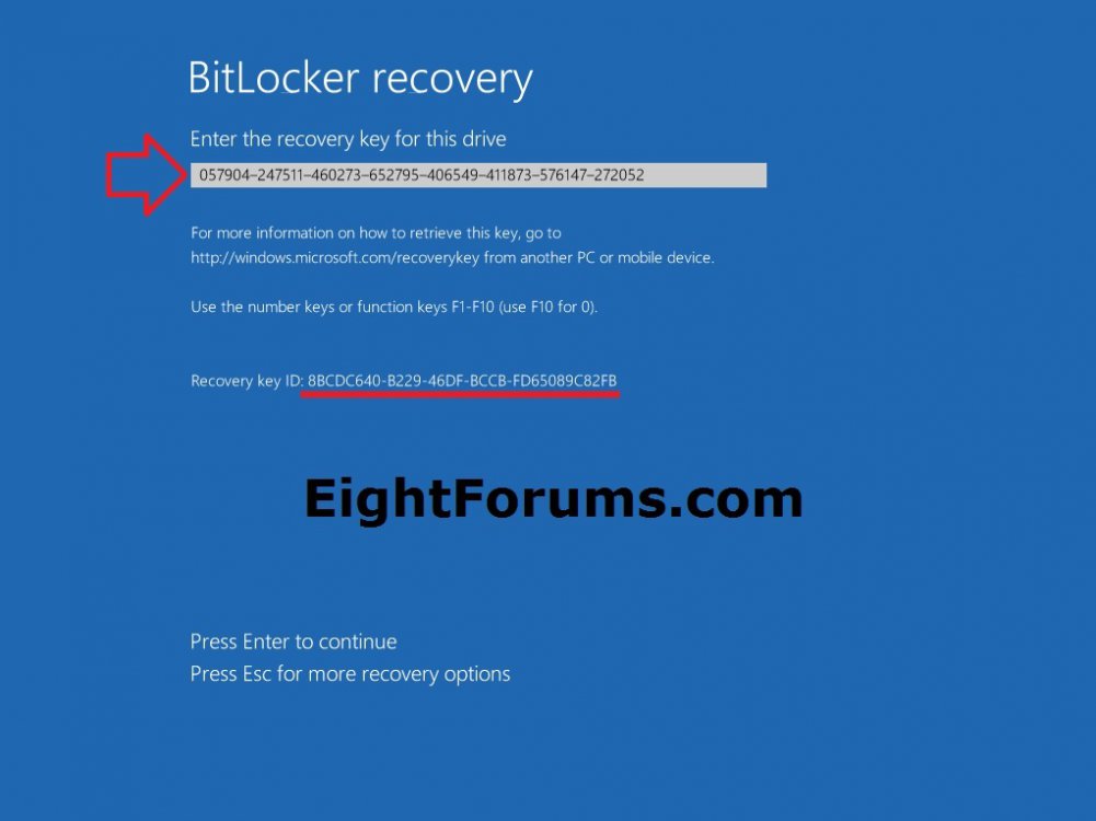

I'm new to this forum so I apologize if I am not posting in the right section, but I was able to get my BitLocker on, but just curious about the following message, particularly the part where it says "...value displayed on your PC."
Where on my PC do I find this identifier?

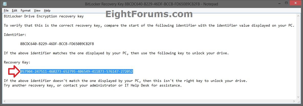

BitLocker Drive Encryption recovery key
To verify that this is the correct recovery key, compare the start of the following identifier with the identifier value displayed on your PC.
Identifier:
If the above identifier matches the one displayed by your PC, then use the following key to unlock your drive.
Recovery Key:
If the above identifier doesn't match the one displayed by your PC, then this isn't the right key to unlock your drive.
Try another recovery key, or refer to BitLocker recovery keys: Frequently asked questions - Microsoft Windows Help for additional assistance.

Access is Denied Message
Disabled Secure Boot and tried again--behavior did not change.
I just joined the company and am waiting for my domain access. I am using my own laptop (welcome to the world of BYOD). I blew away the original Win 8 install, and installed an image that was provided by the client. For now, I am logging into the local machine as "administrator."
Screenshot of Data Management configuration attached.
Thanks,
EdG

EdG,
Ah, I see why now. The disk already has the maximum 4 primary partitions on it. The other partitions other than C: are the factory recovery partitions.
This would be why you are getting this error since BitLocker is unable to create a new partition, or use the existing first recovery partition.
It really is a shame how these OEMs setup a disk like that.
Sorry for the delay, but my problem was resolved and I just now have gotten a chance to update the thread.
Once I received my domain credentials, and logged in, a job kicked off automatically and I was prompted to allow Bitlocker to run and encrypt my harddisk which it did. So I assume the domain admins were able to build something into the image that I loaded to prevent manually installing Bitlocker.
