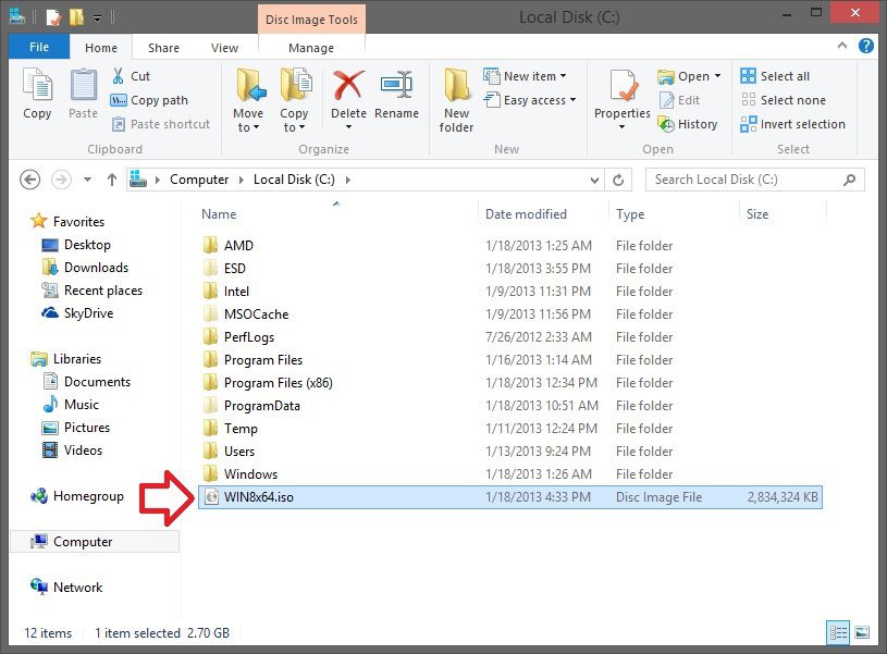

9. The upgrade Windows 8 ISO or full Windows 8.1 Update ISO file will be at the root of your C: drive. For example, C:\WIN8x64.iso. (see screenshot below)
You could now create a bootable DVD/USB or UEFI USB with this ISO file to do a clean (8.1), clean for upgrade (8), or upgrade (8/8.1) install of Windows 8/8.1 with.

Hi Shawn,
Used the ESD method, which wrote the file to the "C:\Users\<username>\AppData\Local\VirtualStore" folder. No prob.
I note that the ISO is not named "8.1" but "8" instead. Is it indeed the 8.1 ISO - before I go to the trouble of the install?
Thanks, and good work! h
    W8
Hello Borgus,
No worries. It's for 8.1. The product key you enter determines what gets installed.
I chose to have an ISO created, which uses the same files from ESD. When I used the ISO to install Windows 8.1 in a virtual machine to verify if it was an upgrade or full ISO, it came up as Windows 8. After entering the 8.1 product key, it did show as and install the Windows 8.1 I purchased. It was also verified that it installed a full retail version of Windows 8.1. :)
