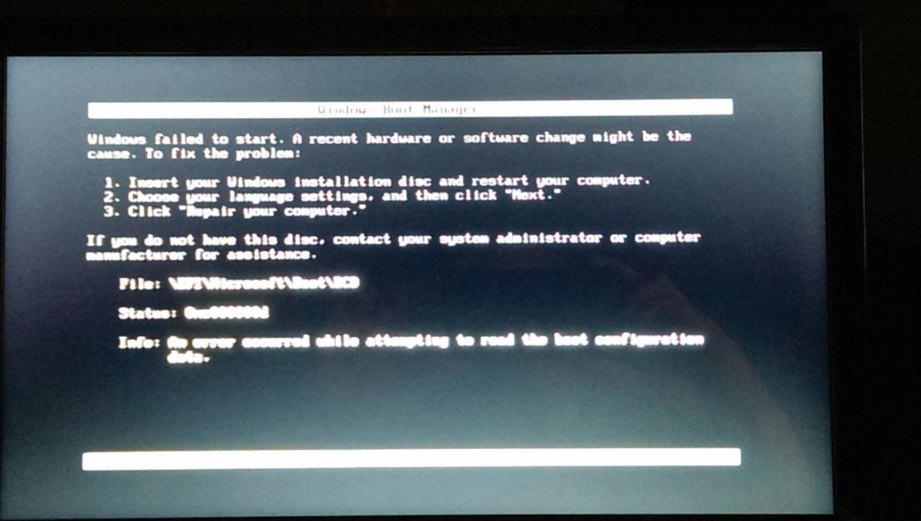

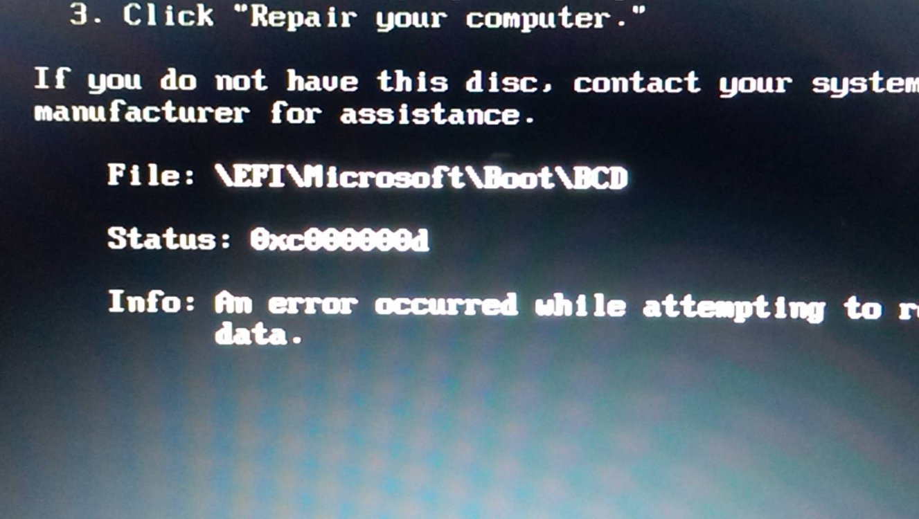

Hi everyone, I'm new here :geek:
I have the same problem as jamerst had in post #47: When I insert the UEFI-prepared USB stick containing Windows 7 Ultimate 64-bit, I get that "Windows failed to start..." error message with status 0x000000d. See screenshots below. (Sorry for being unclear, probably because it's a glossy screen.)
Hardware:
Toshiba Satellite U940 (Ultrabook with a 32 GB mSATA SSD + 500 GB HDD)
Kingston Data Traveller, USB 2.0, 16 GB
What I've done before:
I exchanged the 500 GB HDD for a 60 GB OCZ Agility 3 SSD, disabled Secure Boot and Fast Boot, and changed the BIOS setting from UEFI to CSM. I then did a clean install of Windows 7 Ultimate 64-bit onto that SSD, deleting old partitions and creating a new one during setup. I know I could leave it at that, but I'd really like to get it working through UEFI!
Here is what I've tried/made sure of so far:
  • Tried Option 1 and 2 from this tutorial - following it to the letter.
  • Used the only USB 2.0 port, but also tried the USB 3.0 ports - to no avail.
  • I have read all 21 pages of this thread and tried all suggested solutions.
  • In the BIOS, Secure Boot and Fast Boot are disabled, it is set to boot from UEFI now, and the USB stick is recognised and set to be first in the boot order. However, it does not, like some other systems, specify the USB stick or any other drive as UEFI or anything.
  • The Windows ISO was a genuine one, not from a torrent site or something.
What I haven't tried yet - will do so now:
  • Try another USB stick.
  • Try removing the mSATA SSD - not sure if that would help.
I have a feeling that it simply cannot boot from the USB stick and skips it, then tries to launch Windows 7 off the drive, which was not a UEFI install.
Any additional help would be much appreciated! Thanks in advance!

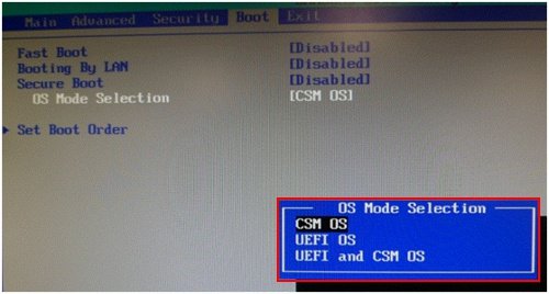

The Toshiba UEFI/BIOS has a miss option.
Toshiba OEM manufacturer:
UEFI = Windows 8 installed in UEFI mode only.
CSM = all OS's installed in Legacy mode.
Other OEM manufacturer:
CSM = all OS's installed in Legacy mode only.
UEFI & CSM = all OS's installed in Legacy mode or UEFI mode.

Hello mathemagician, and welcome to Eight Forums.
That error usually means the installer is not written correctly to USB stick. What type of ISO file did you use? If you haven't already, then you might see if using the Windows 7 Ultimate x64 SP1 U (x17-59465.iso) English one from the link below may work better.
One thing I noticed is that you would still want to have your new SSD listed first in the boot priority list in BIOS, but instead select to boot from your boot menu to select to boot from the USB stick temporarily for just that one time. Otherwise, when the PC restarts the first time during installation, it will just boot from the USB again and start the installation process from scratch again.
Hope this may help some for now, :)
Thanks for pointing this out! How annoying! I suppose there is no way to get it to work then...
Does this mean if I tried preparing a USB stick (as explained in this tutorial) with Windows 8, that it would work through UEFI?

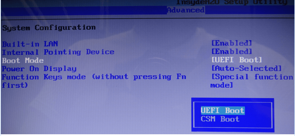

Odd, I thought you had a CSM and UEFI option?
However, I'm happy to hear that you got it installed using UEFI like you wanted. :)
Hi Shawn,
Yes, there is a CSM and a UEFI boot option, but no CSM and UEFI, which, according to theog, would be required to install Windows 7 through UEFI.
All I got working was to boot from a Windows 8 UEFI USB stick but I haven't installed it yet. Might do it since before I swapped the HDD for the SSD and it was booting Windows 8 through UEFI (HDD + 32 GB mSATA SSD Cache) it was a hundred times faster than now with an SSD booting Windows 7 through CSM.
So what theog said about Toshiba purposely omitting the boot setting in the BIOS required to install Windows 7 through UEFI seems to be true, since it worked first time with a Windows 8 boot stick.

I have a Toshiba Satellite and all the steps above works fine to me up to where the Windows Logo shows up with the 'Starting Windows' message and it freezes there forever. My Toshiba Model is Satellite P875-S7310. HELP! THANKS!
    Windows 7 on MBR Legacy Boot option
