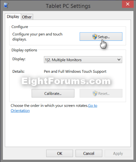

1. Open the Control Panel (icons view), and click/tap on the Tablet PC Settings icon.
2. Click/tap on the Setup button in the Display tab under Configure. (see screenshot below)
3. If prompted by UAC, then click/tap on Yes.

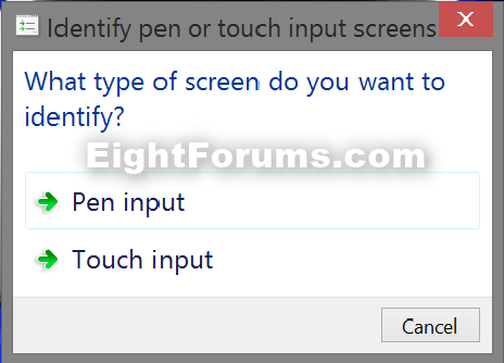

4. Do step 5 or 6 below for what you want to do. (see screenshot below)

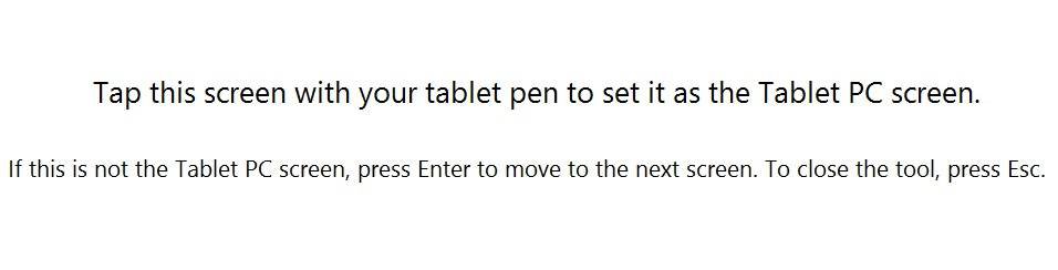

5. To ID Screen for Pen Input
A) Click/tap on Pen input. (see screenshot below step 4)​
B) Tap the screen with your tablet or stylus pen that you want to set as the Tablet PC screen, and go to step 7 below. (see screenshot below)​

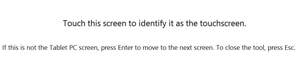

6. To ID Screen for Touch Input
A) Click/tap on Touch input. (see screenshot below step 4)​
B) Touch the screen with your finger that you want to identify as the touchscreen, and go to step 7 below. (see screenshot below)​
7. When finished, click/tap on OK. (see screenshot below step 3)

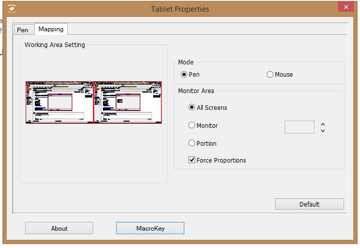

I have a Genius pen/tablet (G-Pen F610) which was working fine on my dual display when I was on Windows 7. However, since on Windows 8.1, my pen only goes halfway on the right monitor (which is the second display). So I basically have 1.5 monitors mapped out to my tablet. I'm really not sure how to fix this... the drivers that came with it are set to dual monitors...
Any help please?

If I launch Pen/Pad options which Im not sure if its Windows or Genius software, but as long as its open, my pen works across both monitors. Seems to me that perhaps some sort of service is not enabled at startup. But what could that be? Is that a possiblity?

That would be from the Genius drivers.
I suppose that you could add the pen/pad options in your Startup folder to have it automatically run at startup for you.
Well heres the thing... its already in the tray at Startup.... but its only when its launched fully with that intereface that it "rectifies" the issue...
