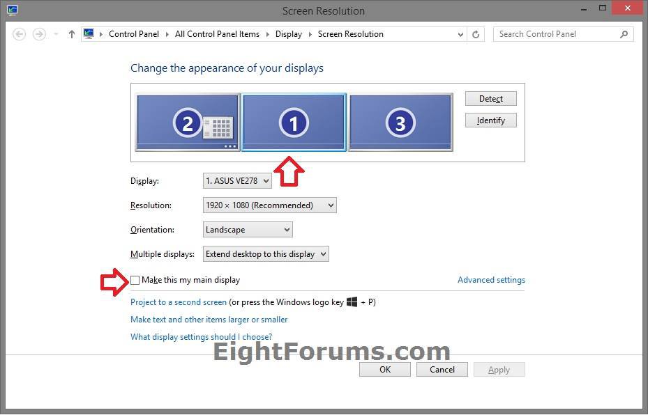

1. Do step 2 or 3 below for how you would like to open Screen Resolution.​
2. Right click or press and hold on an empty area on your desktop, click/tap on Screen resolution, and go to step 4 below. (see screenshot below)​

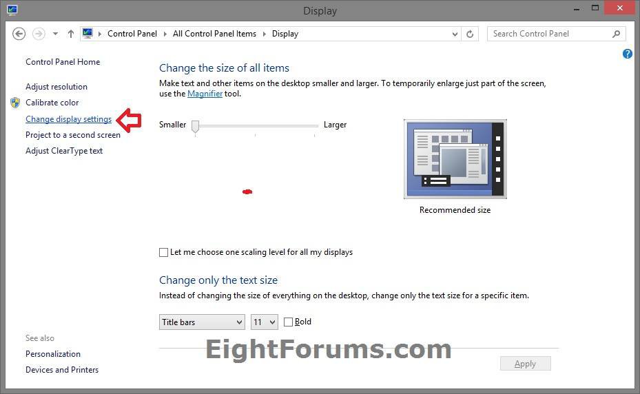

3. Open the Control Panel (icons view), and click/tap on the Display icon.​
A) Click/tap on the Change display settings link in the left pane, and go to step 4 below. (see screenshot below)​

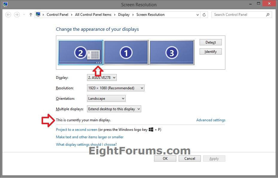

4. At the top, you will see your current main display with the small window and notification area icons in the lower left corner, and the "This is currently your main display" indication. (see screenshot below)​
5. At the top, click/tap on the display that you want to make your main display, check the Make this my main display box, and click/tap on OK to apply. (see screenshot below)​
NOTE: If you do not know which display is which, then you can click/tap on the Identity button to display the number on your display(s) to see.​

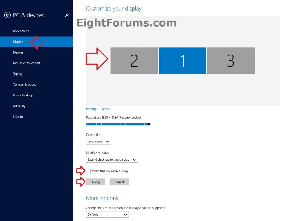

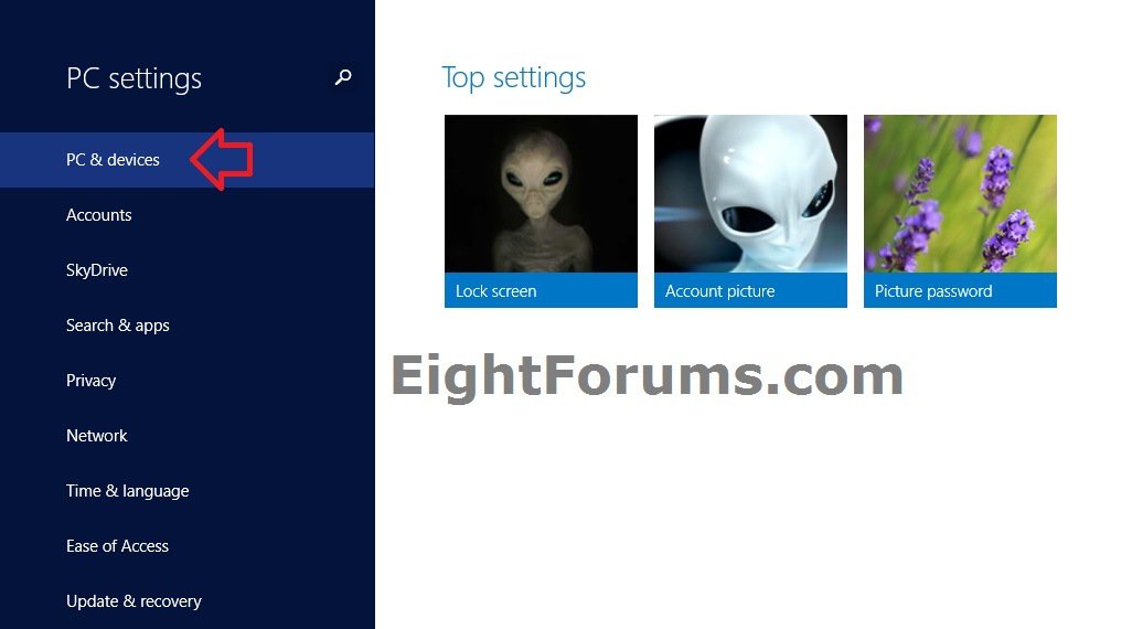

1. Open PC settings, and click/tap on PC & devices on the left side. (see screenshot below)​
2. Click/tap on Display on the left side of PC & devices. (see screenshot below)​
3. At the top on the right side, select a display (ex: monitor) that you want to make your main display. (see screenshot below step 2)​
NOTE: If needed, you can click/tap on the Identify link to have the display number briefly appear on each display to help know which one to select.​
4. On the right side, check the Make this my main display box, and click/tap on the Apply button. (see screenshot below step 2)​
If you see this below, then it means that the currently selected display is already set as your main display.
