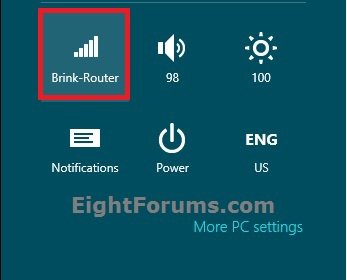

2. Click/tap on the Network icon in the taskbar system icons area at the far right. (see screenshot below)​

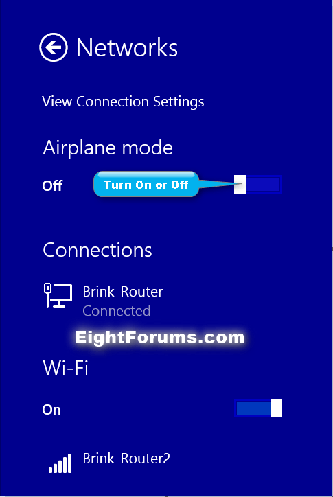

3. At the top of the Charms bar under Airplane mode, move the sliders right or left to turn it on or off. (see screenshot below)​
4. When finished, you could press the Windows :winkey: key to return to the Start screen if you like.​

1. Open the Charms bar, click on the Settings charm, and click/tap on your wireless network icon. (see screenshot below)​
NOTE: You could also press the Windows :winkey: + I keys to directly open the Settings charm.​
2. At the top of the Charms bar under Airplane mode, move the slider right or left to turn it on or off. (see screenshot below)​
3. When finished, you could press the Windows :winkey: key to return to the Start screen if you like.​

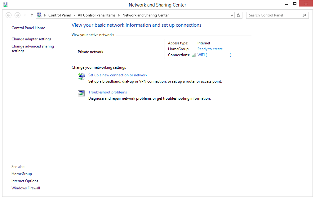

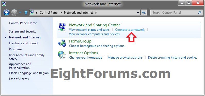

1. Open the Control Panel (category view), click on the Network and Sharing Center link, and click on the Connect to a network link. (see screenshot below)​
3. When finished, you could close the Control Panel and press the Windows :winkey: key to return to the Start screen if you like.​

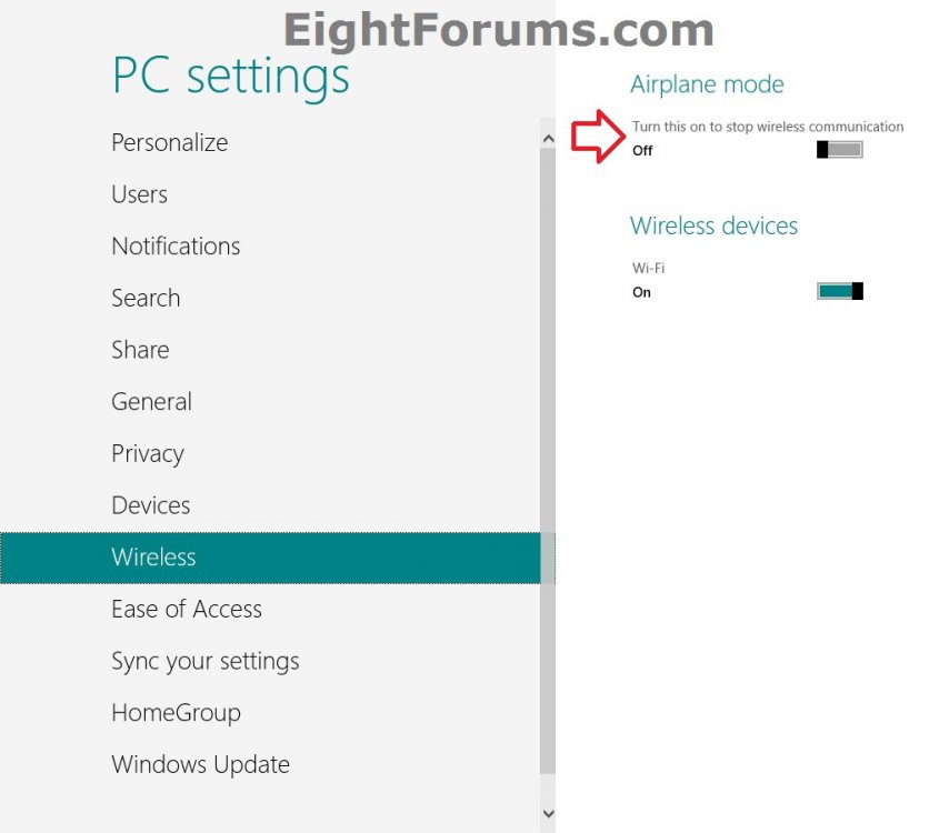

1. Open PC Settings, and do step 2 or 3 below for what Windows 8 you have.​
2. In Windows 8 and Windows RT, click/tap on Wireless on the left side, and go to step 4 below. (see screenshot below step 4)​

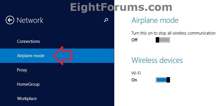

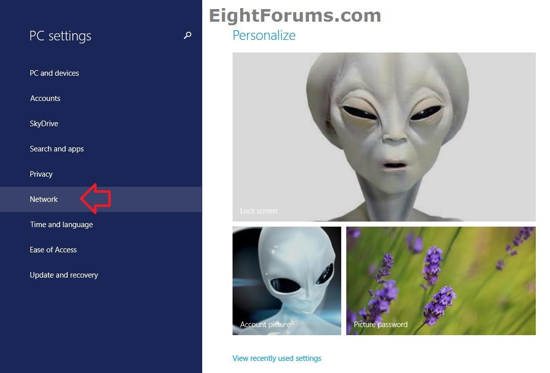

3. In Windows 8.1 and Windows RT 8.1, click/tap on Network on the left side. (see screenshot below)​
A) Click/tap on Airplane mode on the left side of Network, and go to step 4 below. (see screenshot below)​
4. In the right pane under Airplane mode, move the slider right or left to turn it on or off. (see screenshot below)​
NOTE: If you like, you could turn on or off individual Wireless devices here instead of all of them with Airplane mode.​
5. When finished, you can close PC settings if you like.​

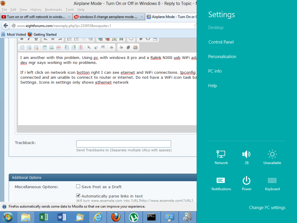

I am another with this problem. Using pc with windows 8 pro and a Ralink N300 usb WiFi adapterwhich install fine as dev mgr says working with no problems.
If i left click on network icon botton right I can see eternet and WiFi connections. Ipconfig shows adapter as not connected and am unable to connect to router or internet.
Wireless LAN adapter WiFi 2:
Media State . . . . . . . . . . . : Media disconnected
Connection-specific DNS Suffix . :
Description . . . . . . . . . . . : 802.11n USB Wireless LAN Card #2
Physical Address. . . . . . . . . : 7C-DD-90-37-7D-7A
DHCP Enabled. . . . . . . . . . . : No
Autoconfiguration Enabled . . . . : Yes
Do not have a WiFi icon task bar or wireless in PC Settings. Icons in settings only shows ethernet network.see attachments.
Any suggestions would be appreciated as I have even spoken to MS and they don't have a clue (No further comment on that :zip: )
Thanks in advance
Keith

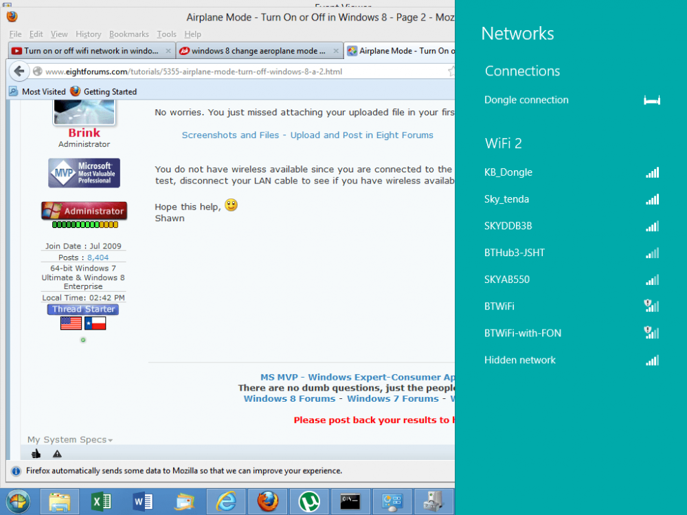

With ethernet disconnected still get
attachment.php

It shows your available wireless connections now, but it also shows that you are not currently connected to one.
Did you ever setup a wireless profile?
You can click on a listed wireless connection to set up a profile with it. If it's not listed (ex: hidden), then you can click on "Hidden network" to set up a profile instead.
