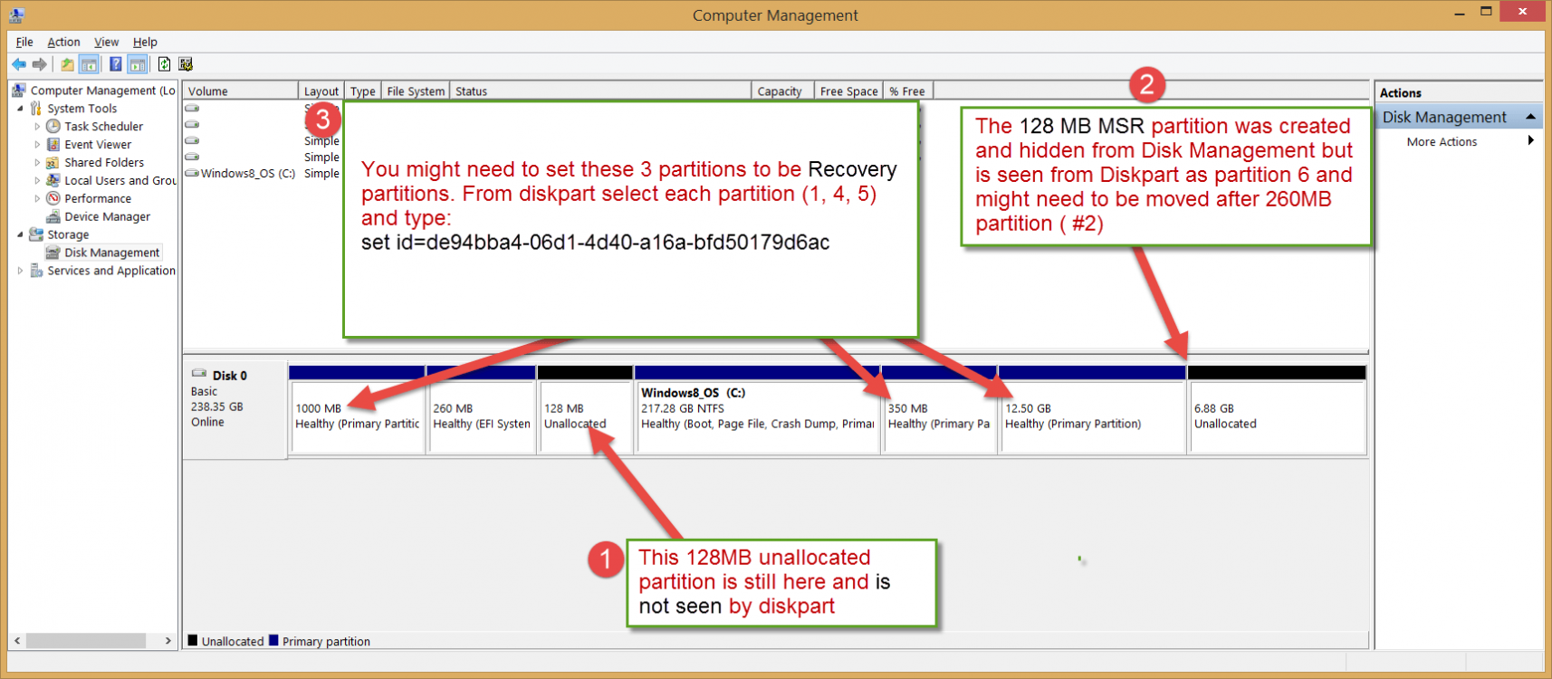

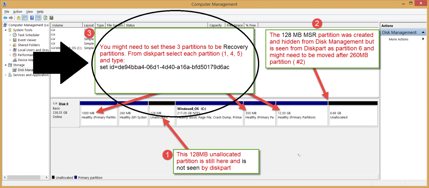

Yes, no changes. Please see attached.
Can you post a screen shot of Disk management?
The should not be showing.
Based on your last 2 screen shots. I edited the above and here's what I saw.

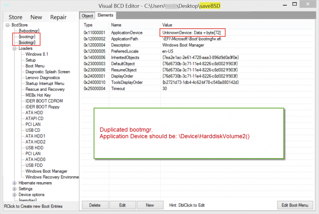

In addition, I looked at the saveBCD file and found duplicated Boot Manager and does not look right. Maybe Theog can throw in some thought
May be Startup Repair or a over install.

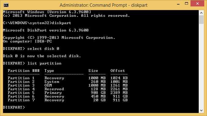

I seem to remember Lenovo systems having two 1000 MB partitions, one being marked as OEM. Your system was not configured this way?
Lenovo G580 (after Windows 8.1 update from the Windows Store)
Partition 1 - Recovery - 1000 MB
Partition 2 - System - 260 MB
Partition 3 - OEM - 1000 MB - OEM partition does not exist in all Lenovo computers (with Windows 8/8.1).
Partition 4 - Reserved - 128 MB - This partition not visible within Windows Disk Management.
Partition 5 - Primary - 908 GB
Partition 6 - Recovery - 350 MB or 450 MB - Windows RE location
Partition 7 - Recovery - 20 GB - Recovery image location
@arcturius: View screenshots of Lenovo computer (when everything works ok) -> link

This must be done [DEL]first[/DEL] (see screenshot below).
select partition #
set id=de94bba4-06d1-4d40-a16a-bfd50179d6ac

The new MSR partition would need to deleted first.

1) Delete new MSR, which will be added to last partition 6.88gb, making the partitin 7,00gb.
2)Make partiton & format.
3)Make NEW MSR,
