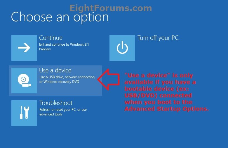

You will only see the Use another operating system option if you dual boot Windows 8 with another OS (ex: Windows 7 or Vista) with Windows 8 set as the default OS to run at startup, or added Safe Mode to the Windows Boot Manager. Some OEM computers will have a Use a device option.

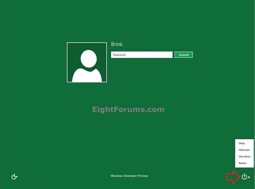

3. While Signed out of Windows 8
A) If signed out, go to step 5 below.​

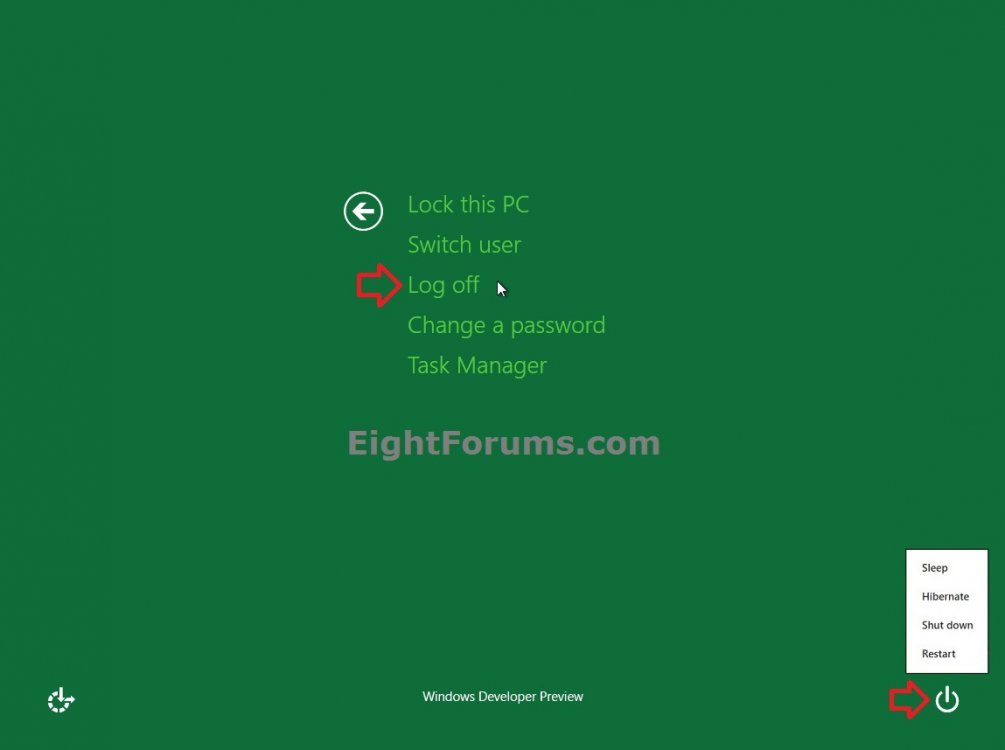

4. From the CTRL+ALT+DELETE Screen
A) Press the CTRL+ALT+DEL keys, and go to step 5 below.

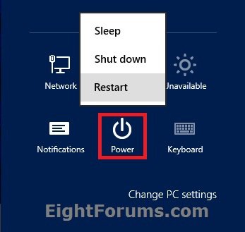

5. Click/tap on the Power button at the bottom right corner, press and hold the Shift key, and click/tap on Restart. (see screenshots below)

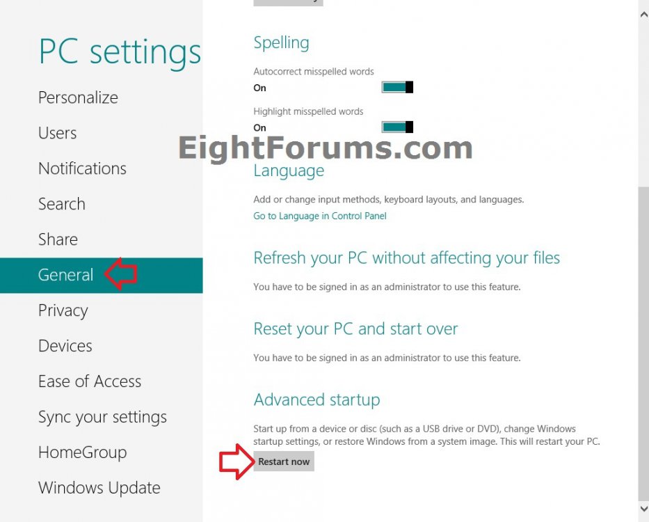

Boot to Advanced Startup Options from PC settings in Windows 8 and 8.1
1. Open PC settings, and do step 2 or 3 below for the Windows 8 you have installed.​
2. If you have Windows 8 or Windows RT
A) In the left pane, click/tap on General, click/tap on Restart now under Advanced startup in the right pane, and go to step 4 below. (see screenshot below)​

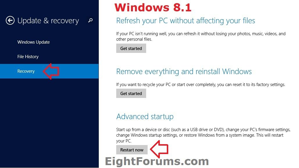

3. If you have Windows 8.1 or Windows RT 8.1

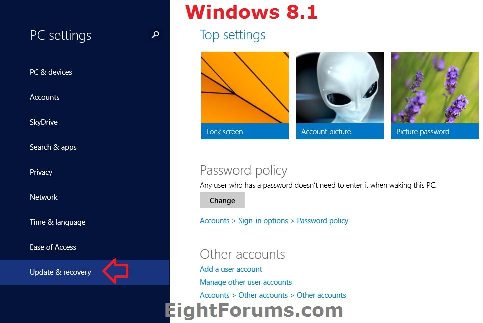

A) On the left side in PC settings, click/tap on Update & Recovery. (see screenshot below)​
B) On the left side in Update & Recovery, click/tap on Recovery, click/tap on the Restart now button under the Advanced startup section on the right side, and go to step 4 below. (see screenshot below)​

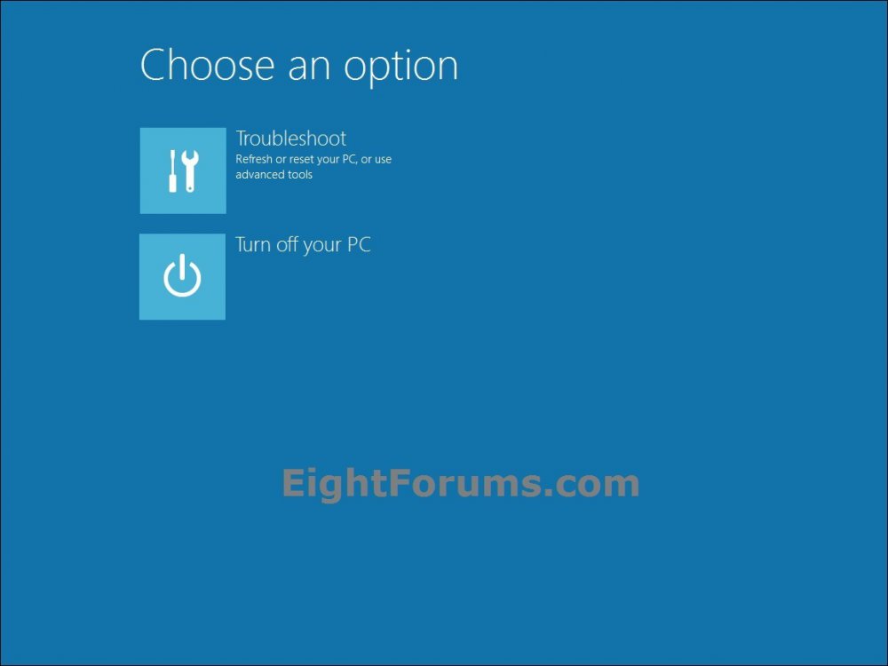

4. When your PC restarts, you will now see the Advanced Startup Options at boot. (see screenshot below)​

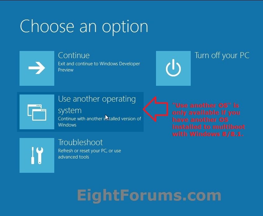

NOTE: You will only see the Use another operating system option if you dual boot Windows 8 with another OS (ex: Windows 7 or Vista) with Windows 8 set as the default OS to run at startup, or added Safe Mode to the Windows Boot Manager.​

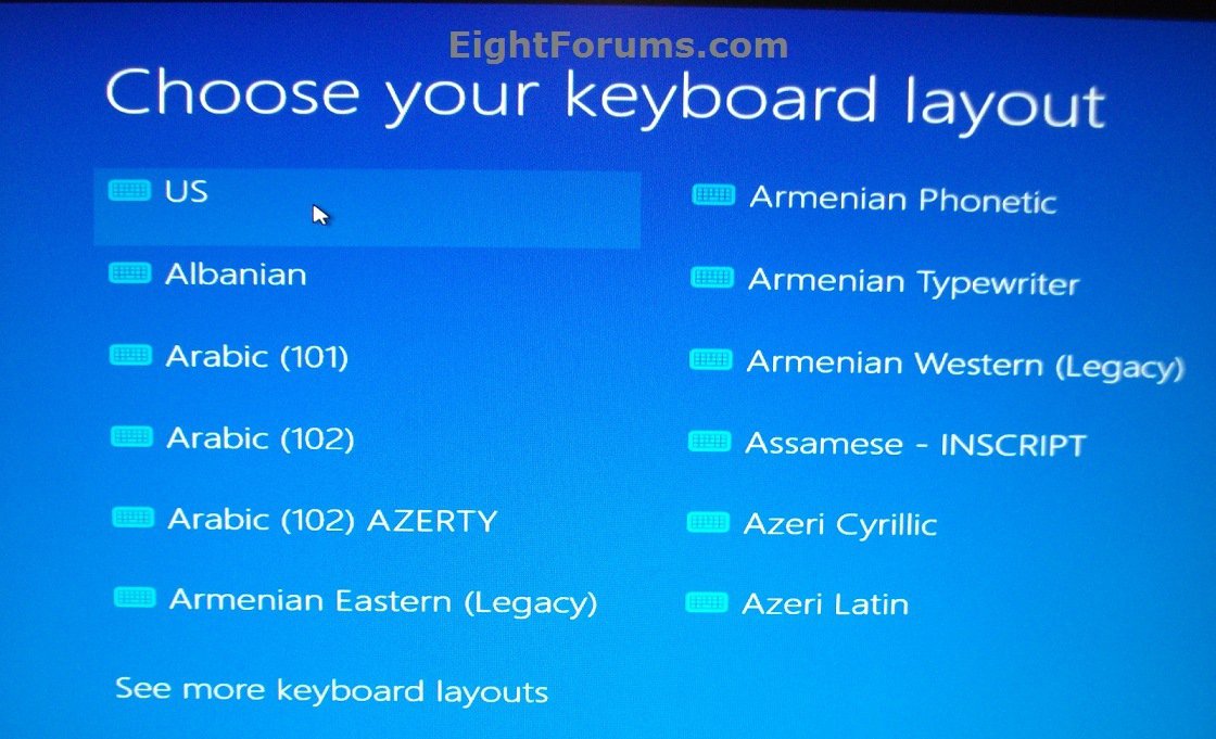

2. If displayed, click/tap on your keyboard layout language. (see screenshot below)​

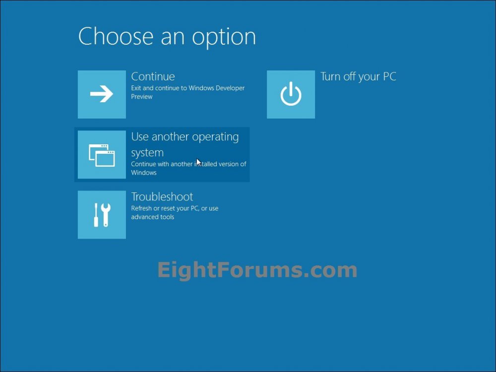

3. You are now in the Startup Options menu at boot where you can choose what option you would like to do. (see screenshot below)​

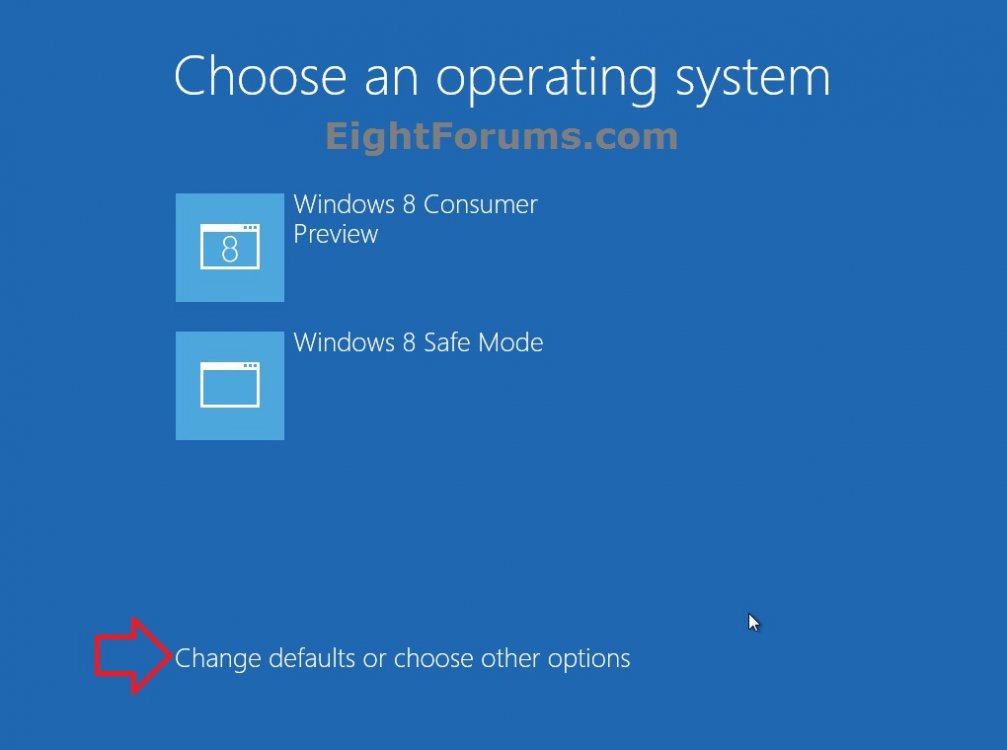

Boot to Advanced Startup Options Menu if Multi-Booting
You will only see this option if you added Windows 8 Safe Mode to the Windows boot manager screen, and/or dual boot Windows 8 with another OS (ex: Windows 7 or Vista) with Windows 8 set as the default OS to run at startup.
1. Start or restart the Windows 8 computer.​

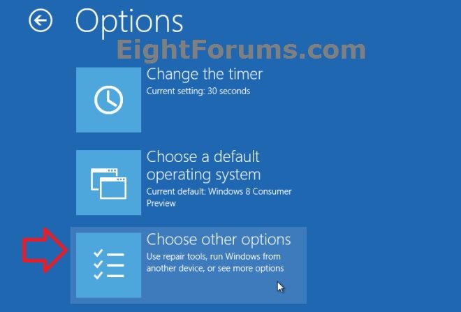

2. Click/tap on Change defaults or choose other options.​
3. Click/tap on Choose other options in the screen below.​
4. You are now in the Startup Options menu at boot where you can choose what option you would like to do.​

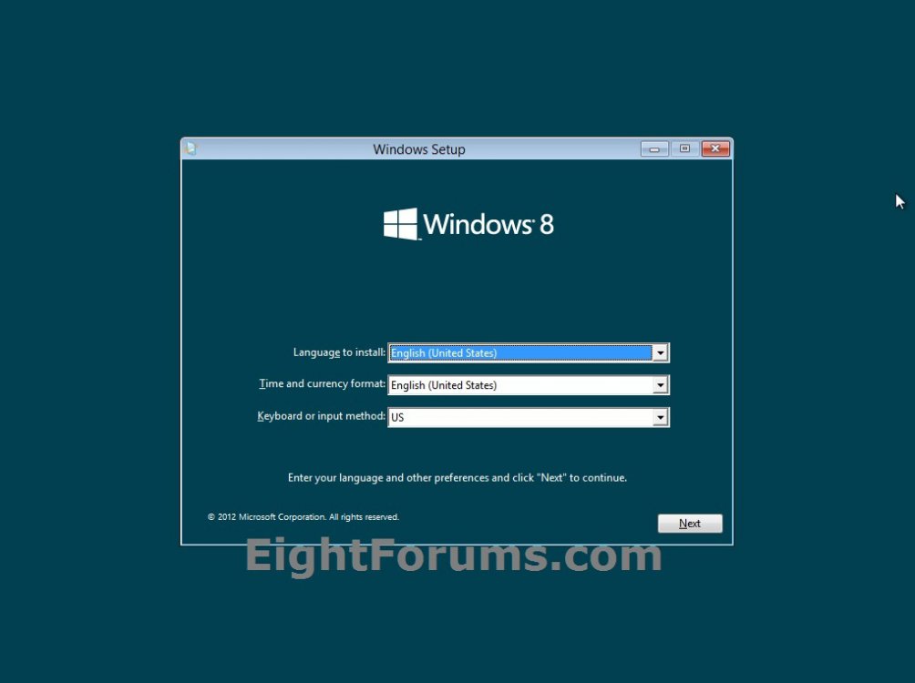

Boot to Advanced Startup Options from Windows 8 or 8.1 Installation Media
NOTE: You will not be able to boot to the Advanced Windows "Startup Settings" screen using this option.

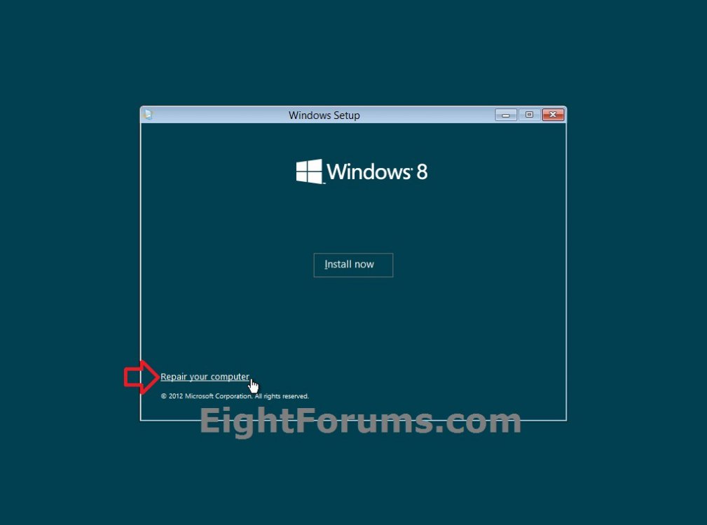

1. Boot from your Windows 8 installation DVD or USB thumb drive, or ISO file if in a virtual machine.​
2. Select your language preferences, and click/tap on Next. (see screenshot below)​
3. Click/tap on Repair your computer. (see screenshot below)​
NOTE: You will only see the Use another operating system option if you dual boot Windows 8 with another OS (ex: Windows 7 or Vista) with Windows 8 set as the default OS to run at startup, or added Safe Mode to the Windows Boot Manager. Some OEM computers will have a Use a device option.​

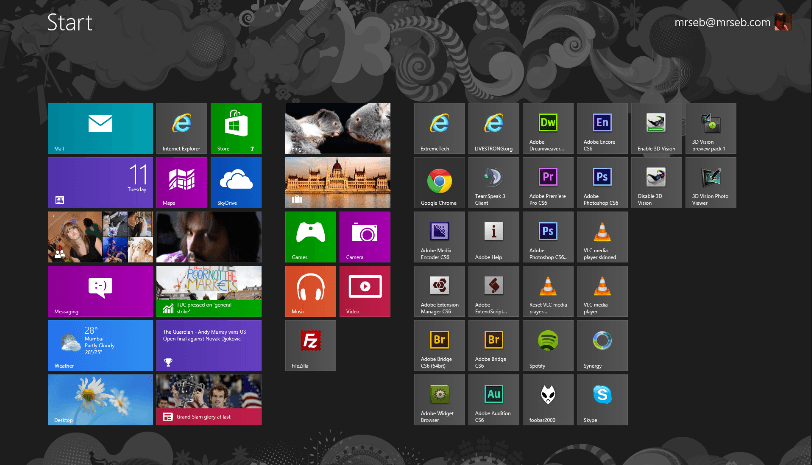

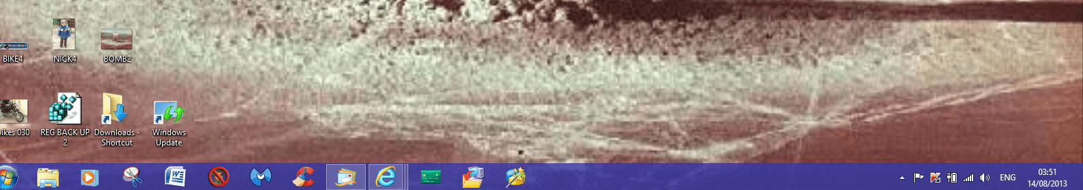

Shawn I am getting pic 1 as the Stardock8 desktop screen and when I go to the pop out menu at the right side of the screen and pick the 8 logo I get a screen very similar to pic 2 and I don't know where to go in the Metro sceen for that Choose an Option in the tutorial.
I cannot get it to add attachments mate have tried twice now they say they are uploading but come posting they do not show up.
The shortcut I posted above should restart your PC to the "Choose an option" (Advanced Startup Options) screen for you if you like.
I don't know what pic 1 and 2 you are referring to. Are you able to do OPTION THREE through PC settings to restart the PC to the "Choose an option" (Advanced Startup Options) screen?
If able, please go ahead and post a screenshot showing this to see if it may help ID the issue.
Hello Shawn the World Champion Gung Ho Idiot here I tried downloading that blue file and it went straight into that screen when I opened it from downloads:o
Why the pics did not upload well they uploaded but did not attach I have no idea??
Hmm even doing that from my main desktop now - any suggestions please??
