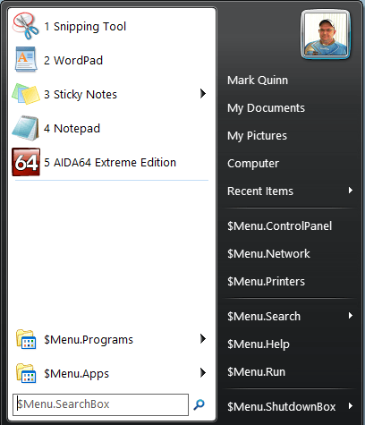

I just updated to 3.6.8 and now no matter which start menu style I choose it's showing $Menu. I'm not using Windows 8.1. Could that be why?
Looks like the file ClassicStartMenu.L10N is missing or corrupted. Uninstall and install again.
