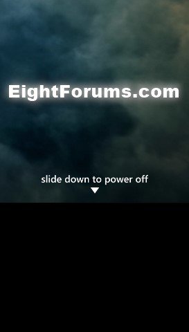

1. Press and hold on the Power button until you see Slide down to power off. (see screenshot below)​
2. Slide or flick down the Slide down to power off screen. (see screenshot below)​
3. The phone will now say goodbye as it powers off. (see screenshot below)​

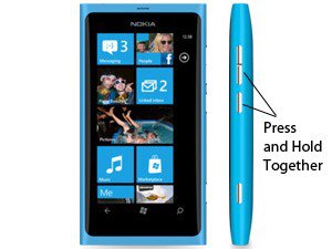

  • Press and hold the Volume Down and Power buttons at the same time until you feel a vibration (about 10–15 seconds). Your phone will restart automatically.
    • Sometimes your phone will vibrate right away when you press the Volume Down button and Power button buttons—this is probably due to your ringer changing to Vibrate. Wait to release the buttons until a second vibration after 10–15 seconds.
    • If you don't let go of the Volume Down button and Power button buttons right after the vibration at 10–15 seconds, your phone may show a black startup screen and not restart normally. If this happens, just repeat the button combo to try again.
