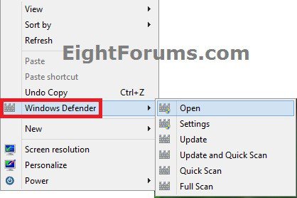

This tutorial will show you how to add or remove a cascading (expandable) Windows Defender menu to the desktop context menu for all users in Windows 8 and 8.1 to be able to quickly open Windows Defender to settings, update, update and quick scan, quick scan, or full scan.
You must be signed in as an administrator to be able to add or remove this desktop context menu, but all users are able to use it.
EXAMPLE: Windows Defender Cascading Desktop Context Menu

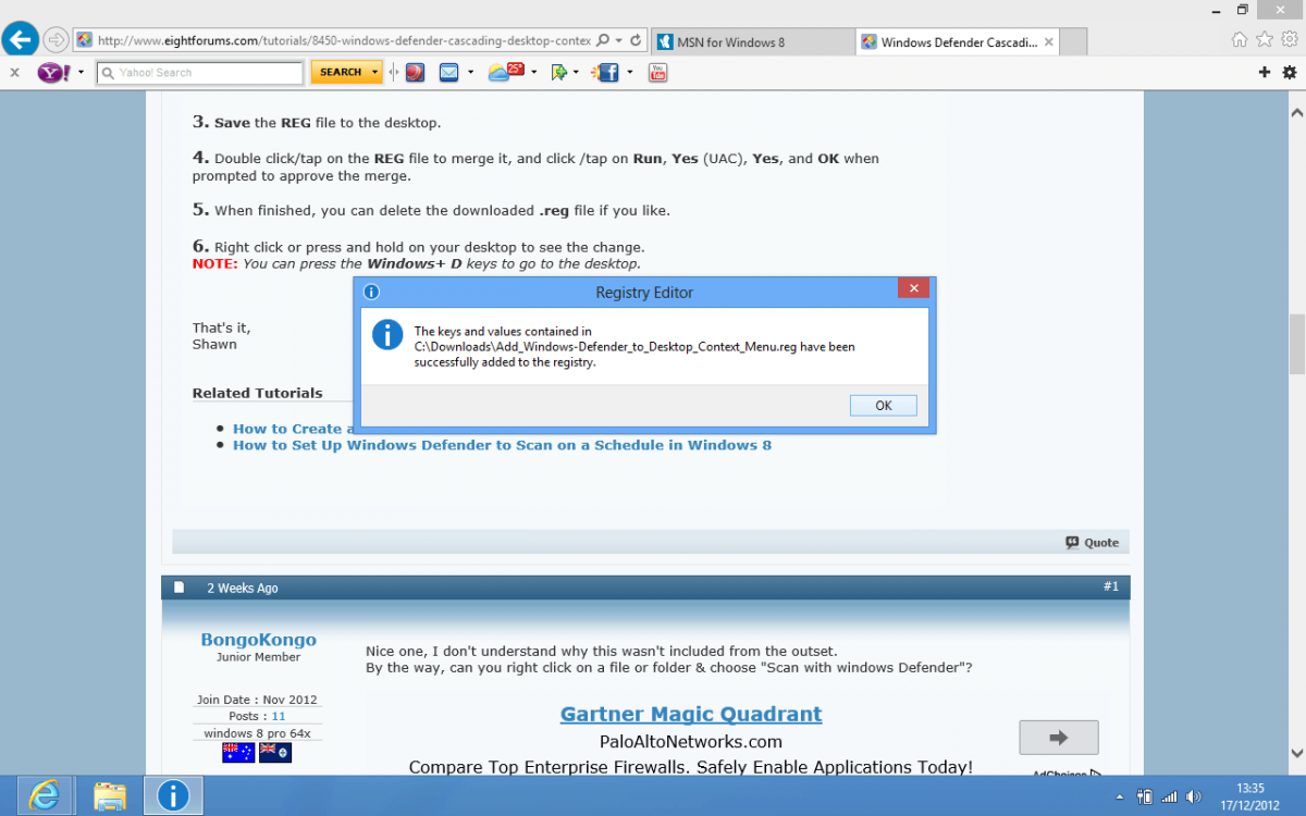

3. Save the REG file to your desktop.
4. Double click/tap on the REG file to merge it, and click/tap on Run, Yes (UAC), Yes, and OK when prompted to approve the merge.

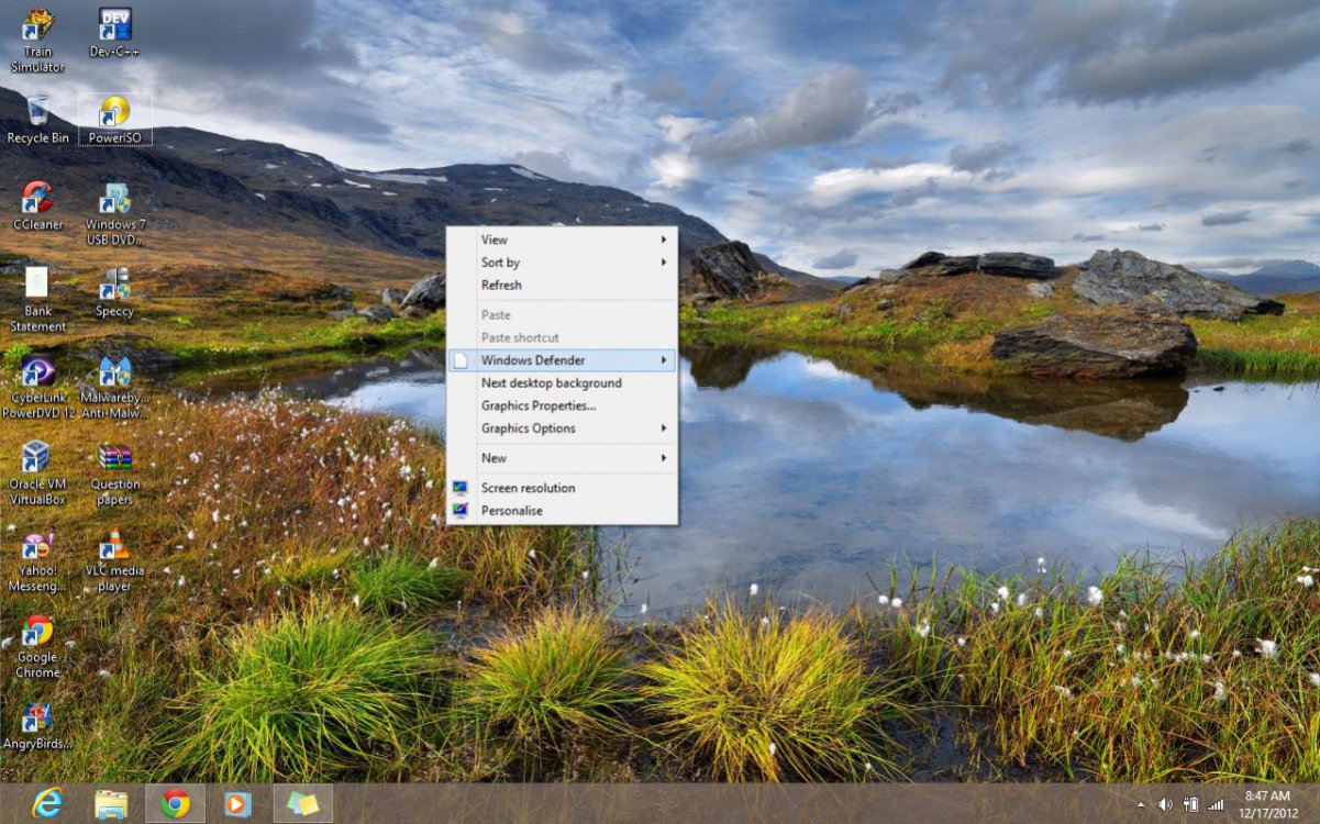

Nothing shows up when I move the cursor to windows defender
Hello Bagavan,
Were you signed into an administrator account when you merged the .reg file?
If so, merge the .reg file again to make sure that you clicked on Run, Yes (UAC), Yes, and OK in step 4. If you mistakenly didn't approve one of these prompts, then it will not work.
Hope this helps for now. :)
It sounds like part of the .reg file did not merge with your registry for some reason.
If you could, edit the .reg file, then double check in your registry to see if those entries have been added or not. Afterwards, please post back with what wasn't added. I'll see what I can do to help. :)
I wouldn't think so since it's not an application/executable file.
For the entries that you find didn't merge, I was going to get you to check the permissions of the keys to see if there may have been some sort of permissions issue that prevented parts of the .reg file from being merged.
By default, the .reg file should of had full permission to do so once you did step 4 to approve.
There are several entries in the .reg file. It looks like some of them didn't merge for you.
It could very well merged enough for the context menu to show, but not enough for the submenus.
If you could double check your registry to compare it with the .reg file to let me know what wasn't merged, that would help out a lot in figuring out what may have gone wrong for you and hopefully getting it sorted. :)
bagavan,
I'm going to say it wouldn't be a good idea for you to go poking around in your registry if you are not familiar enough with it. It's just not worth the risk of you mistakenly doing something in there that could hose your Windows 8 installation.
Instead, try enabling the built-in Administrator account, sign in to it, then try merging the .reg file being sure to click on Run, Yes (UAC), Yes, and OK at step 4. If you click on No or Cancel by mistake (and it's easy to do), then the .reg file will fail to merge completely.
I enabled the admin account and I ran the reg file.
but still the problem is not solved.:(
