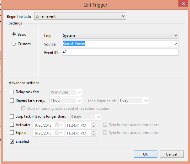

I am not sure if this would be applicable for your case, but Task Scheduler can solve your problem.
Just add a task for your script, select "Run as Administrator", enter your credentials and it will run it silently with no popups with admin rights.

Sorry for the confusion. Yes, it is possible to schedule this app to run and establish the connection. This is used mainly by my sales staff. I could set the schedule to run at startup and establish the connection. However, when the laptop goes into sleep mode (multiple reasons why) and awakens, the connection will no longer be established. If the user booted their laptop while disconnected from the Internet, the connection would fail as well. My users have also been instructed to disconnect from the VPN when they know it will not be in use. I don't want them to have to reboot or log off/on to re-establish.
