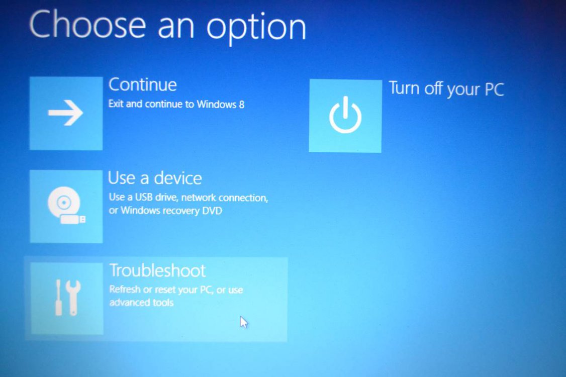

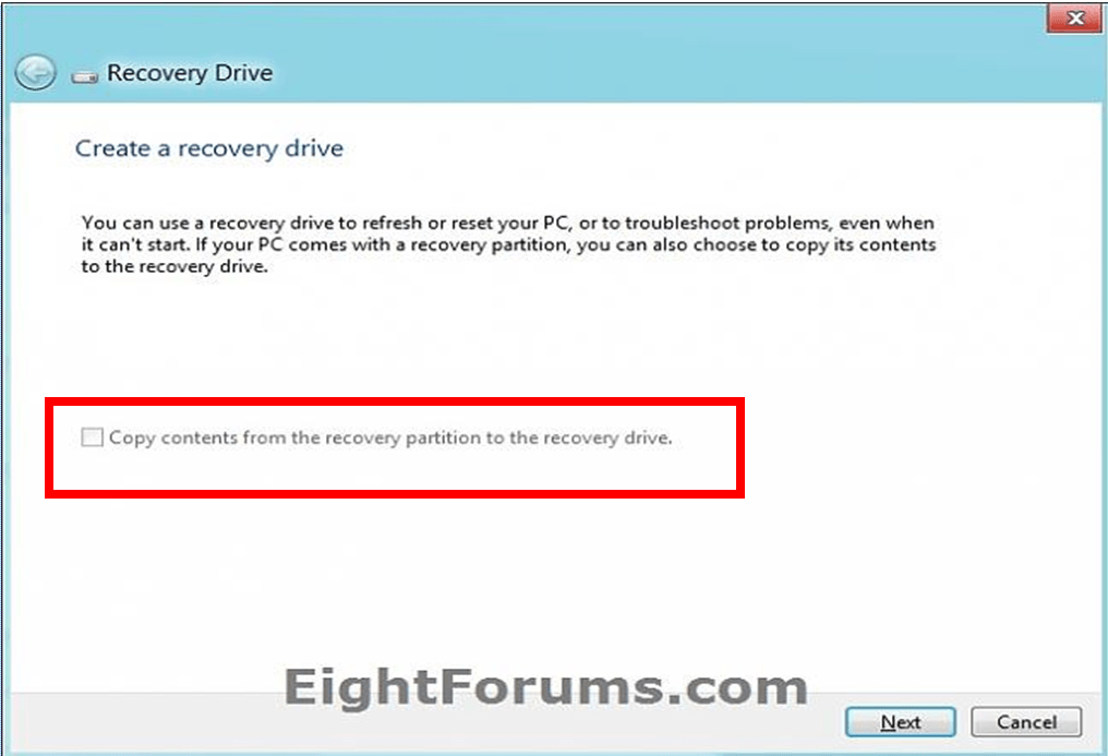

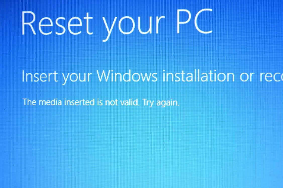

well i did copy the partition using the checkbox but im not sure its working. Yes, the recovery flash drive appears in the "use a device" option but when I click on it, it sends me back to advance options screen. when i try to do the restore option from there, it says the media inserted is invalid.
another thing. after i copied the recovery partition and rebooted, the drive i assign on the partition was gone and it went back into being hidden. is that alright?

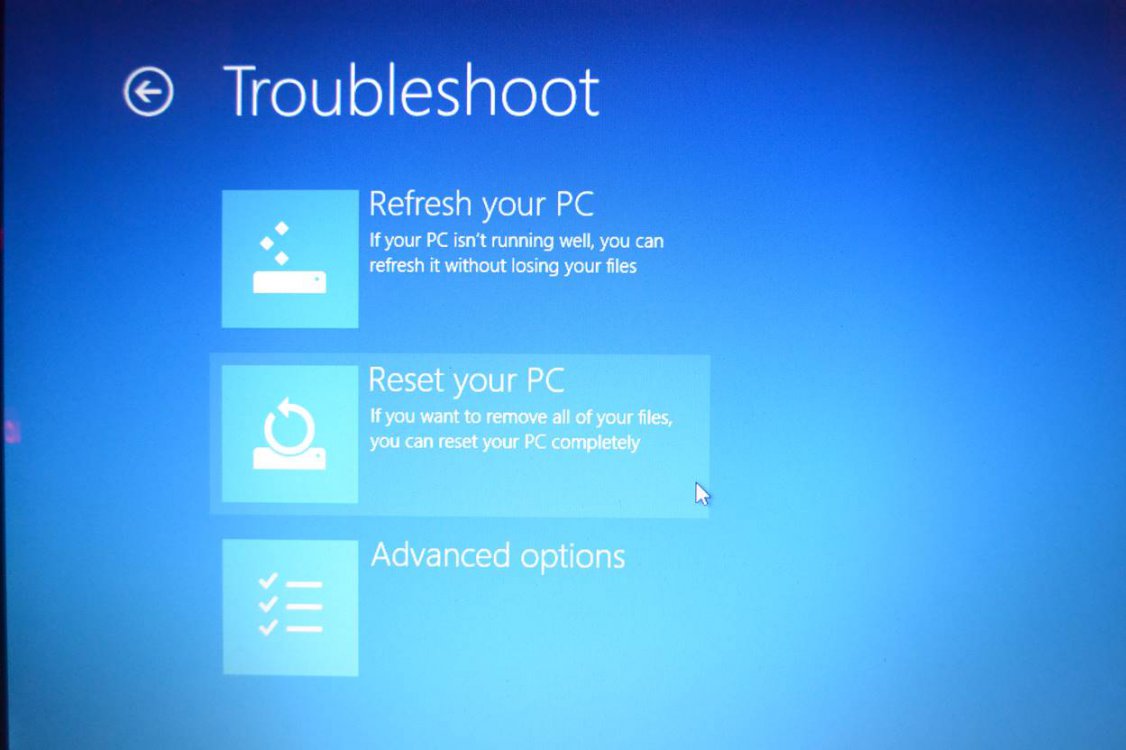

jgcvaleroso, from the owner's manual for that computer, it shows several Recovery Options for your system.
They all start with hitting F9 after a restart and being able to get into those options. And a Restart and Start for powered down may not behave the same way.
First you should have a Refresh option, which you cannot do because you do not have the Windows 8.1 Source files.
Then you have the Reset, which should work since you have registered the 8.0 image. The Fully Clean the drive option should reinstall Windows 8 from that registered image and set your system back to a Factory condition. So far the external drive has not been required.
There are also other Advanced Options, but I will assume you just want to Reset right now, which will remove all of your personal files.
Please be specific in choosing words describing what process you are using, and be as accurate and complete as possible in describing the result and any messages of that action.
So, you restart your system and hit F9 to access the recovery options. You then select Reset and Fully clean the drive. Does the process work to this point? What happens if it tries to Reset the drive? You could try the "Just remove my files" option, but that might lead to a version conflict with 8.1. Of course the Fully clean option may also lead to the same situation.

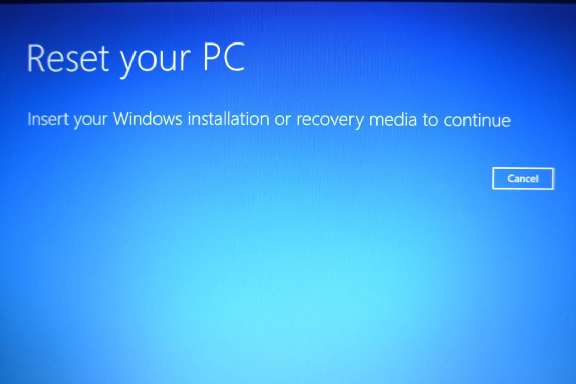

Okay, so after I selected the "Reset your PC" option, its moves to the next screen which tells me what will that option do. After clicking Next, it will load up a bit and then it will ask for a boot media to continue. Thats about it. I'm stuck at that point.

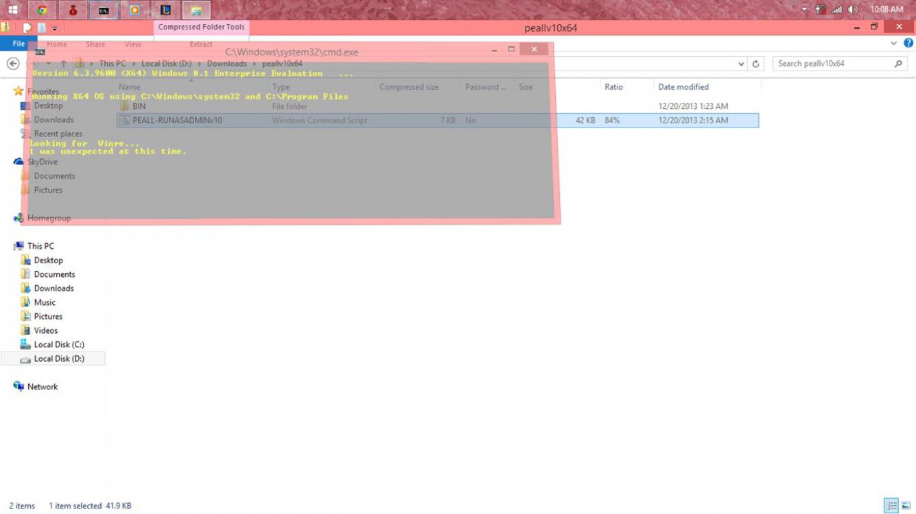

what do I do after downloading peallv10x64.zip ?
when I run the PEALL-RUNASADMINv10.cmd, a command prompt with yellow appears and then disappears instantly.
install partition is the partition you want to install onto.
Strange the peall-etc.cmd isn't working. It works fine for me.
I have been trying some things, and in this situation, the only thing that showed as valid media was an Install flash drive. Plugging it in resulted in an immediate check and was shown as being valid. So it seems the image on the recovery flash drive or the one in the Recovery partition are not usable for some reason, possibly version differences.

It is better to extract it to the root of your drive, e.g. c:\peallv11x64. Your "desktop" will have very long paths. It should have offered to create an .iso file
If the iso folder was populated correctly, then you can copy the contents onto a flash drive that has been formatted ( it should be formatted fat32 if you are using uefi boot )
This created an file in my desktop named "ISO" so I'm assuming it worked. Thanks for that.
Do I burn this on a CD or is there a program inside that I just need to launch?

@SIW2 Okay so I transferred the BIN folder and the Command Script file to C:\ and launched the script. Here's exactly what I did next:
I reformatted my external drive (the one with the copied Recovery Drive) to FAT32(default)
then I opened the ISO file that came out in C:\ and copied the contents (BOOT, EFI, sources folder) to my external drive. (I copied the files inside and not the whole ISO folder)
in BIOS, I set my external drive as boot priority #1 then saved and exit.
after that, my laptop booted normally so I'm assuming I'm still in my normal windows environment.
