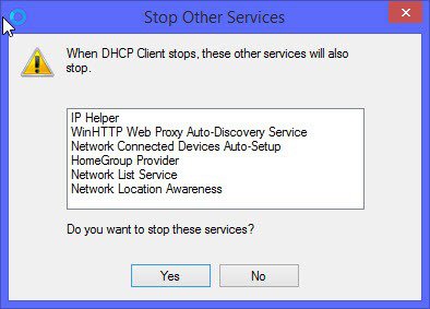

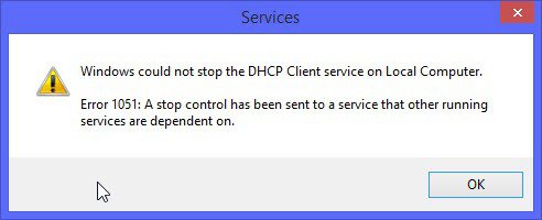

The Lenovo (older machine) gives me this message when I try to stop/restart the DHCP service:
In case you can't read it, it says: "Windows could not stop the DHCP Client service on the local computer. Error 1051: A stop control has been sent to a service that other running services are dependent on."
Sometimes I get this one error message: "Windows could not stop the DHCP Client service on the local computer. Error 1053: The service did not respond to the start or control request in a timely fashion."
These are the dependent services:
The only dependent services (to the DHCP) which are running when the computer first starts (and when I can connect) are:
Network List Service
Network Location Awareness
Once the connection fails, the following dependent services (to the DHCP) are running:
IP Helper
WinHTTP Web Proxy Auto-Discovery Service
Network Connection Devices Auto-Setup
HomeGroup Provider
