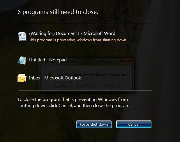

When user processes (tasks) do not end (close) automatically (AutoEndTasks) at sign out, restart, or shutdown, the system waits until the process ends on it's own. If the process hasn't ended by the set HungAppTimeout value, the End Task dialog box appears, stating that the processes are not responding to the End Task request and prompts the user to either force sign out/restart/shut down and force close (end task) the non-responding processes OR to cancel sign out/shut down to return to Windows.

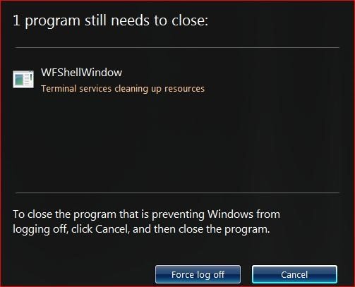

EXAMPLE: Force End Task Dialog at Shutdown

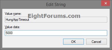

5. Type in a number for how many milliseconds you want to have for the HungAppTimeout value, and click/tap on OK. (see screenshot below)
The default value is 5000 milliseconds (5 seconds). You could also delete the HungAppTimeout string value, to have it use 5000 milliseconds by default as well.
It is recommended to not set a value below 1000 milliseconds.
1000 milliseconds = 1 second
60000 milliseconds = 60 seconds (1 minute)

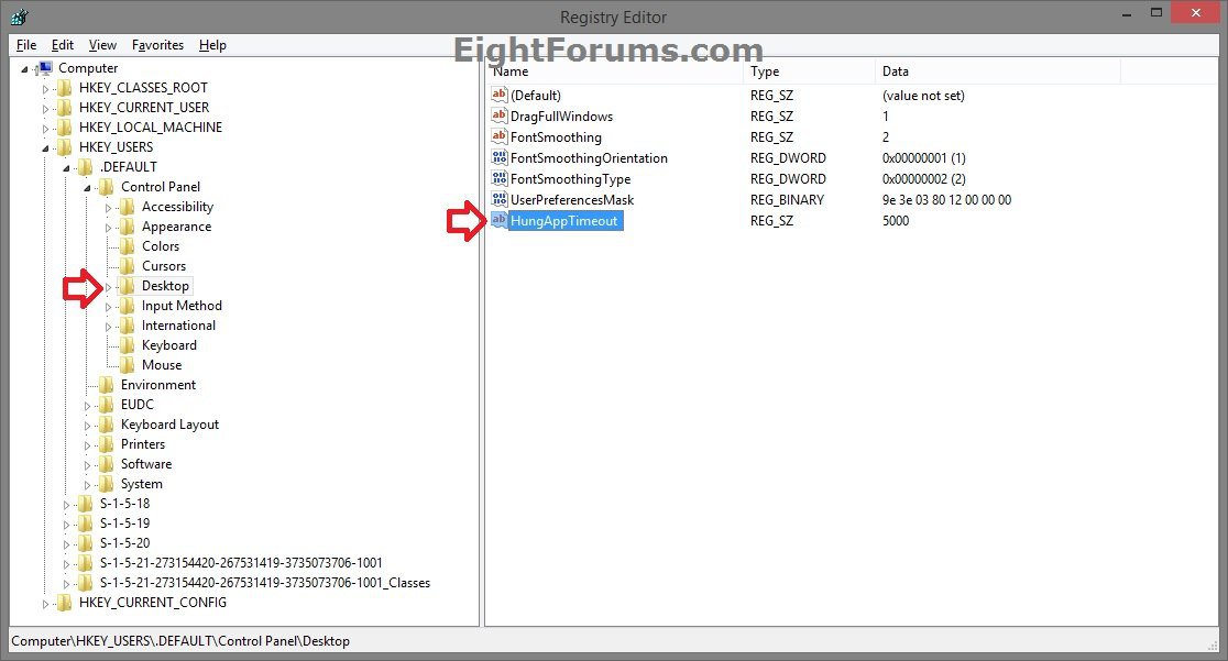

1. Press the :winkey: + R keys to open the Run dialog, type regedit, and click/tap on OK.
3. In regedit, navigate to the location below. (see screenshot below)
HKEY_USERS\.DEFAULT\Control Panel\Desktop
4. In the right pane of Desktop, double/click tap on the HungAppTimeout string value to modify it. (see screenshot above)
If you do not have a HungAppTimeout string value, then right click or press and hold on an empty space in the right pane of Desktop, click/tap on New and String Value, type HungAppTimeout for the name, and press Enter.
