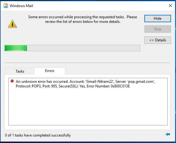

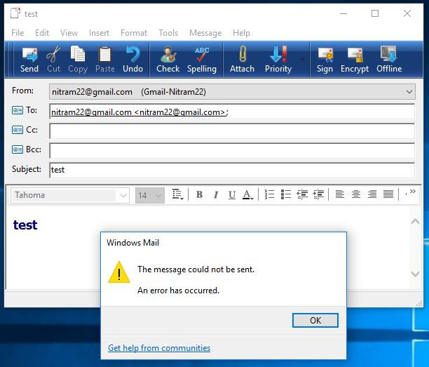

I tried the 10 steps again endeavor still didn't work but everything looks perfect. I'm doing something wrong but I'm not sure what. I should have backed up like you said. I guess I'm just a 60 year old dope.

It looks like your WinMail Account settings perhaps got over written. Go to:
Tools> Accounts> yours ..and then click properties on it, and go over each tab making sure nothing has changed.
What you say <g> ..you mean you don't have all that written down or taken a screenshot of it to use at a moment like this <g>
It's all up to each individual to have a backup plan.
..but it sounds like your account info or setup info of some sort with gmail got overwritten in the upgrade - put it back <g>

I finally got it working again. You were right about the gmail getting overwritten. I actually did backup my Windows Mail folder from AppData and replaced the new one with this. This must have caused the send and receive to break. I don't know why. I put in my Gmail manually and it now works fine. Thank you endeavor for your help.
Nice job, and good work chasing it down, and winning. I'm proud of you!

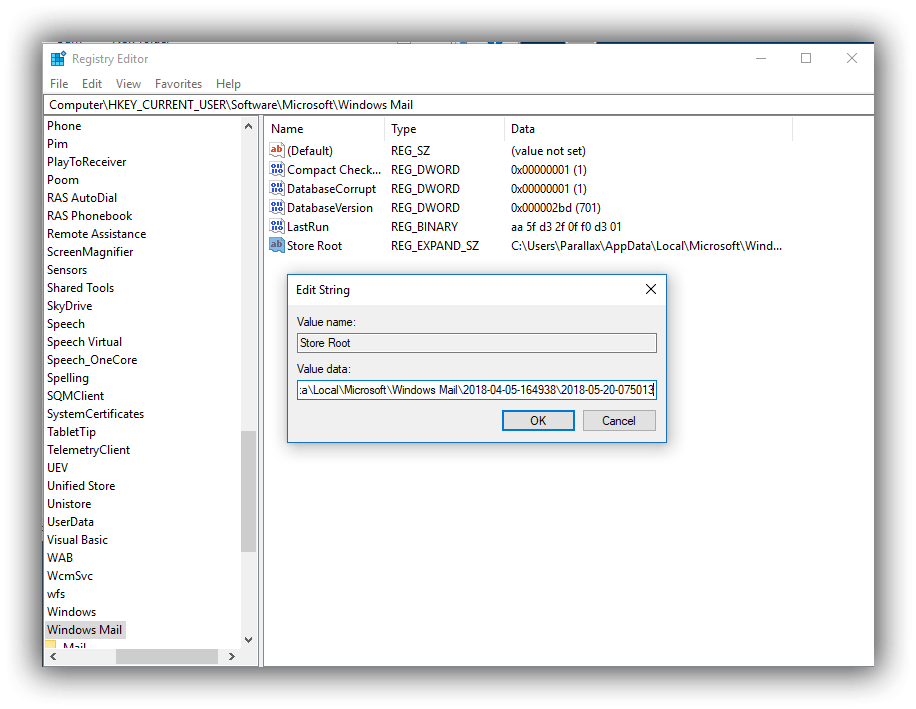

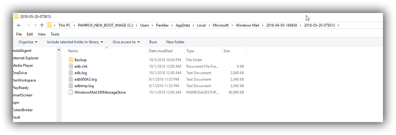

Sorry about not providing not enough info. Attached here the 2 screenshots you requested.
I am actually trying to create a fresh empty mail where I can create the account from scratch. Or I can import my existing mails should I choose to. In whichever I choose I need to get winmail to open up. :)

You still did not type enough information, however from the screenshots I can glean some (but not enough) to see some issues of why this is happening. You have these dated recovery folders, the ones I can see anyway that are 2018-04-05.... etc, etc, ..and they are replicated into your registry store folder location as well. This is Not ideally, normal.
I can't tell, and you did not say, what the source was that you brought your store folder from? A different Computer, and/or different OS, etc. Was it fragmented liked this in the source? etc, etc, or was it a fresh install?
A normal WinMail store folder will have all of it's files in the main store folder directly under Windows Mail folder; iow, not placed as subfolders within these other dated recovery folders - this is not normal and doing a fresh install of Win10 and a fresh re-instate of WinMail will never do this either. This is an issue that happened by something you did and/or by store folder corruptions, etc, caused by various...
If I was there with my hands on your keyboard I maybe could reconstruct and salvage your accounts, etc, by selectively reconstructing and deleting - but it's too much to walk you through it typing like this, darn it, I don't like doing things this way; but I'm not there, so let's make this quick since You asked for a fresh WinMail start. I'm hesitant even to have you do this because I am not able to tell how computer savvy your are and I don't want to be responsible for your stuff. I'm not though you are! I don't even know if you correctly did the page 1 & 2 for you v1709..
..but if You really want to start from a WinMail scratch... (actually it'll be less than scratch)

I still have my old boot disk which I export the original registry. Import it to my new OS it still the same. Take note that my old setting the mail folders are in my E: which is the same drive as my new OS is looking at. However I noticed the store file is also at some back folder with a date. The old boot disk winmail is not working anymore when Win10 suddenly forced an update to my system effective killing it. That strange date folder could be created when I tried to launch it. I guess the main issue here is how to get a working store file because it keep asking for one regardless if my folder is empty or not. It won't create a fresh one. I have attached my original registry here you can take a look. Thanks.
