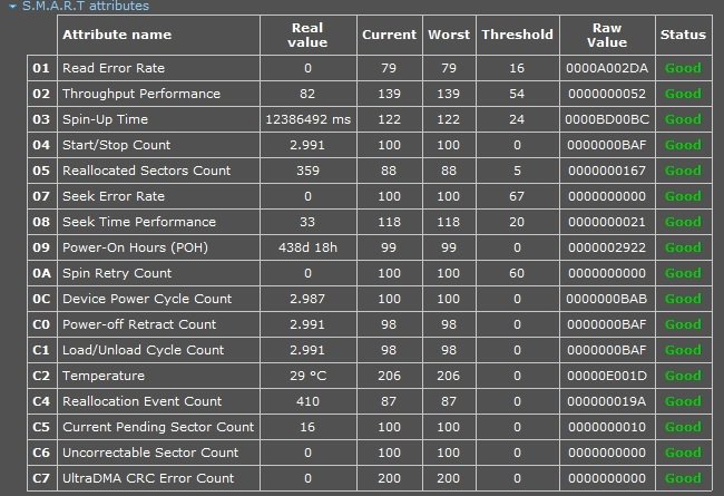

Good day,
To my surprise, when looking at the log events, I noticed 74 error logs starting from 27th of April saying "Bad block found in device /Device/Harddisk0\DR0
From what I know (although I'm not sure) you can look up the number of the disk in Disk Management and I found that "Disk 0" seems to be my main harddrive. Which is a Hitachi HDS921010DLE630
I used Speccy to retrieve the S.M.A.R.T. data wich are shown in the attachment.
Here's the problem; according to Speccy, these SMART data shouldn't be of any concern since it shows "Good" in all attributes. Although it's all considered "Good", it does show the status as "Warning". The temps are good (29 degrees)
Perhaps someone with more knowledge on this could interpret these results better?
Performing checkdisk also shows that there are no issues nor bad sectors found.
What could be the cause here and should I be worried? Could this by any chance be a false positive and if so, caused by what?

I have indeed made a backup of my wanted data. Is it that serious? How come Speccy say that everything is fine?
Well, it's possible that I am overreaching the seriousness, I do not know where on the continuum is Speccy's HD report. For a second opinion, download, install, run Auslogics DiskDefrag's SMART section, see what it says. If both report green, all might be well. Please keep your backups current. :) Perhaps, others in eightforums.com will enter in and give their advice.
I recommend you open an elevated command prompt and run chkdsk /r on the drive. When prompted to allow chkdsk to run at next boot, follow the prompts to allow that, then reboot. Depending on the size of the drive, this process could take many hours (even overnight) to complete, with the system often appearing to be frozen. Just let it run. If it finds errors it cannot correct, or if you keep getting errors in Event Viewer, I would start looking for sales on drives. Remember ALL drives WILL fail - eventually - especially those with moving parts.
Note that S.M.A.R.T. is not an industry standard so it is not always consistently implemented correctly on all systems. A S.M.A.R.T. error that cannot be corrected does typically suggest the drive's reliability is failing. But a lack of a S.M.A.R.T. error does not mean the drive is perfectly okay.
You might also go by the drive maker's own diagnostics utility HGST Windows Drive Fitness Test. Note that Hitachi is now part of Western Digital.

Thanks for the info. Something weird just happened. So I ran chkdsk /r at next boot and after it finished I let Speccy show me the S.M.A.R.T. data again and now it says that the HDD has 602 Reallocated Sectors Count (359 before), and 64 Current Pending Sector Count (16 before).
Could a chkdsk /r provoke such a thing? See the attachment for the log of the chkdsk /r.
The HGST WDF test you linked me to doesn't show my HDD in the list so I can't select and scan it with the program for some reason.

I'm considering to fully zero-write the harddrive to scan and see if it can reallocate the bad sectors.
I have a Hitachi HDD but I'm not sure which software to use for this. Any ideas on this?
chkdsk will attempt to repair any bad sectors. If it cannot, it will move any data there to a good spot, them mark the old as bad. If me, I would run it again.
Zero write does not do anything in terms of recovering any bad sectors. A full (not quick) will hit every storage location and if bad, mark it bad and unusual but of course, will delete any data you might want to keep.
The thing is, that there are an increasing number of pending sectors that chkdsk apparently can't seem to correct. Zero-writing would delete everything on these sectors (the HDD would "notice" that the data on it is irrelevant) and not use it in the future, at least that's what I read
about it.
What I want is to start fresh with data only on the working sectors and not have any pending ones. And see from there how it will go.

I fully agree with you and I love the analogy :P. I'm curious to see how fast the count will go up from scratch. Do you happen to know the limit of the number of reallocation sectors in a HDD?
about it.
No, you are confused. When you "zero write" a drive, you do just that, you write zeros to every single storage location on the drive. This "wipes" the drive of all data. That is exactly what DBAN does - it "wipes" the drive by writing a bunch of 1s and 0s to every storage location many times. This is to prepare a drive to give away so the next owner does not, and cannot find any of your data. Wipe programs are not diagnostic and repair programs.
The fact chkdsk cannot repair the drive tells me to get rid of the drive - it cannot be trusted any more. Especially since the number of bad clusters keeps going up.

My purpose was not to have any data in the bad sectors. By zero-writing it, the HDD will mark them as bad sectors and not use them for the coming time period if any new data is going to be written. Also, I wanted to reset Current Pending Sectors and see how fast it will increase from that.
I just zero-written the harddisk using the command prompt and after putting all my data back, Speccy is saying now that there are 0 Current Pending Sectors. Obviously, the number reallocation sectors has now increased but at least I don't have any data in any bad sectors as before (for now). Chkdsk is now also saying that there are 0 bad files while it said there was 32kb before.
Nevertheless, I understand that this doesn't fix the problem and that zero-writing doesn't repair the HDD (I just didn't like to have data in bad sectors) and I'm buying a new HDD in about 2 weeks or so. I have backed up everything in the mean time.
:( I don't get you. Why do you keep saying that? Three times (four now) I have repeatedly told you that is NOT how zero-write programs work. They are not diagnostic tools. They don't mark sectors as bad. They just wipe (over-write several times) any pre-existing data so the next owner can not find any of your data. Full (not quick) formats, chkdsk /r, and some diagnostic tools will mark sectors as bad, but wipe (zero-writing tools) do not.
