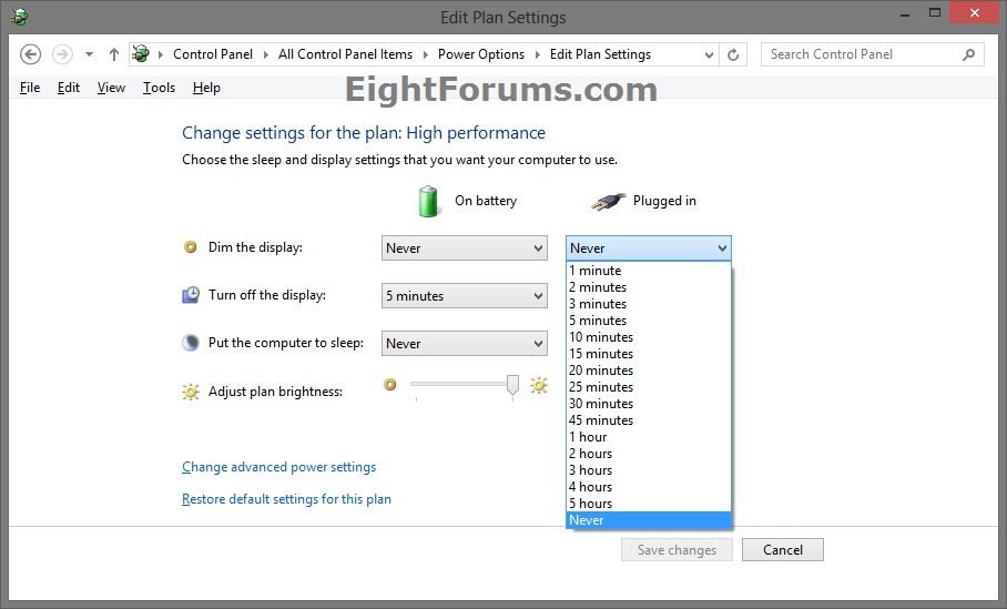

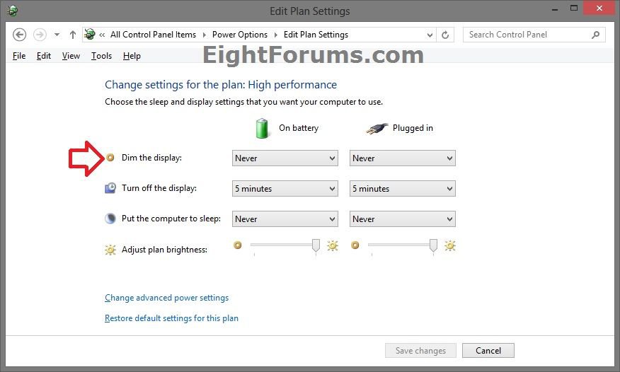

A) Set Dim the display to Never for when you are On battery and/or Plugged in for what you want, click/tap on Save changes, and go to step 4 below. (see screenshot below)​
3. To Turn On Dim Display
A) Set Dim the display to how many minutes you want the PC to be inactive when On battery and/or Plugged in before the display brightness is automatically dimmed, click/tap on Save changes, and go to step 4 below. (see screenshot below)​

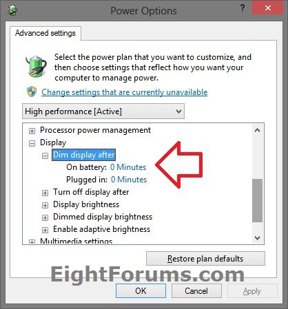

A) Expand Display and Dim display after, set On battery and/or Plugged in to 0 Minutes, click/tap on OK, and go to step 4 below. (see screenshot below)​

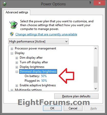

A) Expand Display and Dim display after, and set On battery and/or Plugged in to how many Minutes you want the PC to be inactive before the display brightness is automatically dimmed. (see screenshot above)​
B) Under Dimmed display brightness, set On battery and/or Plugged in to specify what brightness percentage level you want for when the display dims, click/tap on OK, and go to step 4 below. (see screenshot below)​

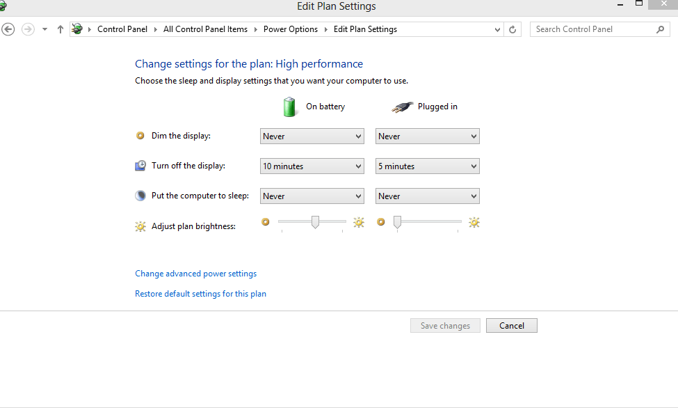

Ok Shawn this is two shots of my set up when a I first go to the options the control does not work. Then after a while it springs into life.
Now you can see that my brightness control work sin reverse but this machine ahs always been like that even with just seven on it.
When it was just seven the screen used to cut out but now it blazes away non stop.
I did try running a sfc but it would not do it and chkdsk that is totally alien to me now runs so fast it surely doesn't have chance to check the disk??
Oh dear it isn't letting me upload snips but my settings are never and never 10 mins and 5 mins and never and never:confused::confused:
John,
I noticed that you have your "Dim the display" set to "Never" for both "Plugged in" and "On battery" instead of the 1 minute "On battery" you said.
What do your screens look like with OPTION TWO?

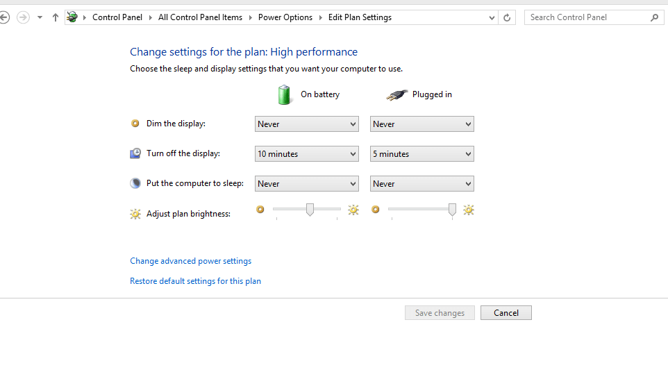

First, I went to the Power Plan settings (I actually did this several weeks ago as my first attempt at fixing the problem). I changed Dim the Display to Never when the computer is plugged in and set the plan brightness to max (see screenshot below).

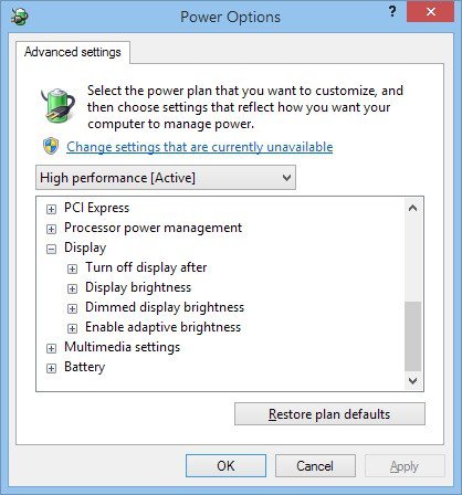

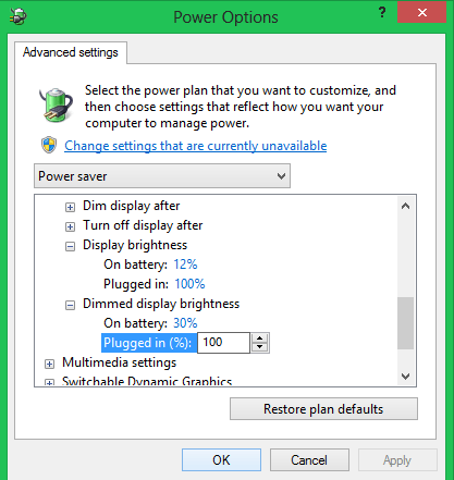

That didn't work and about a week or so ago I finally got annoyed enough to try again so I went back and had a look at the advanced power settings. I checked under "Dim the Display After" to make sure it said "Never" here like it does on the previous page. Check. Next I looked at Display brightness > Plugged In and it was set to 74% so I changed it to 100% and clicked Apply then went to Dimmed display brightness > Plugged In (just because I'm thorough like that) and set it to 100% also. Clicked Apply then Ok etc. (see screenshot below)

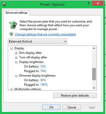

The didn't work so tonight I went hunting once and for all to find answers on the all mighty internet. I found your threads suggesting the precise actions that I'd already taken so I went back and double checked them because I know that 99% of computer problems are user error (I do tech support, ironically enough). Imagine my somewhat irritated surprise to discover that Display brightness > Plugged In was back to 74%. I mentally kicked myself, set it back to 100% clicked Apply and the screen lit up for about 2 seconds then went dim again. I went back to the Display brightness > Plugged In and it was back to 74%. I repeated these last few steps about 8 times before I decided that there must be some other unholy possession that is turning my computer against me and went searching for yet more wisdom on the subject. (see screenshot below)

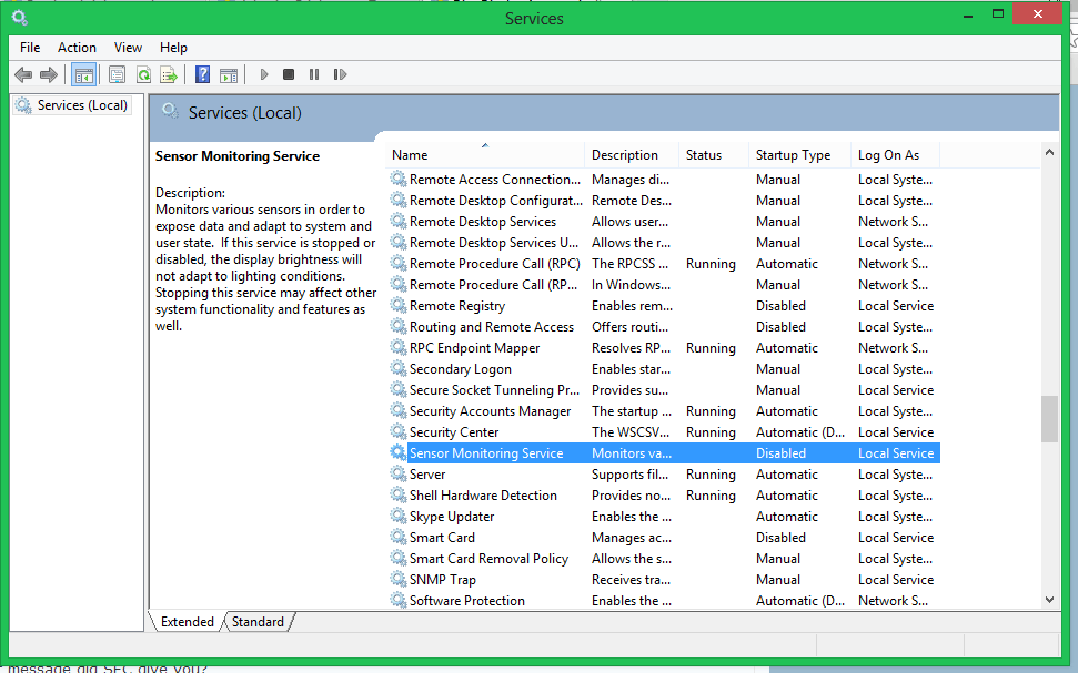

Next I found a thread where you had suggested the services.msc run command to disable the Sensor Monitoring Service so I followed those step-by-step instructions, gleefully positive that this would solve the issue once and for all. I disabled the service completely (it was on manual to begin with but oh well, disabled sounds more finite and promising for what I'm trying to accomplish). Went back to my power saving options and double checked to make sure the screen brightness was at max ... and the screen dimmed itself on me yet. again. I rebooted the computer, went back in to adjust 74% back to 100% clicked Apply then Ok and ... it dimmed itself back to 74%. (see screenshot below)

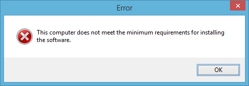

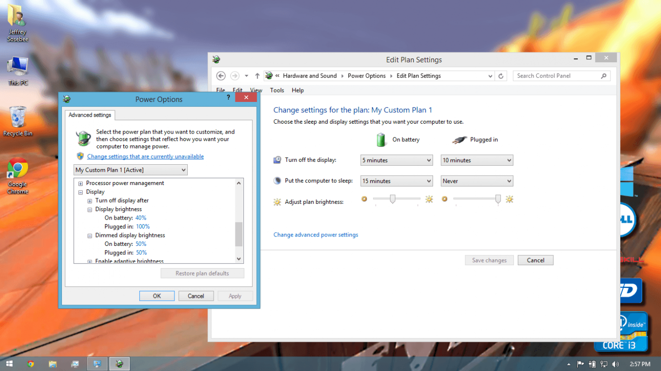

Tried installing the updated drivers and they still did nothing. In fact some of the updates broke more features, such as scrolling down pages with the trackpad. I tried to install driver updates to my WiFi but it failed, every time! Also, I had to manually fetch a compatible video driver from Intel's site rather than use one provided by Dell because that wouldn't install.
This laptop uses the Dell Extended Battery Life settings, which I can't get off simply using Programs and Features.
I also applied a BIOS update in there.
Some of the driver updates were date stamped ​10/9/2013

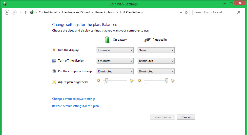

See what I meant? There are settings for "Dimmed display brightness" but there are no settings for "Dim the Display".
And for the same reason that seconds before the screen turns off, the display finally gets dim and then it goes dark.
