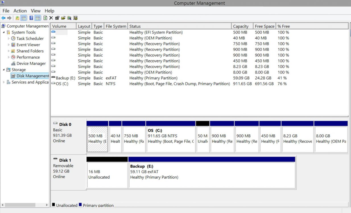

I have a Dell laptop running Windows 8.1 x64 with UEFI boot. I've been having problems with the Dell Backup & Recovery Utility showing errors. I've uninstalled and reinstalled the program but this results in additional partitions being created on the hard drive! I now have 10 partitions on the hard drive ( mostly small) - see the enclosed reports.
Is there a way of reconfiguring the partitions on the hard drive to the configuration of a standard Windows 8 installation without having to wipe the disk and reinstall everything? I have Paragon Partition Manager and Paragon Backup in addition to using the Microsoft utilities (DISKPART). Note the laptop operates normally despite the extra partitions.
DISKPART Report:
Partition ### Type Size Offset
Partition 1 System 500 MB 1024 KB
Partition 2 OEM 40 MB 501 MB
Partition 3 Reserved 128 MB 541 MB
Partition 4 Recovery 750 MB 669 MB
Partition 5 Primary 911 GB 1419 MB
Partition 10 Recovery 900 MB 913 GB
Partition 9 Recovery 900 MB 913 GB
Partition 6 Recovery 450 MB 914 GB
Partition 7 Recovery 8 GB 915 GB
Partition 8 OEM 8 GB 923 GB
  • Laptop Partitions.txt

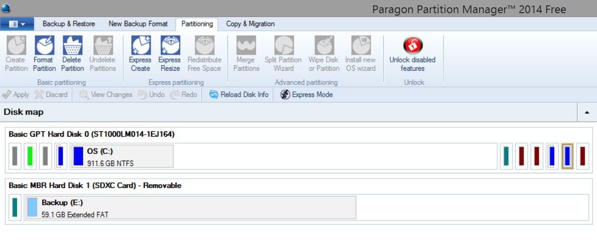

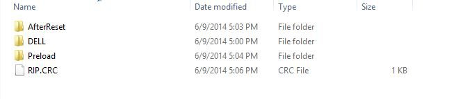

Many thanks for the above advice. Some of the volumes labelled as RAW by DISKPART are formatted and contain data when you view them in Paragon Backup.
My understanding based on the above advice and further information from Paragon Backup which shows more information partition by partition in the sequence reports by Paragon is shown below:
Partition 1 Vol P - 500MB ESP, FAT 32 formatted - Need to keep. It contains an EFI directory but no winre.wim
Partition 2 - 40 MB OEM/DIAGS, FAT 32 formatted. Only 512 bytes used. Should I keep this?
Partition 3 - 128MB, System Reserved. Should I keep this?
Partition 4 Vol Q - 750MB, WINRETOOLs, NTFS, 440.8MB used. Should I keep this since it contains data?
Partition 5 Vol C - Win 8.1, NTFS. Obviously keep!
Unallocated space 50MB - eligible to be used by the OS partition C:
Partition 6 Vol R / DISKPART Partition 10 -900GB unformatted. This can be removed.
Partition 7 Vol S / DISKPART Partition 9 -900GB unformatted. This can be removed.
Partition 8 Vol T / DISKPART Partition 6 - OEM Service Volume 450MB NTFS, 314.5MB used. Should I keep this since it has data or can it be deleted?
Partition 9 Vol U / DISKPART Partition 8? - PBR Image, 8.2GB NTFS, 7.4GB used. Should I keep this since it has data or can it be deleted?
Partition 10 / DISKPART Partition 7? - 8GB not formatted. This can be removed.

I tried viewing Q & T using the DIR command in a command prompt window but just get the error "The device is not ready". Is there a way of searching the volume/partition for winre?
Do I need both volumes Q & T? Can I delete T? If so, can I also safely delete Partition 10 then move Partition 9 to the end of the disk? This would enable me to merge all the free space with the OS partition.
