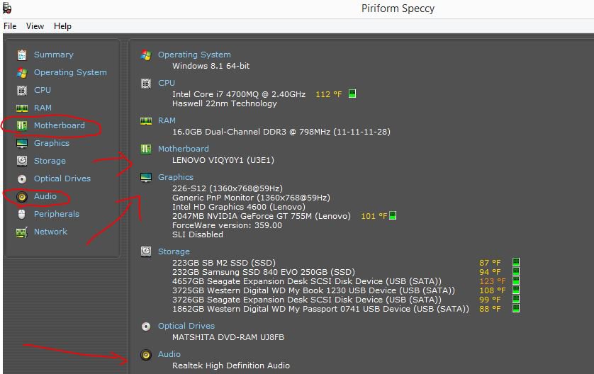

Try running speccy and put pictures here of your motherboard / audio/sound/video..

like this..
you save a picture with "Snipping tool"
then post like so..

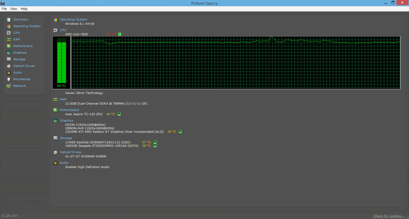

Jeez, according to "Speccy" my CPU is running between 77°C to 80°C at IDLE! I do have my PC set to high performance, but still. That doesn't seem normal. What do you guys think?
I have a feeling speccy may be reading that wrong, there have been a couple other posts with high temps like that on AMD APU's.

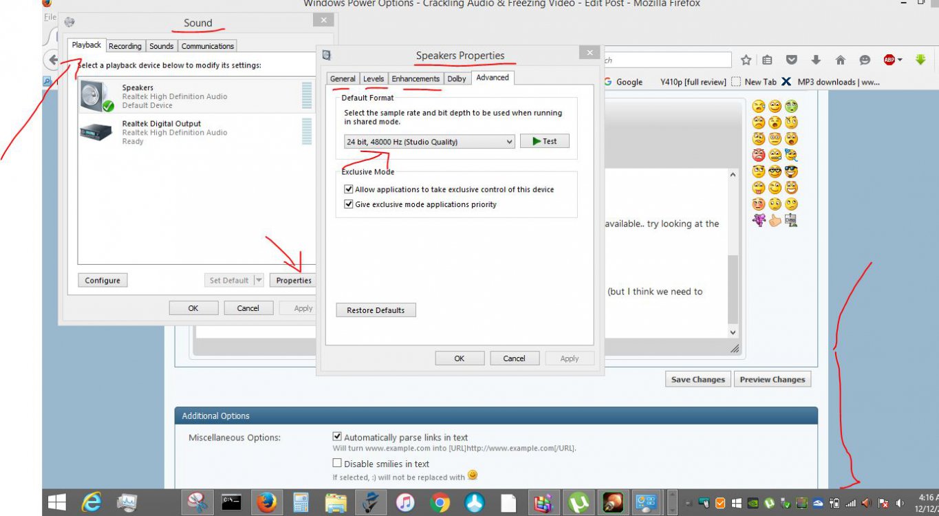

then you may have to start going into audio properties and see if changing these does anything.. (but I think we need to hear or see this crackling - do you have an iphone to record and post up here?)
Some people have had issues and set it to 41000hz..

Changing the hertz options in playback devices did nothing, by the way. Also, I'm not sure if I'll be able to record the crackling/freezing since I don't have a smartphone, or any other recording device for that matter.
