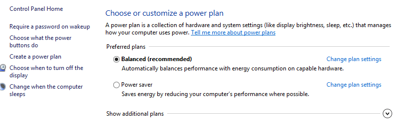

Since you haven't included anything but Windows 8 in your system specs, I don't know if your computer is a laptop or a desktop. With that said, have you been to the Power Options in the Control Panel?
If it's a desktop, this might be helpful. Click on the graphic to enlarge.
You should pay attention to "Choose when to turn off the display" and "Change when the computer sleeps". I think it's self-explanatory from there.
Wynona, I don't think you would get the on battery setting if it was a desktop tower ,I know I don't
