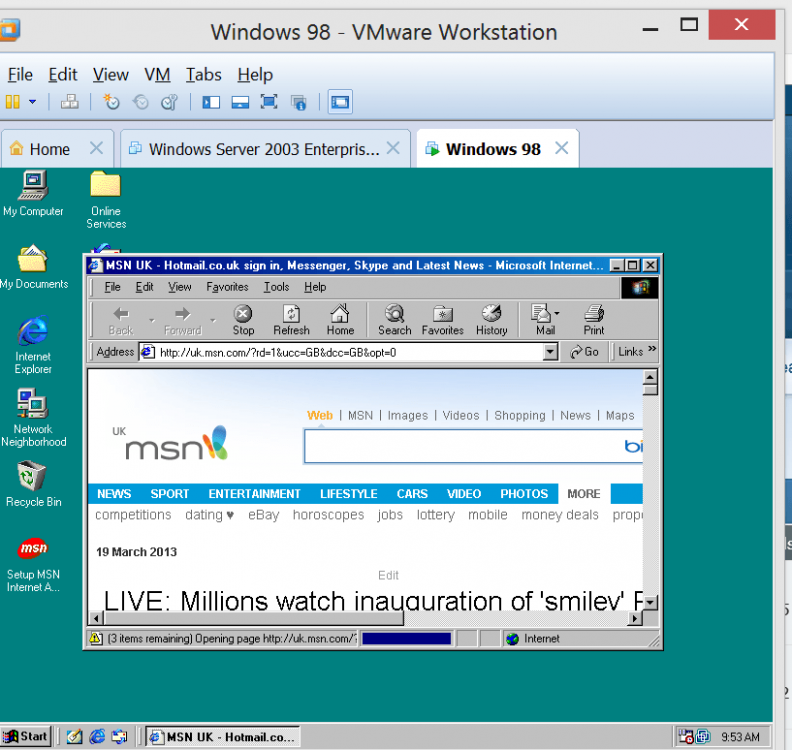

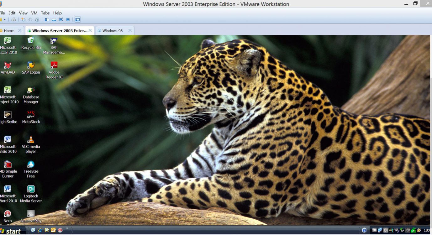

Have you thought about installing XP-X64 in a VIRTUAL machine. The latest version of VMWARE vmplayer is FREE and has decent graphics in it so things like DVD playing and even SOME (note not all) Games will work in a VM.
Typical legacy hardware devices don't have any issues with a Virtual machine and modern hardware will run a VM almost as fast as the "Native" machine.
An advantage also with VM's is that you can start / stop them at will - you don't need to logoff the Host system and it's also possible for people to logon to a VM without even needing an account on the host system.
(If this is not what you want then OK forget this post but all I'm suggesting is that I see this solution as a decent more convenient alternative). The XP-64 system will run quite nicely on a 3 GB Virtual machine - or even 2GB.).
The RAID on the host will work just fine and you can set the Virtual HDD's to SCSI if you want -- plenty of tutorials on setting up and using Virtual Machines on this Forum (and the W7 one too).
I'm running a Windows W2K3 server as a VM -- this has a load of VERY EXPENSIVE legacy ENGINEERING type laboratory hardware -- so I'm keeping it for a while yet. The manufacturer of the hardware has long since "disappeared" but the hardware works really well.
(I'm also running a W98 legacy system too -- even older). Both these run just fine even on a laptop -- so long as your laptop / system has at least 8GB RAM you'll be fine.
From my point of view this is a FAR better solution than keeping a dual boot system or a dedicated older machine.
BTW I'm using VMware workstation -- the paid product -- but these work from VMware PLAYER too -- the FREE product -- download from VMware site.
