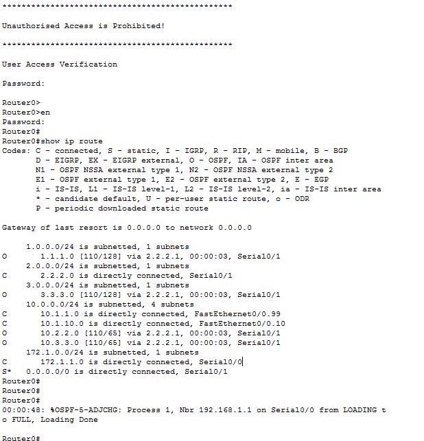

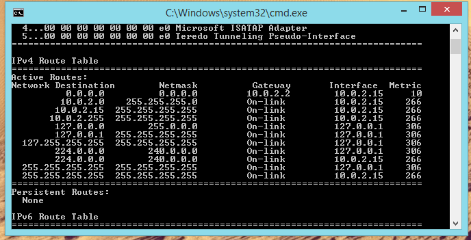

Are you able to show the routing table?, as this can better determine your problem The default route will only be used if there is not a match in its routing table (Also known as a Gateway of Last Resort).
To view the local routing table please type the following in a command prompt:
route print
If your machine is a host it should show your machine having maps from its loopback address to its IP address as well as broadcast and multicast addressing routes. At the top is the default route.
What you are talking about shouldn't cause you issues as routing tables are primarily used on routers. For example a picture of the routing table from my test network router is below:
