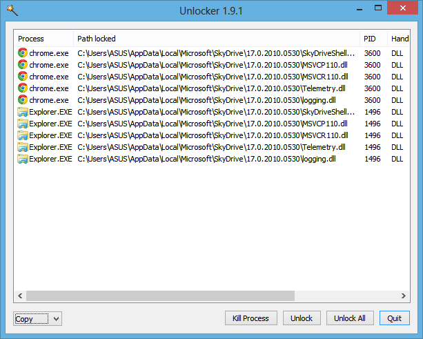

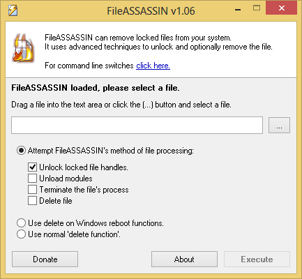

You also might try "Malwarebytes File Assassin" and see if it will unlock any locked folders and files and allow you to move them- I usually use "Unlocker" to do it, you can get it from Major Geeks. But the Unlocker Installer has a nasty virus embedded in the installer, you have to use advanced setup to bypass installing the toolbar it wants to implant into your PC.
With Unlocker, you can use the Unlocker Assistant to tell it to move the locked files, I've had to do it a bunch of times. you can copy the whole Users folders to another location.

Here's what you have to do with "File Assassin"
see if that works, if not then download Unlocker from Major Geeks, remember to use Advanced Setup and uncheck Delta Toolbar. Here is how that will look:
If you do it from the computer you put the drive into, it should not have the locking handles as it shows here.
This is the only app I have found that can do this kind of thing, you have to get around the bad software it is bundled with.
