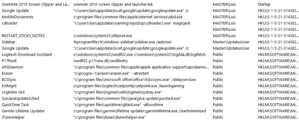

Uninstall 3rd party antivirus junk then look to Task Manager | Startup tab.

Did you also disable all the unnecessary stuff in Task Manager startup tab, as shown above?

Would uninstall LogMeIn then rid of all the unnecessary startup items seen here:
