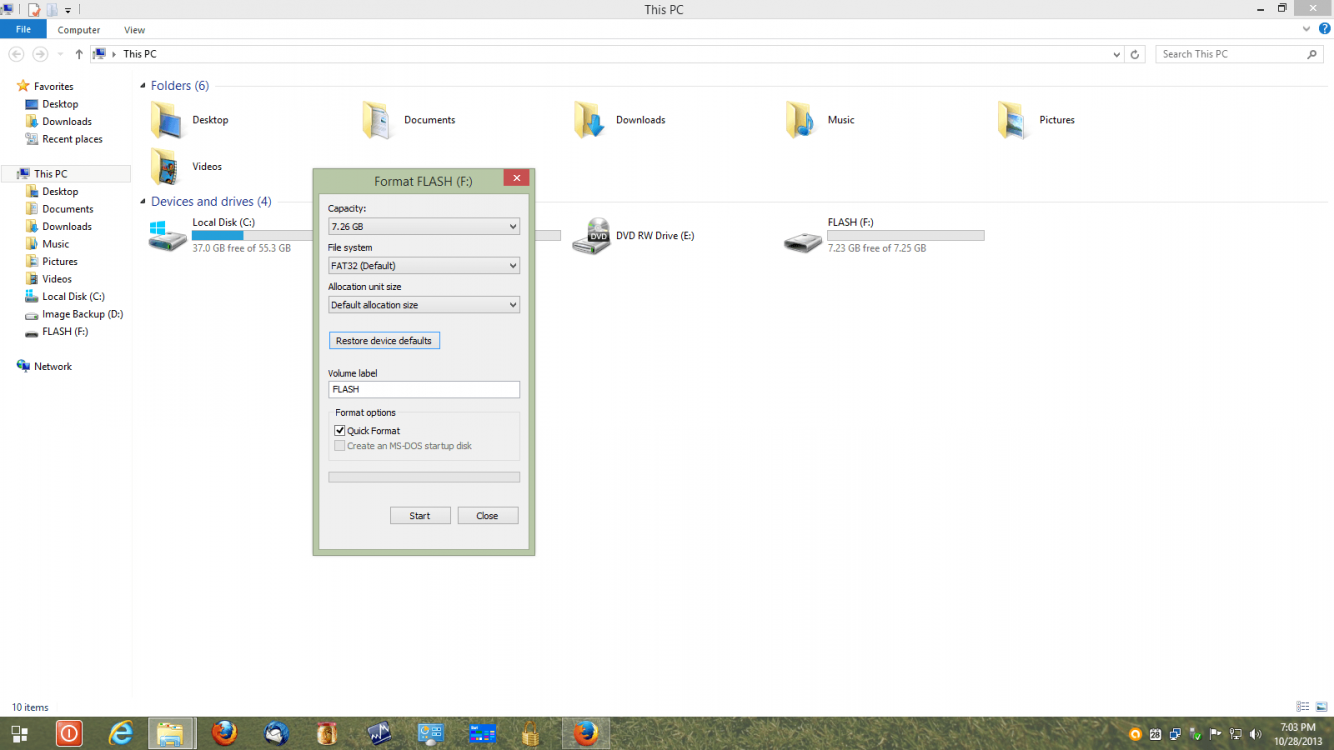

OK, can you try and format that Verbatim drive as shown by right-clicking it and selecting format:
Please select the default values and take a quick screenshot before you do it. A quick format is adequate. BTW, You do realize you will lose anything on that drive I hope.
If the answer to my last post is yes, then I can only assume you have an issue with that specific drive and I would return it for a refund or exchange. Good luck.
Yes, i have re-formatted, just like you mentioned and i already did the same way before.
