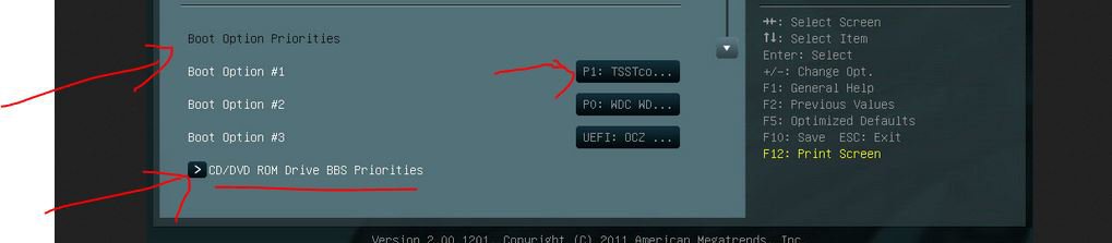

#9
Yes, primary means first.
Sure it does, buddy..
I don't have your same bios options, (mine are much easier to set) and my bios has just "Boot order" and that's it..
However, Assuming this is your bios,
- Notice there is "Boot priorities" and then" CD/DVD drive BBS priorities"
So if this is how your bios looks, it becomes quite unclear about which one you set for primary and why I mention boot order..

#10
Thanks for the response. Yes it looks to me like I have DVD as first boot and SSD and second boot priorities. It is not difficult to set and I have checked and double checked.
