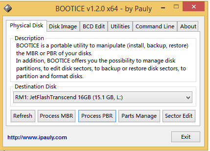

for legacy systems, I normally use a blank usb (for 8.1 i used 8gb usb3 Kingston); I format it in NTFS, copy the Bootmgr file and boot and sources folder (i don't use support tools and migration folders). I use Bootice (from within dos!, but you can use windows also) check if the bootrecord is Nt6.0 (iie it will boot bootmgr or ntldr); you can check with ipauly.com or
Booooooooting ? View topic - [ BOOTICE: A poweful boot-related utility ] - v1.2.0.1

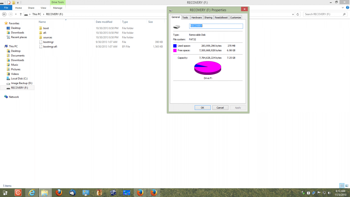

Here's an snapshot of the actual recovery drive created by Windows 8.1:
BTW, The above was automatically formatted/created on one of my Legacy installations.

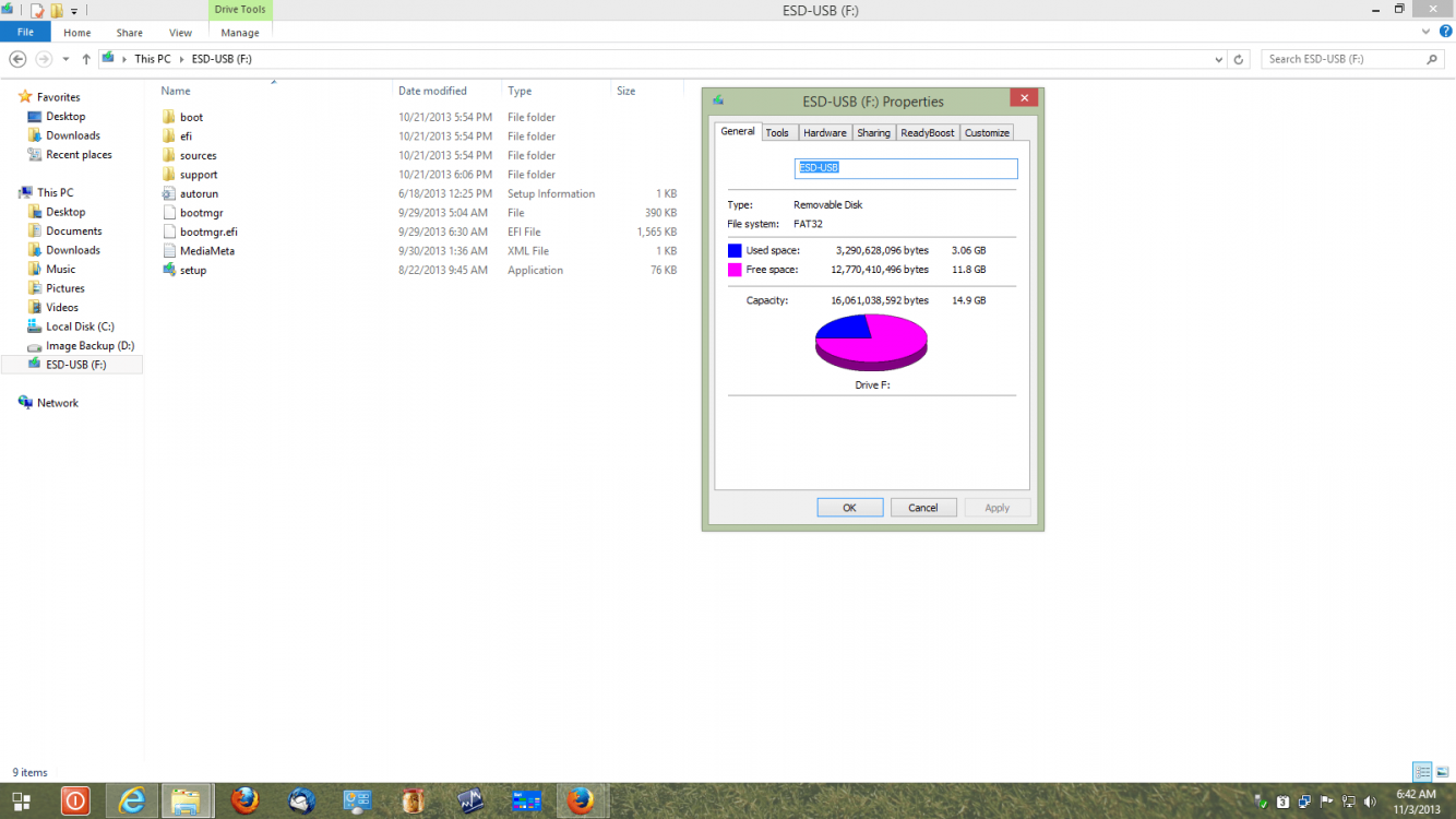

One more thing. Hre is my Windows 8.1 installation setup (on a USB drive) for Legacy or UEFI installations:

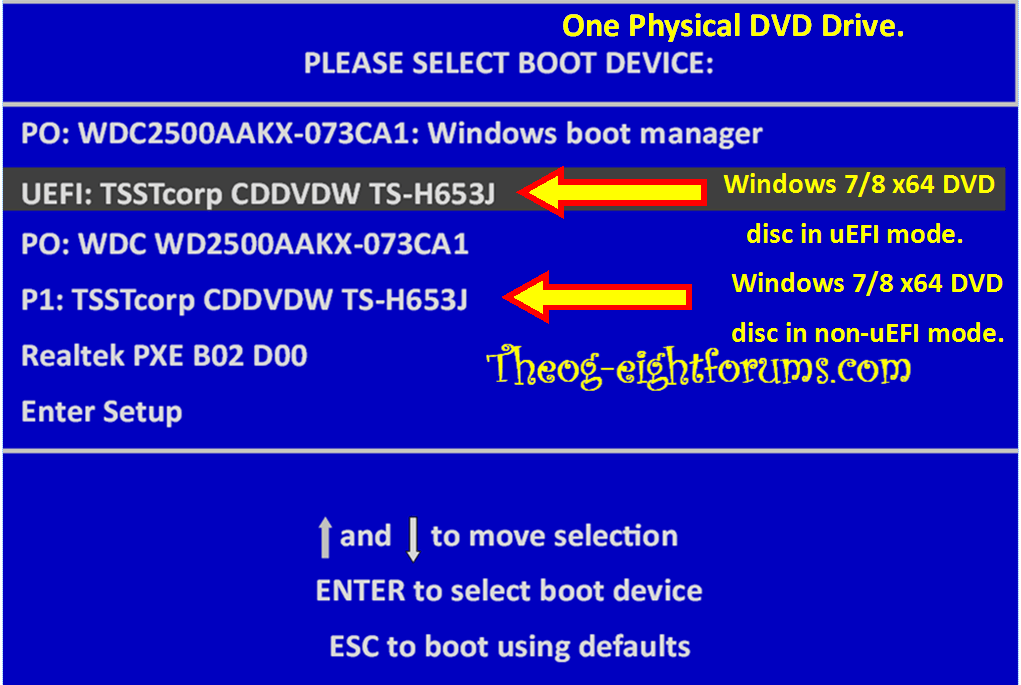

Boot the DVD/USB in UEFI mode.
If installing Windows 8x64, no need to turn Secure Boot OFF.

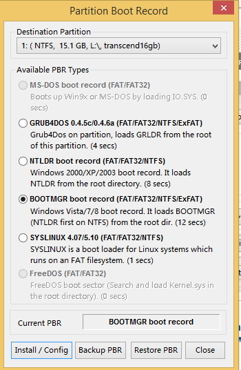

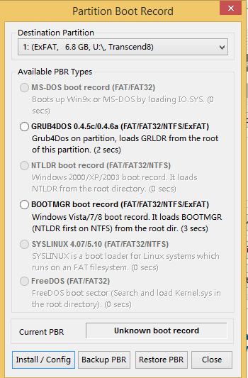

I am enclosing snipshots (using snippingtool); (aside: the 8gb has exfat - its bootpartition is coded for clover for booting mac os; so when I use this for windows I use grub4dos to invoke bootmgr from the root;)
the relevant snipshot is of 16gb usb, which has PBR for loading bootmgr or ntldr (whichever is found)
How do I access the screenshot above? Does not look familiar.

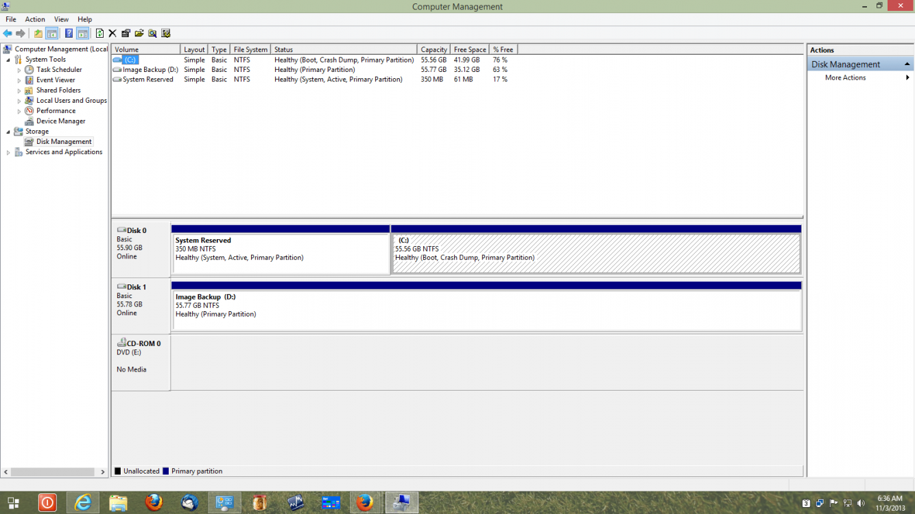

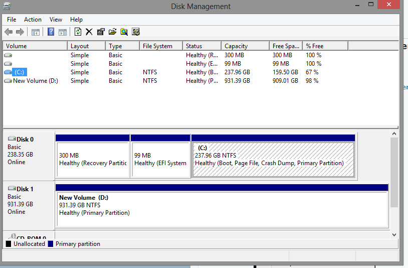

3) why don't you send the snapshots (or snippings using win 8 snipping tool) of your hdd? this will help us to advise (nay, suggest the better option to) you correctly
