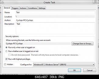

Open Task Scheduler.

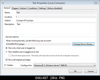

Click Create Task...
This will open the following dialogue panel, with the General tab selected. Give the task a suitable Name and Description. Also, change the other settings (if different) to match those shown below.

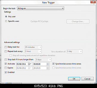

Click the Triggers tab and then click New...
Enter the settings as shown below. If you wish, you can set a start date (as shown below), but if you don't want (or need) to, just uncheck the Activate: option. Click OK.
You can set a start date and/or end date for the task if you so choose. Just check the appropriate option(s) shown below (Activate: for the start date and/or Expires: for the end date). I suggest that you set the time(s) to 00:00:00 (midnight), and that you check the option(s) Synchronize across time zones.

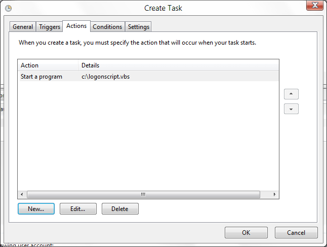

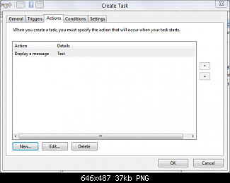

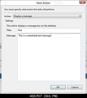

Click the Actions tab and then click New...
Enter the settings as shown below (note that you can change the message to whatever you want it to display) and click OK.
This only provides for a simple text message to be displayed for each user, with each user having the same message. If that is all you require, skip over the next section, but for more flexibility, see below.

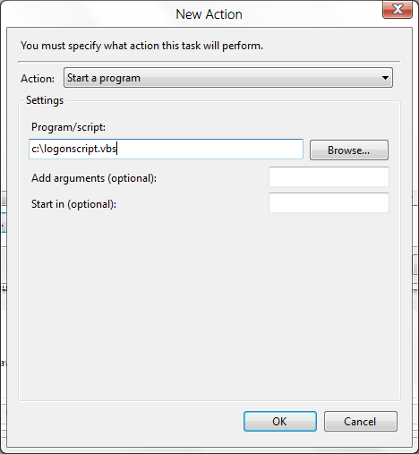

Instead of choosing Display a message for the Action:, select Start a program instead, as shown below.

All of the above blocks of code are vbscript files, and should be created using Notepad, saving with a .vbs extension. For the purposes of this Tutorial, the file is saved in the root of the C:\ drive as logonscript.vbs, although you can change the name and location if you wish. Just make sure that the name and location are updated above to reflect any changes.
Since we don't need to change any further settings, click on OK to finish creating the task and close the Task Scheduler.

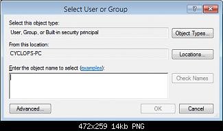

Open Task Scheduler, click Task Scheduler Library to bring up the list of tasks, highlight the one you've just created and click Properties to bring up the following dialogue.

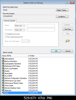

We need to change the information under When running this task, use the following user account:, so click on Change User or Group...

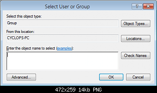

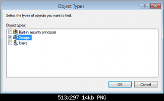

Click Object Types... and change the settings so that only Groups is selected, as shown below. (Note that this is optional, it only narrows down the list you have to look through in the next step. If you wish to omit this step, click on Advanced instead and move on to the next step.)
Click OK.

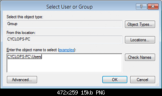

Click Advanced... and then click Find Now. This will bring up a list of items that match the search criteria. Scroll through and highlight Users as shown below.
Click OK.

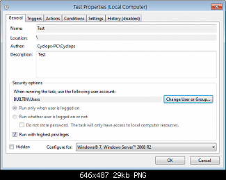

Click OK. If the next dialogue comes up as shown below, you have been successful. If not, review the above steps to ensure that you haven't missed anything.
Click OK to save the task, and close the Task Scheduler. Regardless of the user logging on, this task will execute and s/he will see the results of it on their screen in their account.
