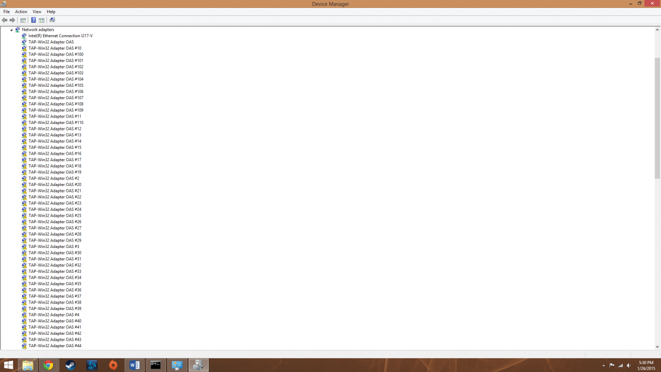

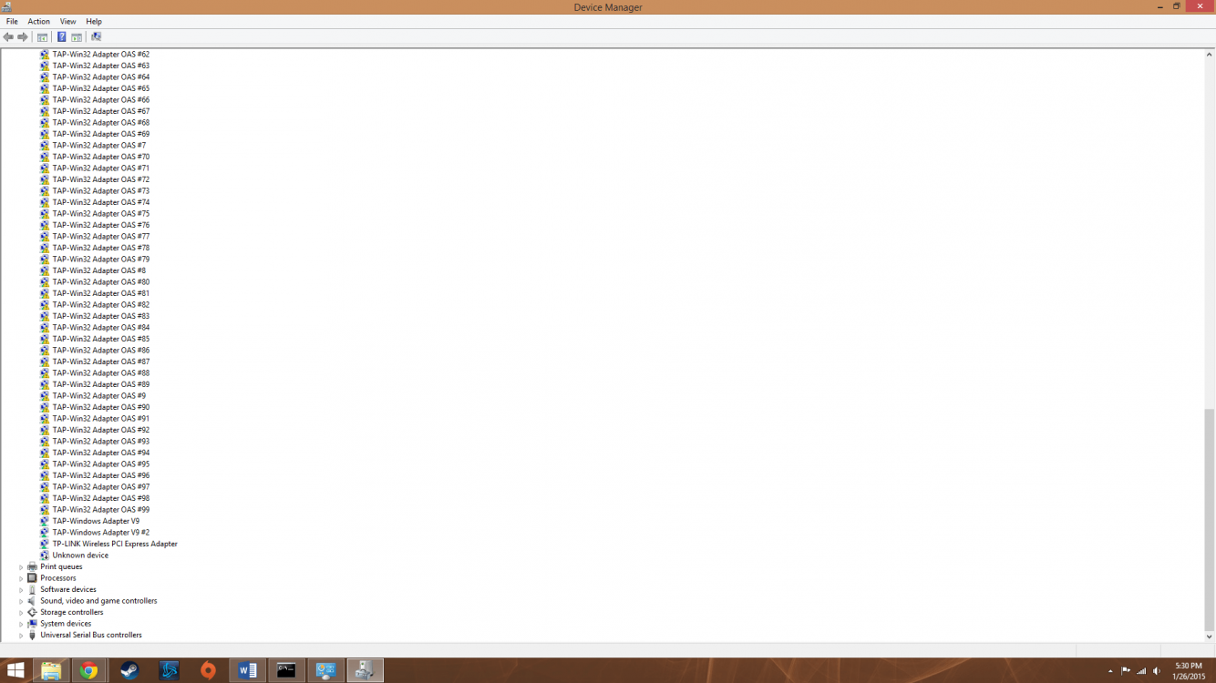

2) Internet Connectivity. The wireless pci adapter I use has slowed very slightly when connecting to Wi-Fi on startup. Under device manager -> Network Adapters there are around 100 items named "TAP-Win32 Adapter OAS #(1-100)" with a warning symbol in the icon. I have no idea what these all are but I'm worried it is not working correctly.
This may be a different issue altogether but any help would be very much appreciated.

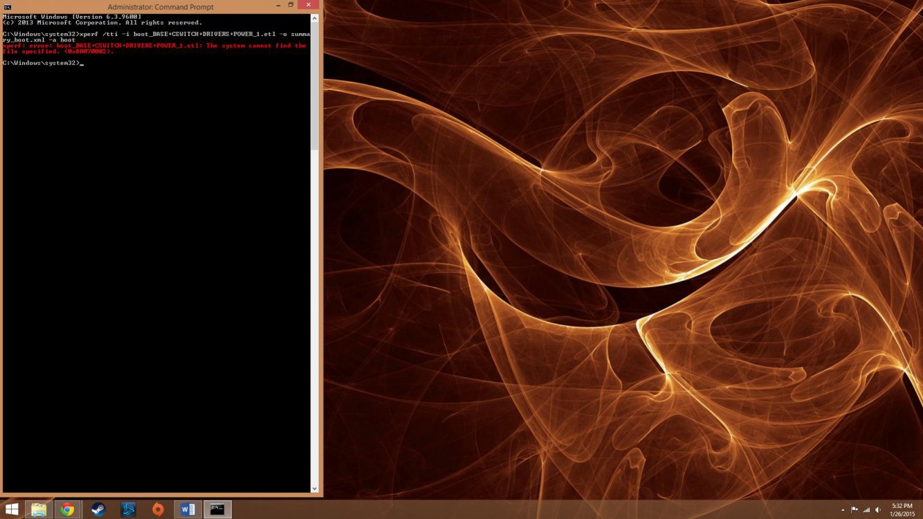

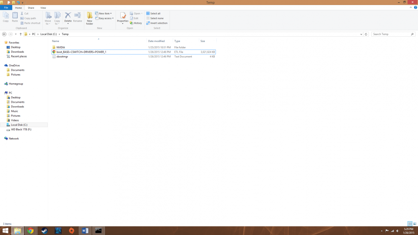

7) Tried THIS procedure
Was able to run boot tracing. File created in C:/TEMP is shown HERE
Cannot do the analyses of the boot trace. The command:
xperf /tti -i boot_BASE+CSWITCH+DRIVERS+POWER_1.etl -o summary_boot.xml -a boot
Results in THIS "xperf: error: boot_BASE+CSWITCH+DRIVERS+POWER_1.etl: The system cannot find the file specified. (0x80070002).
Not sure how to proceed…
