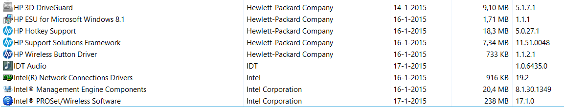

Thank you for the reply! I recently only installed windows 8.1 (had windows 7 before but I think the problem was already there). I believe all the programs that have anything to do with hp or my network adapter are in the image below:
I do not have tunngle, hamachi or any programs of that sort installed on my pc.
ok,
yes HP software.. they love to fill your computer with programs so that it looks like HP has done sooo much... and have they??
yes, they always cause issues.. i can't tell you how much trouble i've had after buying HP printers and all the software it installs.. and just to use a printer!
anyway,
I would personally get rid of these.. but do you know how to make a backup of your system BEFORE you do this??
1.make backup - ask if you don't know as there are many options to backup.. (disk clone, windows backup, system restore, etc..)
possibly uninstall these if you feel comfortable :
-Hp driveguard -
(says it parks and stops your hard drive heads.. incase you drop, well.. that sounds like just something to cause delays in using your hard drive, I mean it's up to you.. if you drop your computer it's a serious issue whether you have this or not. so don't drop it.)
-HP support solutions framework
HP Support Solutions Framework by Hewlett-Packard - Should I Remove It?
(nobody else has this installed minus HP users... you don't truly need it.)
-Intel ProSet/Wireless Software
ProSet has some additional features that are critical for some users (but not most home users).
For example, I think the Intel PRO/Wireless cards controlled by PRO/Set are one of the only non-Cisco wireless solutions that can communicate with access points secured by Cisco LEAP. (Common in corporate environments, essentially nonexistent in home networks.)
could definitely be causing your issue? uninstall
so, If you really want to see if it is just the Intel ProSet/Wireless you could just try uninstalling that only..
after that, you may need to look at your bios and see what HP has for networking in your bios.. what HP model is it and look up how to boot into bios for hp (whatever model you have) usually like pressing f2,f10,f12 as soon as your computer starts... a colored (blue usually) screen will appear with settings to change.. but don't change any of them until you Know what they do/are.
-you probably can remove the HP ESU for windows 8 also.. I think HP has a specific software that check for hp updates and you would just use that, not the HP ESU software.. so i think your safe to uninstall that too..
put your model in here. and look at what is available for your computer.. or just tell me the model number and i can tell you what and "why" i think you should use any programs if any hp has.. ha.
