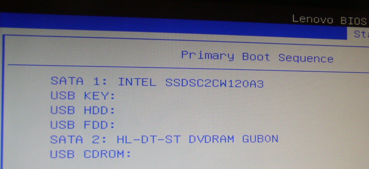

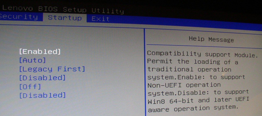

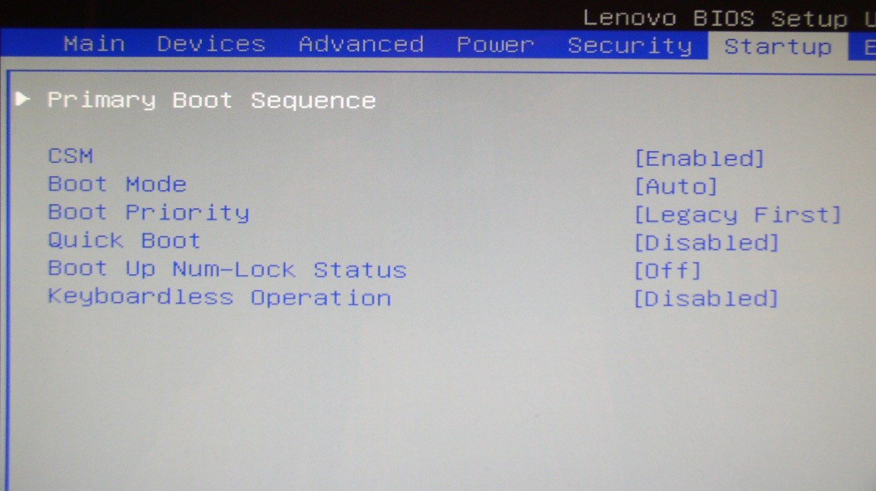

Can you share your BIOS settings - presuming you are running W8
Not using UEFI.

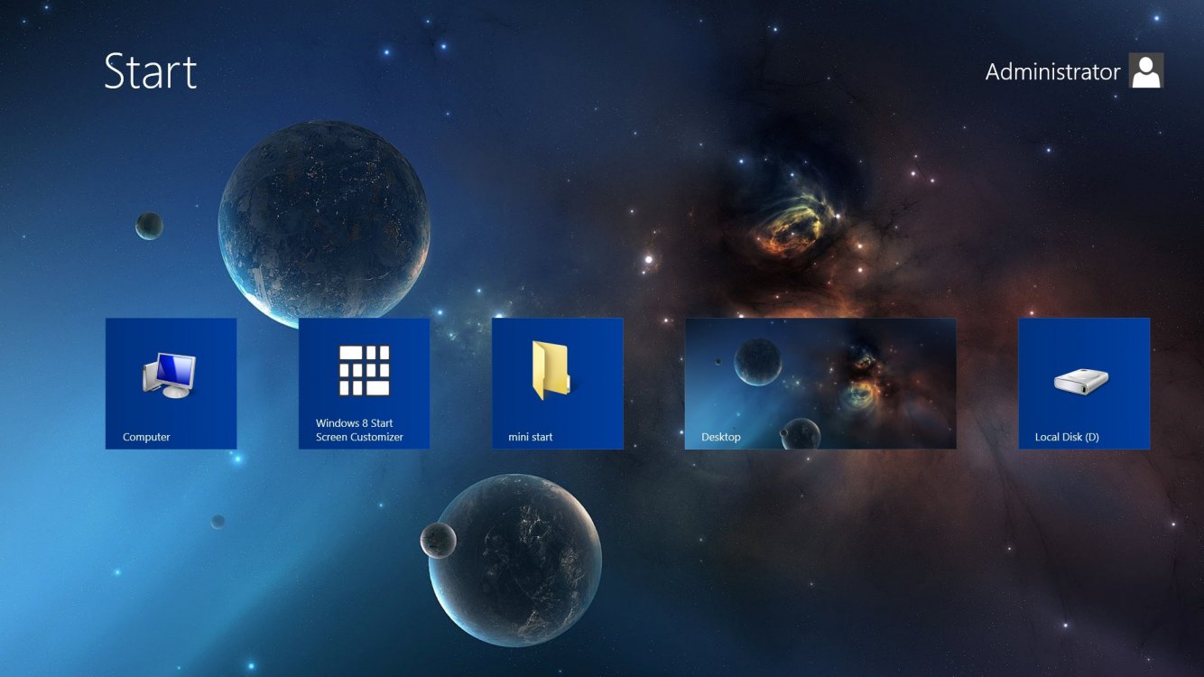

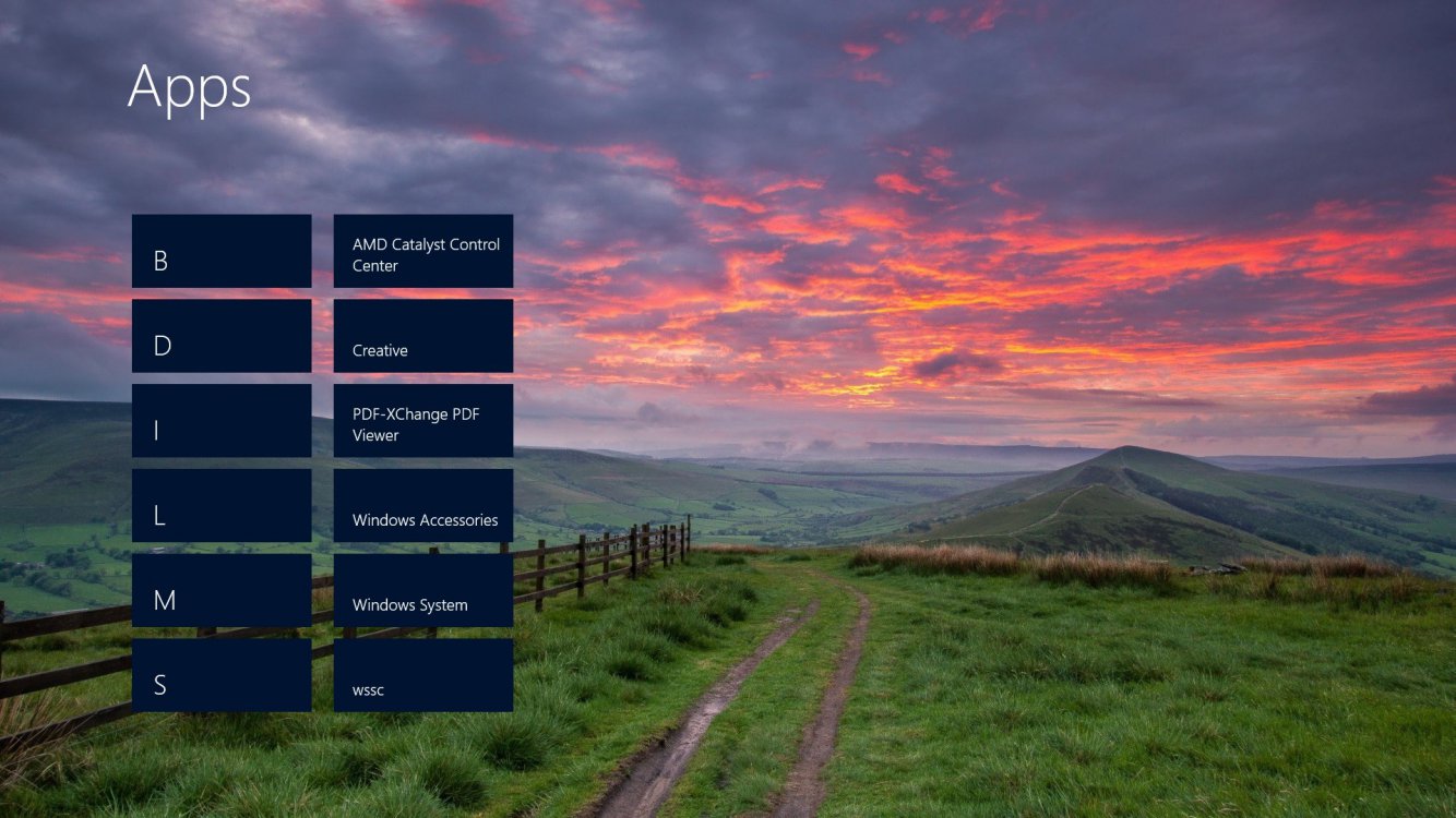

I cannot get 10 or 8.1.1 to look like these...
