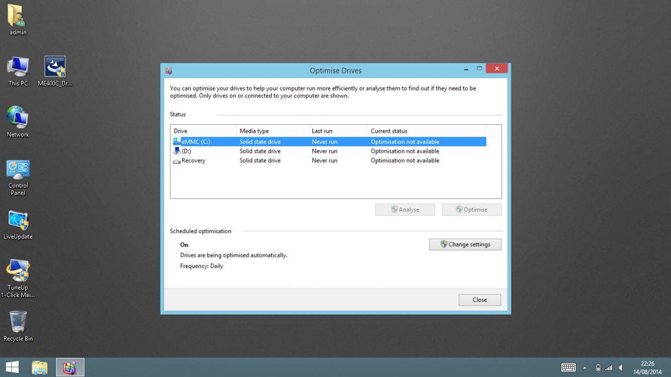

I was unable to use the disk optimisation tool in windows ..
Optimisation not Available
this was on all drives and partitions
I have performed a clean install of 8.1 update 1, installed latest bios and drivers from asus and am still unable to perform optimisation ?
Am I doing something wrong here guys or am I missing something ?
I have been searching online for hours and have found no real answer of why its not available .
Should it be available or not ? Lol
Thanks Hopefully ☺

Yep tried that.... No changes..
Then I try
ran cmd
defrag C: /O
And it tells me that the hardware is not supported ...
"The operation requested is not supported by the hardware backing the volume. (0x8900002A)"
I have googled this error code and a user has had the problem where he deleted partitions but didn't format before installing the new OS...
Just wondering if I fully format and retry install might help.
Another user has also pointed out that his emmc is Samsung and he is able to use optimisation?
Would be interesting to see how many variants of emmc there are in these tablets and whether they can utilize optimisation or not ?
Please point all owners here if possible .
Thanks

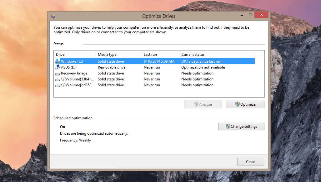

My ME400C also the Samsung EMMC MCG8GR
I attached my Screenshot
Did you Delete your Recovery Partition ?

I think something went wrong with your Clean Install. I know it would be a hassle but you just might have to redo your install to correct this problem. A friend of mine also has a ME400C and hers work with the Disk Optimization also.
Or Sandisk does Not Support Trim
Hmmm is hers a Samsung drive too ? I wonder ...
