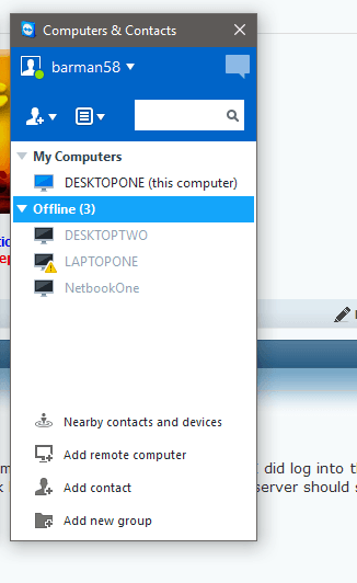

By "Plex" System I just meant the System that you are or intend to run Plex on - sorry for any confusion. Teamviewer has a side bar that actually shows which devices are in your groups and which are available, you can set this up to either group things together and / or which are On-line /Off-line
The basic teamviewer setup assumes that all devices are connected to the internet to allow access from anywhere worldwide, In cases where the devices are in the same location the LAN option makes use of local connections rather than using the TeamViewer Servers, you can also set this local connection to be the only one you use as this can save a number of un-needed messages to and from the net

And I see any systems which are in my lists but I will only be able to access those that are switched on and running a Teamviewer session
None of the devices are switched on apart from my actual system in use others are shown in the off-line group, but would move to the available group if switched on as the all start Teamviewer with windows
