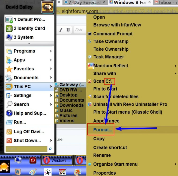

Have you tried---
that should clean it out.
But then how will I get a new install of win8 put on? I know how to format the drive but I need a way to re install 8.
