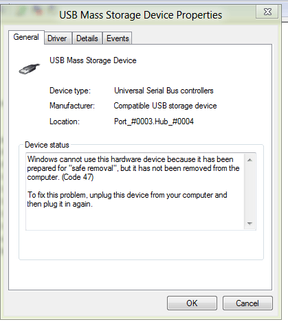

Strange turn of events. I managed to locate a number on the card reader and it indicated a linksys. Went to the linksys site and according to the serial number, I could not update it beyond XP. Had the original acer which I put in. It is working intermittently. Hardware ID indicates USB\VID_058F&PID_9360&REV_0100 AND USB\VID_058F&PID_9360. Device Manager identifies it as a Mass Storage Device. Driver detail is C:\Windows\system32\drivers\USBSTOR.SYS.
When I put a USB stick in it recognizes it and pops a what do you want to do along with the taskbar icon. On rare occassions when I insert a compact flash or an SD card it pops up the what do you want to do and the taskbar icon. When going to the taskbar icon, whereas on the USB stick it has the proper name of the device, on the others it has under mass storage and greyed out the names of the compact flash or the SD chip. Most of the time though I get an error on either of these in the Device Manager under the Mass Storage Unit that:
Thanks for any help. I guessed that getting rid of the old linksys was an appropriate action!

No luck, the devices are currently not being read so there is no drive letter attached to them. I did an uninstall and scan hardware and the USB MASS STORAGE DEVICE is now listed as a USB COMPOSITE DEVICE with different device IDs and drivers. USB port works everytime and the others aren't being recognized but the Device Manager is not showing a fault on the USB Composite device?????
Give you any ideas? Thanks for your help!
