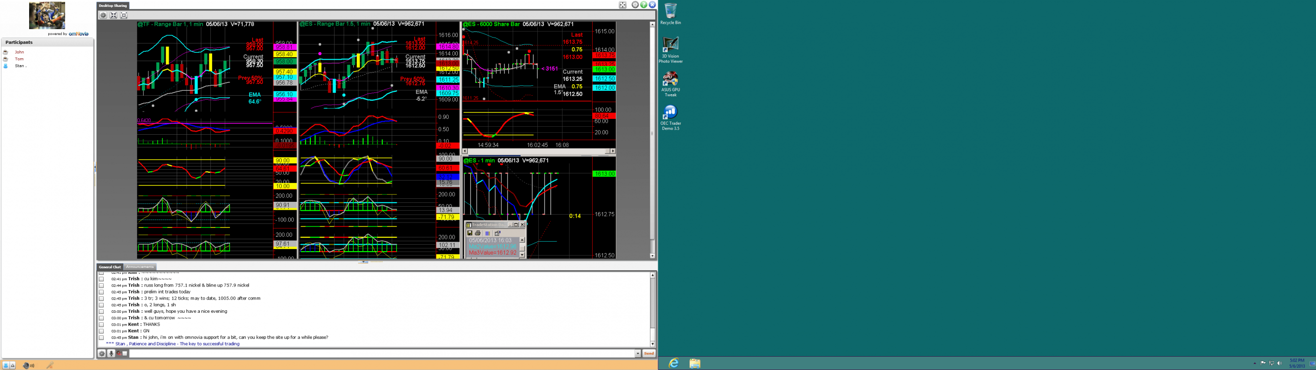

Here's a shot of the application window that I have the problem with. I believe it's a Flash Player screen. Don't ask how I got the double screens in the shot, I can't tell you (!!) Sorry it's so small, but you can see the general window. If you need to see the details, I will have to get another shot tomorrow when the site is up. I appreciate your help.
