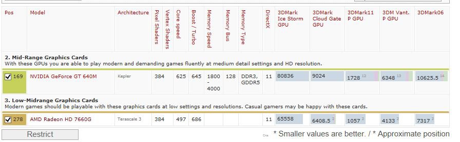

Check out this site for comparisons of video cards http://www.notebookcheck.net/Comparison-of-Laptop-Graphics-Cards.130.0.html
I didn't see the HD 7660D (but I didn't look real hard). Here is a comparison of the HD 7660M and the GT640M.
If the 7660D and 7660G are similar, then the Radeon is a better choice.
EDIT: I assumed you are looking at laptop graphics (but now re-reading your post I think you are talking about desktop cards).

Desktop - and the AMD Radeon HD 7660D is OnBoard Graphics, part of the AMD A10-5800 (ASUS FM2 Mainboard)
I did try to do a vs check but I got confusing/conflicting results - my knowledge in this area is too minimal - fast Zero
