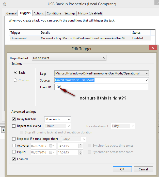

When I insert the drive it no longer triggers the task in Task Scheduler (although the script runs if I manually start it).
So not very reliable. :(

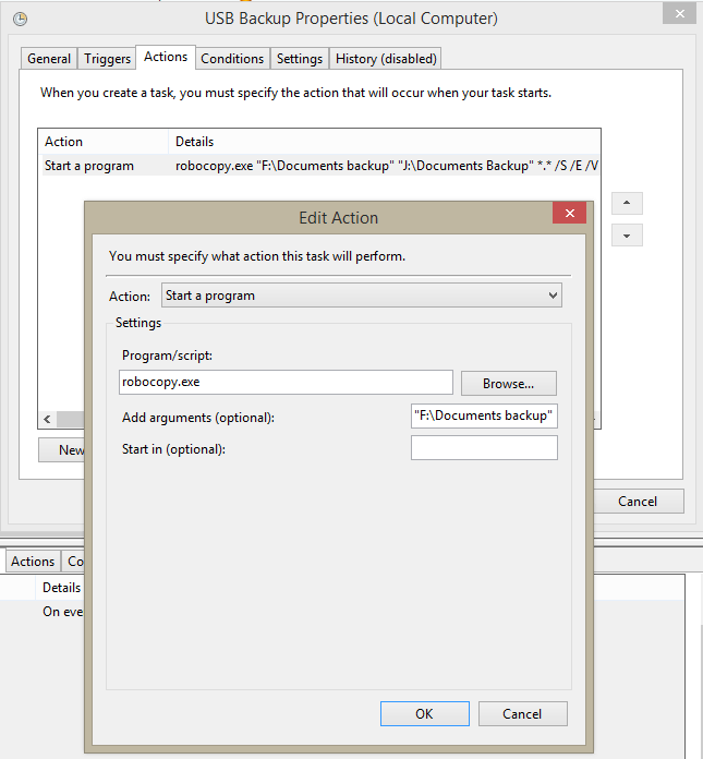

Here's what I have setup in Task Scheduler
I'm not sure if the trigger event ID is right - I got that off the very page that you sent the link for.
Although I had seen it, I did not use his script, I used robocopy in Task Scheduler instead.

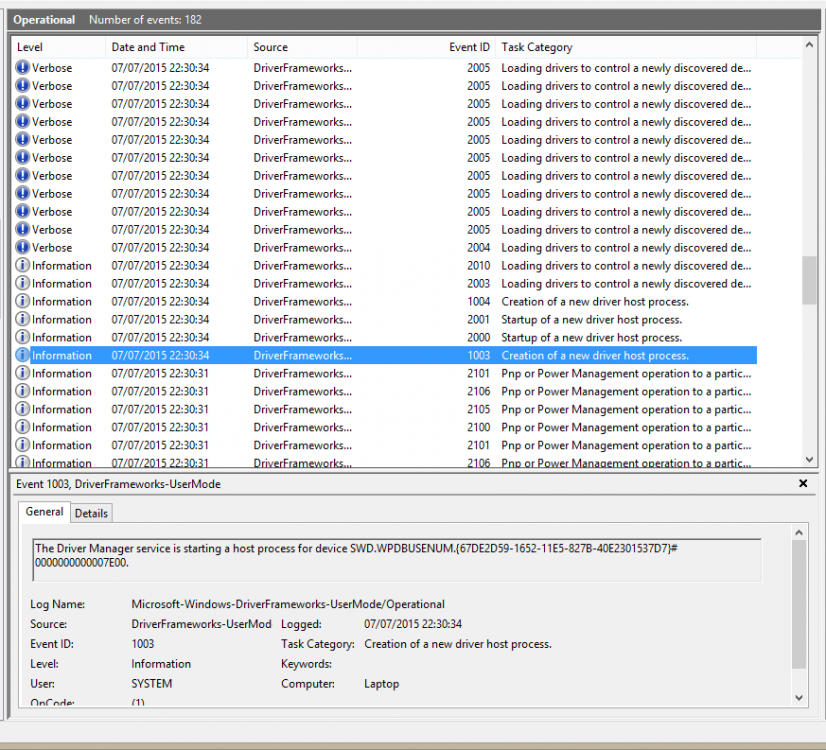

Son-of-a-gun. Like I said, i never tried this before so can't provide experienced knowledge. But I just did a quick test using 2 different USB flash drives plugging them into different ports: some on the machine and some on a USB hub
Ad hoc test showed one drive always generating the event 1003 when plugged in. But the other NEVER generated an event when plugged in!? :confused: Off hand the biggest difference between the two: one is USB 3.0 (event created) other is USB 2.0 (no event). That's just a quick test and ad hoc conclusion.
So I think you need start by checking for the event when you plug in a drive.
  • Open Event Viewer (CtlPnl->Admin Tools->Event Viewer)
  • Expand Application and Services->Microsoft->Windows->DriverFramworks-UserMode->Operational. Then you'll see all the events
  • For testing purposes, filter the log just to see if/when the 1003 event occurs. On right side of Even Viewer window, Cclick on Filter Current Log. Then per snapshot below set Logged= Last Hour, use the pull down menu set Event Sources as shown, and as shown, enter 1003. Click OK
Now plug in your USB drives. See if/when the event is generated for your case and if the result also seems drive dependant.
/* EDIT */
One thing you can do (that i didn't try) also clear the event 1003 from the filter so you see all the DriverFramework events. Mabe something else gets generated you can use besides the 1003 if a driver doesn't generate a 1003??

I have done a bit more testing and find that this method is somewhat inconsistent.
As far as the event 1003 is concerned I have found that this only seems to appear once when I insert the first of 2 different drives and does not appear when I insert the second.
I also sourced other events that occur when I insert drives and tried using those in the trigger.
They worked at first, then after a while they too stopped initiating a backup.
So a bit more investigation and research for a better solution I feel. :(
