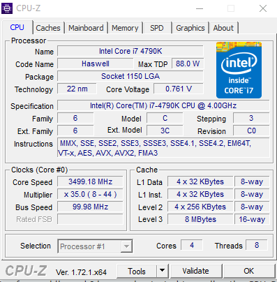

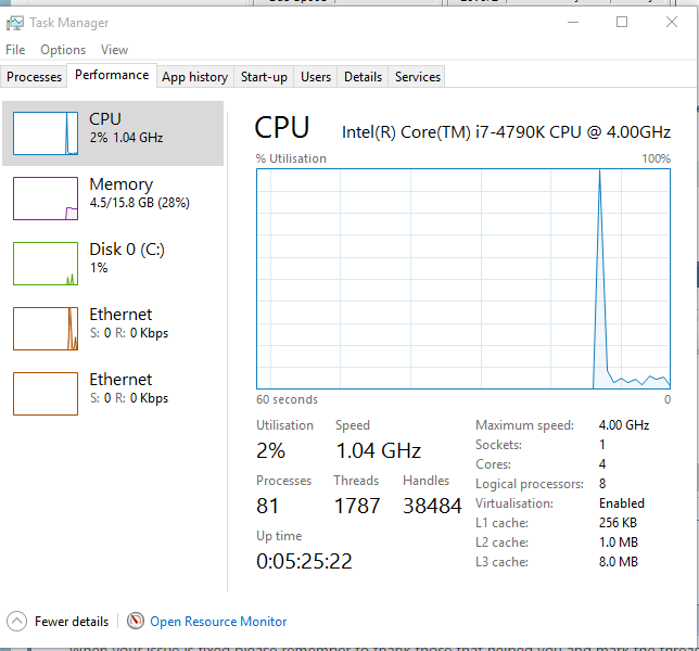

82cdc7e8dc6722fa26ddab9c6bf3af4d.pngDoes this look good?
You are only at 2% load, you have to load it much higher with something like video conversion or anything CPU intensive then check the speed.
These CPUs automatically throttle, they don't stay at max speed all the time.
