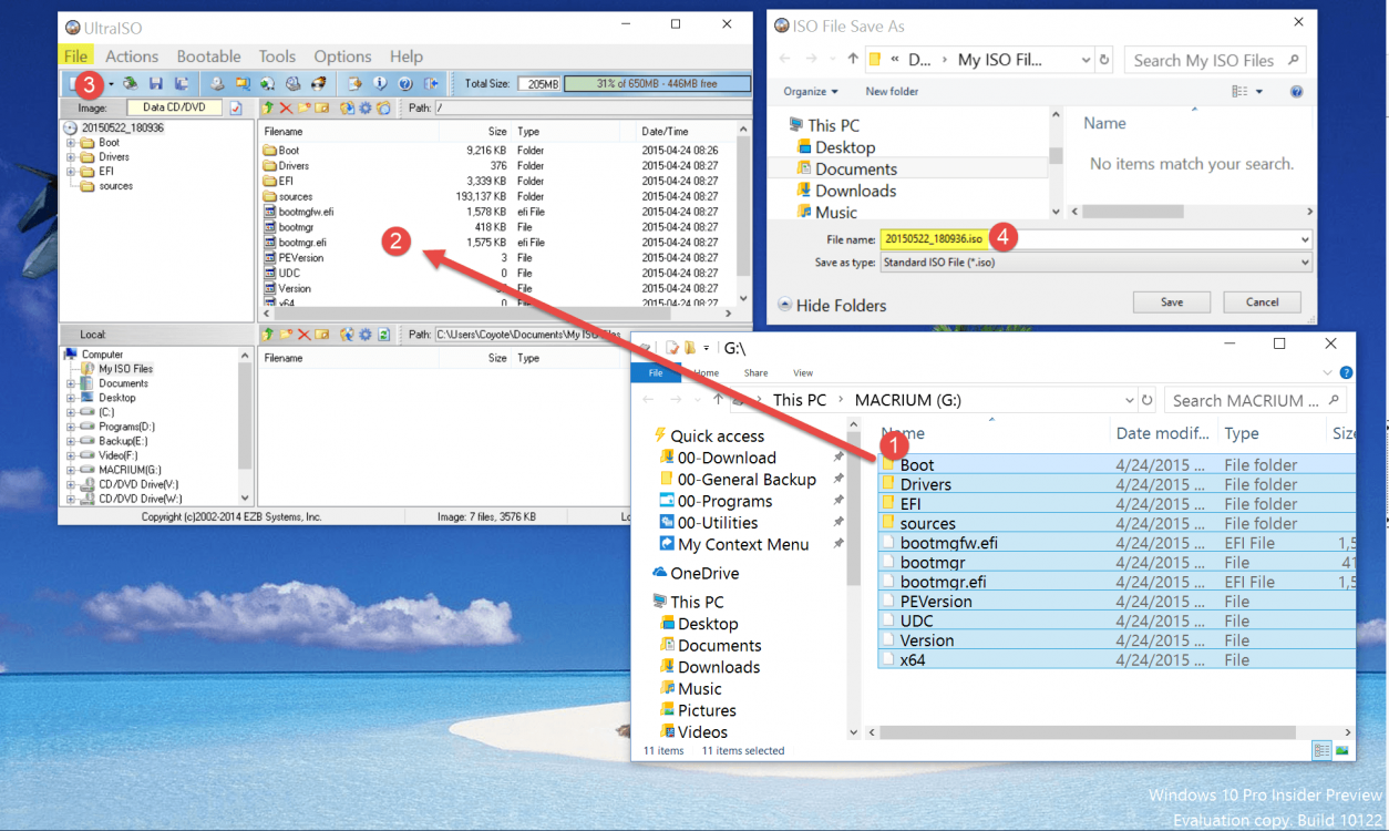

To answer what you intend to do. The easiest way to make an ISO from the USB stick:
  1. Download: PortableAppZ: UltraISO 9.6.2.3059 Multilingual
  2. Run Ultra ISO and open the USB stick with file explorer, select all, drag and drop into Ultra ISO then File->Save as ISO.
NOTE: If you can not use drag & Drop, then click on Actions->Add Directory then select the USB

If the ISO created using the procedure you describe is "burned" back to a USB flash drive (using UltraISO, Rufus, or any other app), will that USB flash drive be bootable? Will it be a clone of the original flash drive?
Iso burned back should be exactly same as it was before making it. Exact copy bit by bit, bootable if it was before.
Reason I asked is that many times when you create an ISO of a bootable media, and depending on the app used, you need to go into Advanced Options and specify to include the boot sector files, otherwise the ISO created will not be bootable, just a copy of the files.
Program I gave you link to, makes exact copy of whole content of the USB, together with BOOT sector but in .BIN format although it can burn .ISI and .IMG format. There is an option to mage only BOOT sector but I haven't tried that. Another good program is PowerISO but I don't think it's free.
