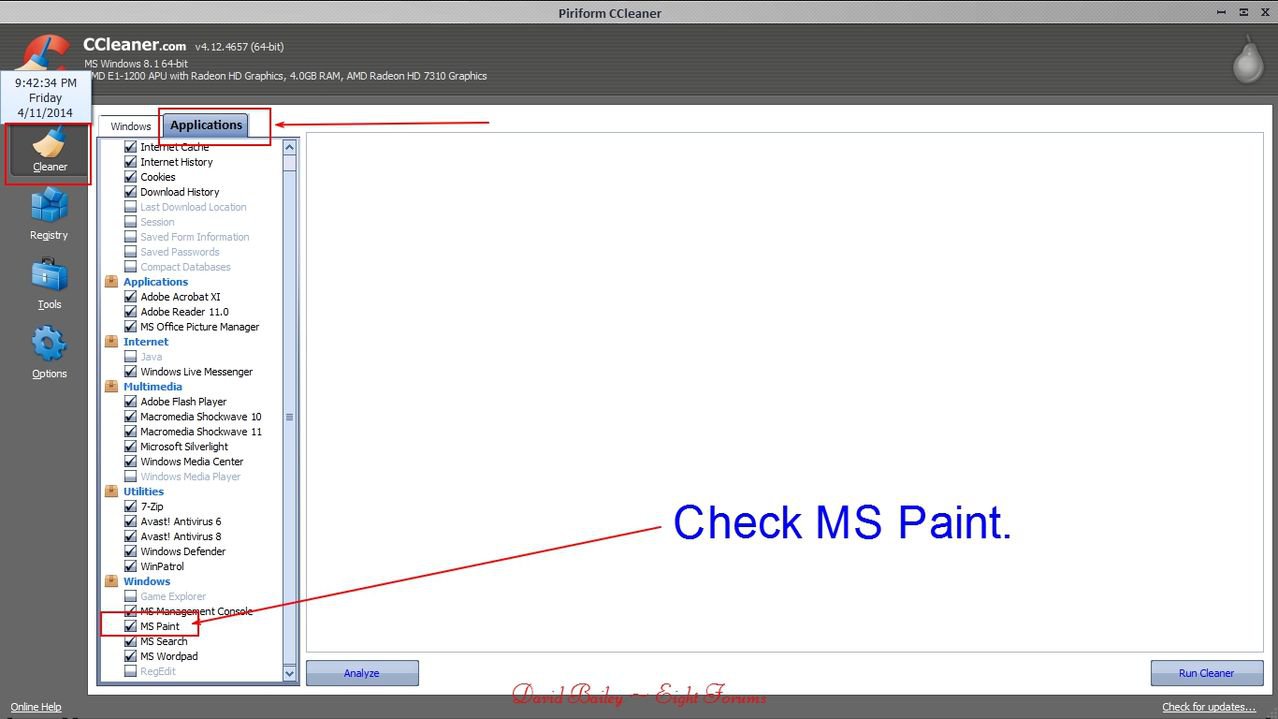

Perhaps -- Download CCleaner 4.12.4657 - FileHippo.com

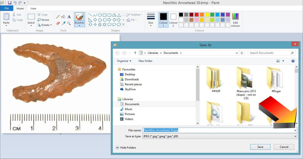

Thanks for suggestions thus far. I don’t seem to have corrupted files (apart from those .inf files mentioned above, which appear to be inconsequential).
I don’t think the problem is related to Paint as such…. More that somehow the file/save dialogue box within Paint is picking up unwanted information from somewhere. The problem is NOT with the “Recent pictures” list. I know how to delete that from the registry… but don’t need to because it’s working normally.
I have done a little experiment to demonstrate the issue. I loaded a bitmap file into Paint and then saved it as a jpg file under 30 different names, starting with “Neolithic Arrowhead 01” through to “Neolithic Arrowhead 30”.
The “Recent Images” list stores a maximum of 9 filenames and so Paint has stored the last 9 of the files I saved. Within the Paint program, only the file names are shown. The registry stores the complete path to those files, but there are still only 9 lines in the registry (I checked). Everything normal. No issues.
BUT… when I am doing the “save as” operation within Paint,if I click on the drop-down arrow (marked below), I get different information. After the experiment, 25 lines of complete file paths displayed (that seems to be the maximum).
Now, here’s the weird part…
One would expect that the 30 new files I saved would overwrite the 25 lines displayed in that drop-down box. But they don’t. The 25 lines of file paths alternate between my new files and some apparently randomly selected files from the past which have been deleted. There’s no rhyme or reason to which ones have been selected. NONE OF THOSE RANDOMLY SELECTED FILES HAVE EVER BEEN LOADED IN PAINT. The only apparent pattern is the alternation. One new file followed by an old one, then another new one followed by an old one… and so on. So what I get is a list that goes something like this:
C:\Users\Roger\Documents\Neolithic Arrowhead 30.jpg
C:\Users\Roger\Documents\Neolithic Arrowhead 29.jpg
C:\Users\Roger\Documents\Neolithic Arrowhead 28.jpg
… and so on
I just cannot figure out where the anomalous paths in this list are being picked up from, where they are being stored or how to get rid of them.

The “Recent images” list in the Paint applet has a maximum nine entries. Only the file name is displayed (although the full path is in the registry). Only files that have been loaded in the program are listed. They’re listed by the date they were accessed (most recent first) and it doesn’t matter what type of file they represent. Loading a tenth file displaces the first file listed and number nine drops off the list. All of that is normal and exactly what you would expect.
The list of files displayed when you click on the “file/save as” option in Paint and open the drop-down list doesn’t work in the same way. It works like this:
The maximum number of entries varies by file type. It’s 25maximum for jpg files and 20 maximum for other file types. Those lists are all separate (by file type) and independent. The full path where the file was originally stored is listed.
Those path lists are a combination of files downloaded via Internet Explorer (but never accessed via Paint) and files which were not downloaded via Internet Explorer (but have been accessed via Paint). Fair enough... that also happens with say Word documents downloaded from the net. They appear as file paths in the “save as” lists for Word because it’s the Word program that’s doing the saving. But why does it happen with the “save as” lists in Paint, when the Paint applet isn’t even being used?
Files from internet download (the paths to where you saved them) are not necessarily the most recently-obtained files… or even from the same internet session. I don’t know what determines which ones are listed via Paint or where that information is stored. If I look at file paths listed in Paint and search across the entire registry for the filenames, the only registry entries are for files which have actually been opened in Paint (nine of them) but none of the others.
In the case of jpg files, the order in which the paths are listed is NOT arranged by date. It seems to be arranged by a combination of date, the origin of the file (whether it’s a download or not), perhaps also the folder it was downloaded to, and what the file extension was. That is, a recent file path does not necessarily over-write an older one in the list.
I couldn’t figure out exactly what rules are being applied ,but by a series of test downloads/saves/loading into Paint (or not) I found that the list apparently doesn’t get overwritten in a logical date progression unless all other things are equal.
For example files with a jpg extension are listed by date order independently of files with a jpeg extension. By multiple saving of files via Paint, I reached a point where the list alternated between paths to jpg and jpeg files despite the fact that all the saved jpg files were more recent than the jpeg files. I then tried saving a file with a jpe extension and it appeared as number three on the list. That is, it didn’t displace the first jpg path or the first jpeg path. It displaced the second jpg from position three to position four in the list. You’re confused? So am I! So, after I had achieved this kind of (alternating) list:
