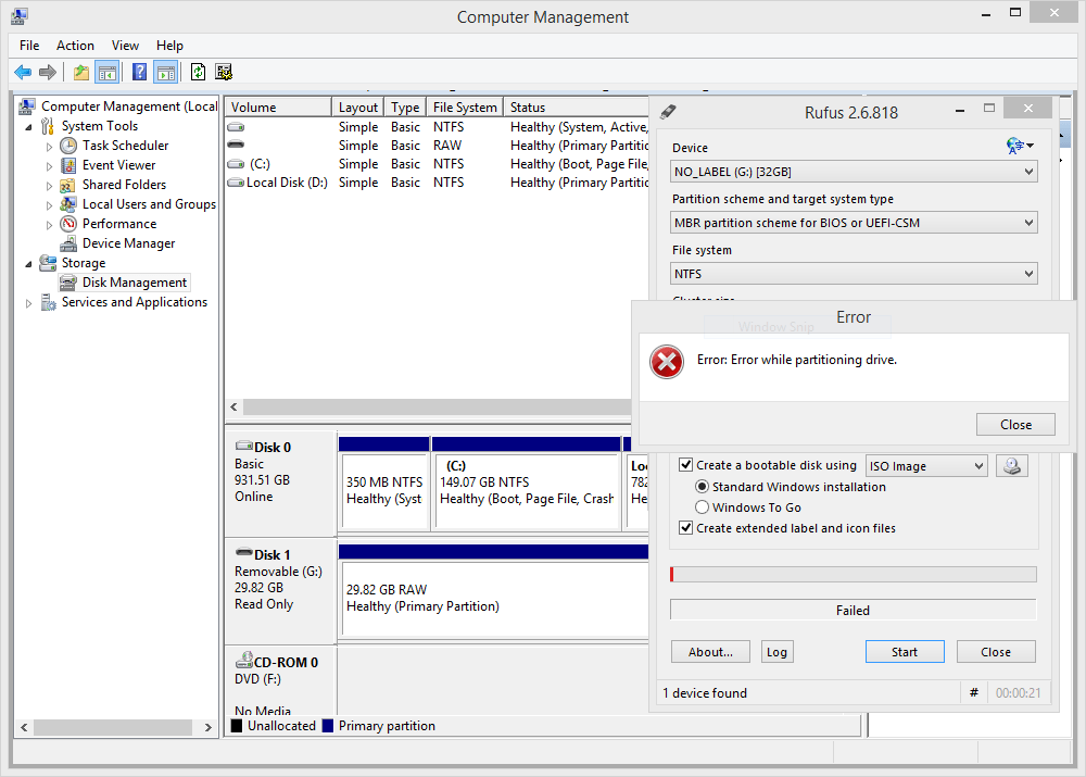

yup! and here's rufus results
my 2 usb.

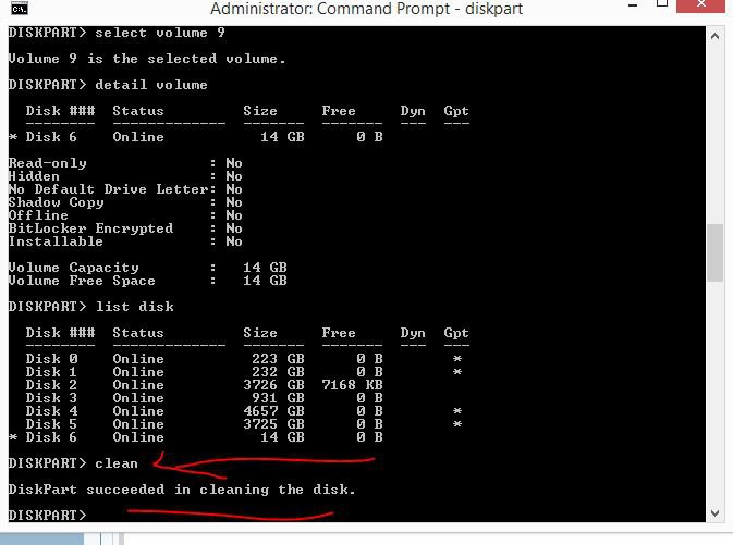

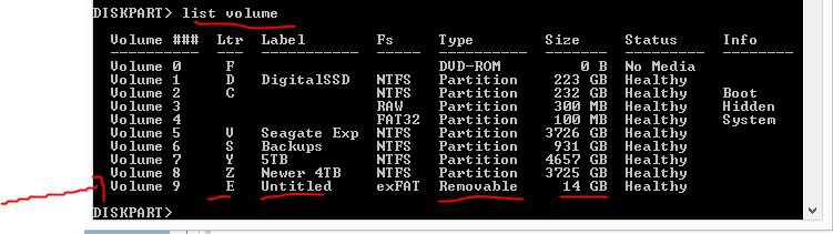

did you try this?
Open up Commmand Prompt in Admin mode.. (right click the CMD and open as Admin..)
then
1.type diskpart..
2. type List disk
3. type list volume
4. type select volume (whatever correct usb # shown)
5. type list disk (and look)
make sure you are on correct selected usb disk
6. then type clean
2.
3.
4,
If all this still doesn't work, Private message me and we will team viewer and I will personally beat the crap out of that USB for you in front of your screen either by diskpart or low-level programs..

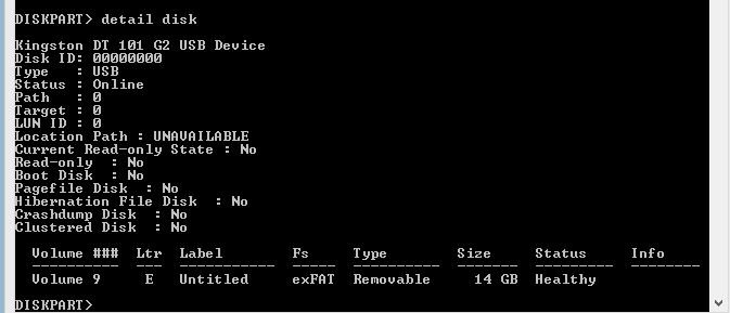

and you if you still have the read only error we will just try to run this in DiskPart again..:
Type in ATTRIBUTES DISK, and Diskpart will tell you what you want to know about your flash drive. Most important is the first line Current Read-only State: Yes. This lets us know that, indeed, the flash drive is write protected. To remove the write protection with Diskpart, type the command ATTRIBUTES DISK CLEAR READONLY. If it works, that will be confirmed by the line Disk attributes cleared successfully.
Edit**
ah sorry didn't see the second picture!

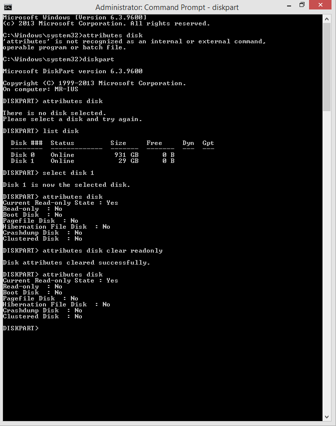

No, it doesn't have have a switch. My drive manufacturer are the following:

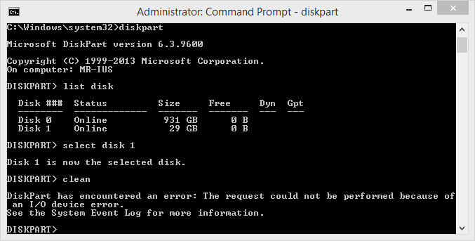

Tried https://social.technet.microsoft.co...05ee/usb-drive-read-only?forum=winserverfiles and it successfully turns to Current Read-only State: No but when formatting in disk management it says...
No other way to solve the issue? I've lost my hope w/ this 2 drive. flash drive are expensive here and I'm just a student w/o income. :cry:
Thanks a lot for following my problem.
P.S. after formatting the drive and typing the command
attrib disk
, the Current Read-only State: Yes.

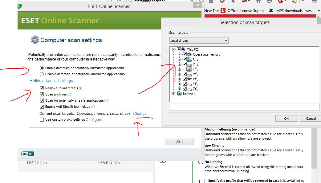

This eset is an online-only scan.. it won't ruin your system..
besides, you can even uncheck the "remove found threats" and then it won't even touch your system it will just scan and tell you what it found only..
