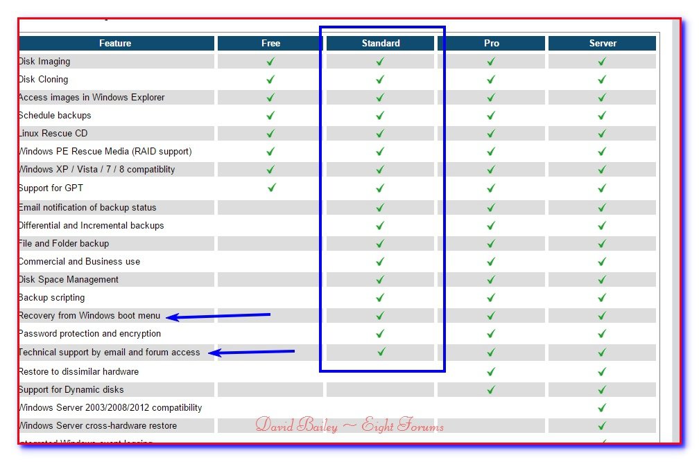

Macrium Reflect Standard version.
I was meaning to ask the feature that standard has that the free lacks. The feature comparison chart Macrium gives doesn't show the free version. I'm using Free for backups. It has WinPE 4 so I'm wondering what the clincher is to go for the standard. If I can find my license key I should be able to get the upgrade from 4.2 for $33 and change.
The clincher for me is the boot time recovery environment.

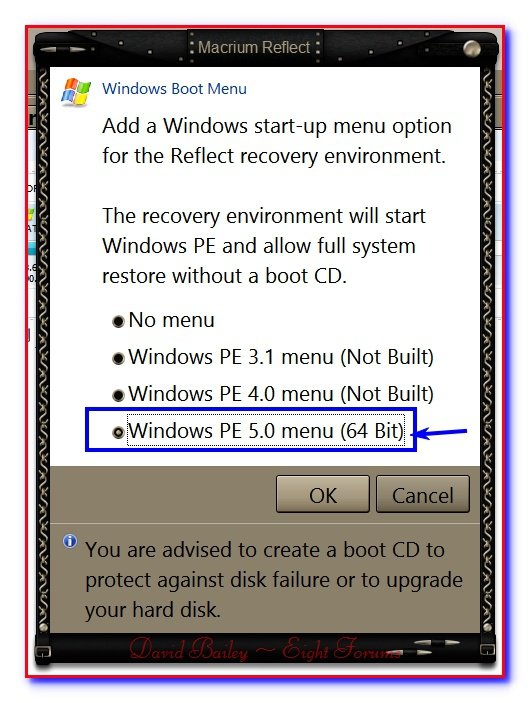

Now there is PE 5 too.
Pictures---

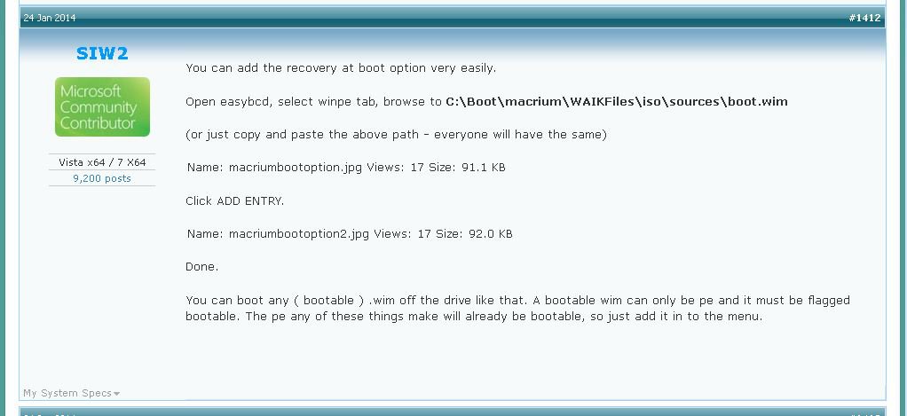

You can make pe5 easily if - if you have 8.1 installed -you already have it on your HD.
Adding a wim entry to the boot menu is simple.
About which?
If you are using 8.1 x64, you can use this
If you want to know how to add a wim entry to the boot menu, it is just a bcd entry. You can do it with commnds, but it is easier with Easybcd.

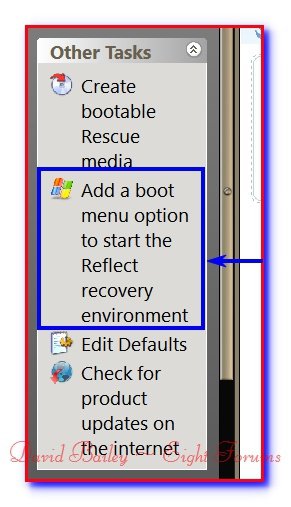

I found this post in W7 forums of yours; is it still a useful one for me to use now?
Edit: Got it and installed.
It turns out Macrium Free has PE 5 but not the options shown in the standard release.
