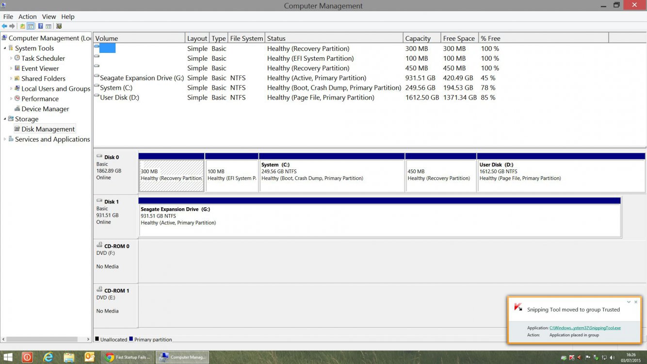

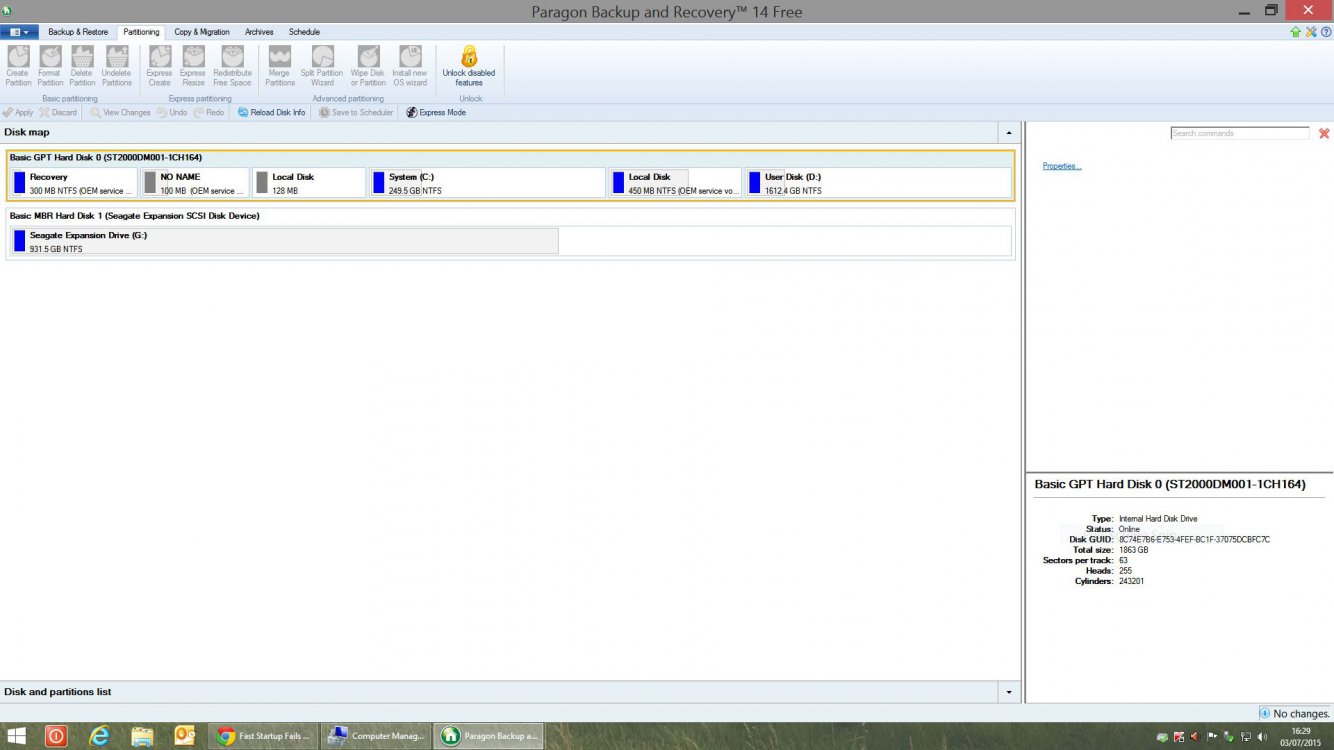

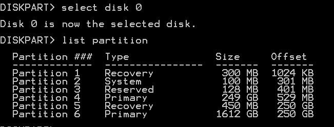

Please go ahead and post a screenshot showing the full layout in Disk Management. We'll use that to compare with your BCDEDIT to get a better idea. :)
I've enclosed files showing the disk configurations from Windows Disk Management, Paragon Backup & the DISKPART listing of Disk 0. I hope this helps.

I must admit that I'm at a loss as how your BCDEDIT got that way.

Windows 8 was originally installed for UEFI boot using the instructions on this forum. Since then the only change ha been the automatic upgrade by MS to Windows 8.1 last autumn.
A clean install would be a huge effort to reinstall all the programs. Is there no other way of sorting out the bcdedit issues? Are these issues a likely source of my problems anyway?
I'm not sure what else would straighten it out when there's that many entries to try and make heads or tails over.
