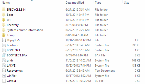

This is the inventory on the reserve disk G:

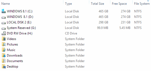

This is my system "This PC"

Well I have some good news and some weird news, lol.
For some strange reason the system booted up and it came after an update. It booted into what looked like an older version of the duel boot menu. It listed the 2 systems, But it renamed the old broken system drive letter that was presently on D: to Windows 8.1 on C:\. Then it removed the edition word PRO from the system version identification.
This weirdness doesn't stop here.
After the reboot from updating some Windows updates on the C:\ drive system and entering the older duel boot menu choices, I chose the Windows 8.1, not the pro version. It rebooted to the broken system like nothing ever happened. LOL. It was strange, but hey It started up. :thumb:
Now when it started up, it somehow renamed the D:\ hard drive to C:\WINDOWS 8.1. In other words it must still think it is on the C:\ drive because I never had the chance to change it from D:\Windows 8.1. Follow me?
Somehow when I boot into the old broken system, it is renaming the drive D:\ that it is on to C:\ and renaming my new install system from C:\ to D:\.
This must be the registry causing this because the old system thinks it's still running as a single operating system on C:\ and makes the correction being D:\ to C:\ during boot up. When it does this, it also plays games with my user account and I have to reinstate Administrative security to it and for each system as I decide on the system and boot from it.
Here is some details on the 2 systems.
New C:\ drive ( system )
User: xxxxxxx
Old C:\ drive ( original system ) that was moved to D:\ and is now booting up.
User: xxxxxxx
Please note the gap in the user name: xxxxxxx & xxxxxxx
Please note the gap in the system name of the drives C:\WINDOWS 8.1 & D:\WINDOWS 8.1
Just so your aware of how closely they are related and I didn't want to confuse you when I talked about the old or new system.
So, here is my plan at this point, since you got my system up again. First off let me say thank you very much for the CMD info you posted and for making it a direct and quick repair to get it working again. I appreciate that you took the time to help me out.
Now, since the broken system is accessible now...I need to start moving some important programs over to the newer install disk and format the old system disk before I get stupid and forget which system I am using. As it is now, each time I boot to either system...it thinks that it is the default system and puts the registries into a workout. I definitely do not want either system to make a mistake and cross the user name or hard drive name during a boot up and be back at square one. So, I guess I better get this taken care of soon.
Just FYI, when the broken system booted... I had to re-activate windows and reinstate my user name. Then when I returned back to the new system, I again had to reinstate my user. Strangely I did not have to enter my password. So, as you can see things are not acting as they should when the old system boots up and it wants to make changes that I don't want to allow.
The bottom line is, it's working and as long as I am careful during the move, It should be AOK. Do you have any references to programs that make transfers for programs and stuff to a new install system? it would be helpful to have something like this instead of reinstalling and re-entering passwords, ect ect.
Once Again, Thank You for your time. :thumbsup: You did good!!!
