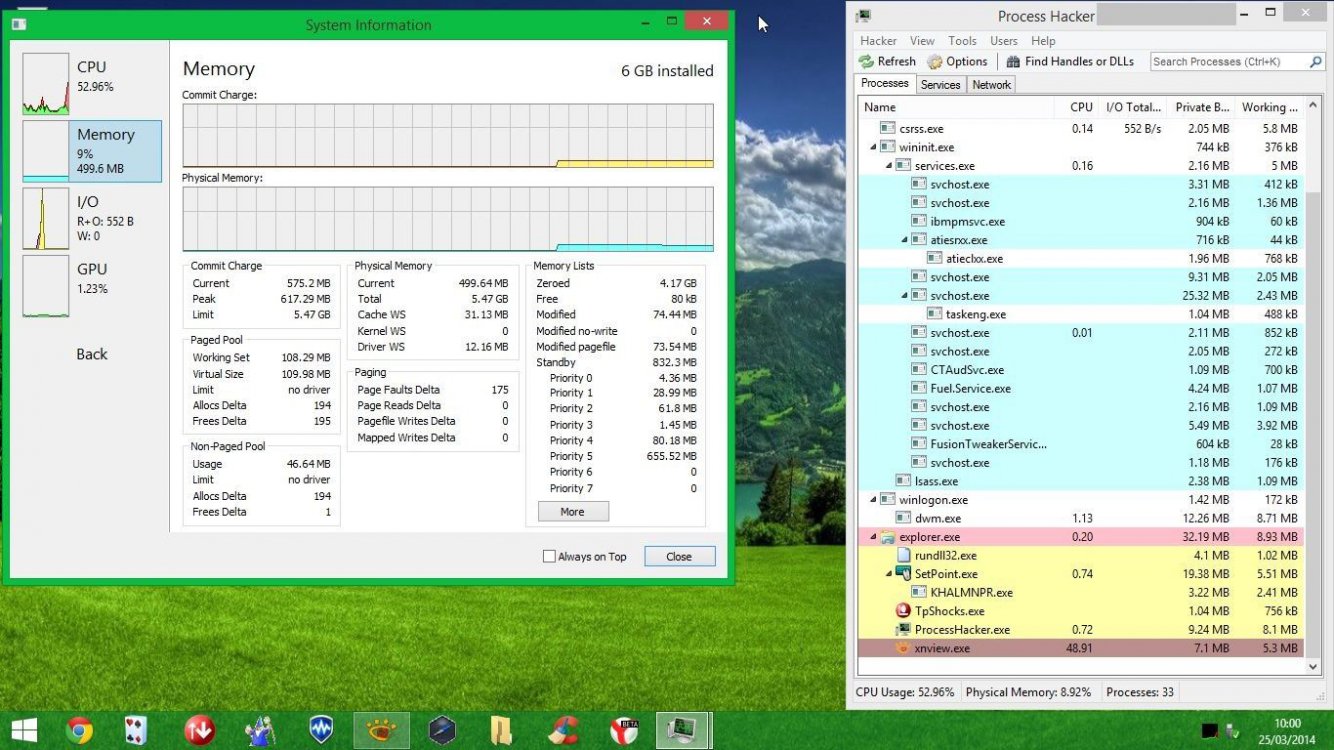

It really depends on a user, an amount of RAM and of course running applications, like Adobe or games. I am quite happy with my setup, Windows takes only 500MB RAM, basic commit limit is about 600MB, max 3GB.
